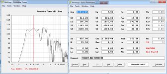

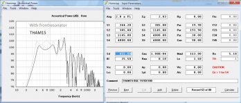

If you really want to increase the output of a tapped horn you should add a front-resonator instead of a flared hornsection.
This is the THAM15 coupled to a large front-resonator:
This is the idea we use in our new ROAR-series of bass horns.

In the same way you can add a ported chamber to the front of a bassreflex box and get a 6th order seriestuned bandpass, you can add a quarter-wave resonator to the front of a tapped horn, tapped pipe, sealed box or bassreflex box.
There are more pictures of my ROAR12 build on Martinssons blog (link in my last post).
If you add a front-resonator to the THAM15, the resonator can be detachable and hinged in the corners and foldable for transport. It is just a huge duct with a large cross-section and the right length to create a quarter wave resonance centered at the dip in the midbass respons of the THAM.
The quarterwave resonator has a wide enough resonant bandwidth to increase the efficiency of the whole bandwidth of the tapped horn - and even widen it somewhat which you can see in the simulation I posted in my previous post.

Here is a better balanced version of the resonator-enhanced THAM15.
A shorter resonator with larger cross-section.
It adds 7 dB efficiency at 80 Hz, the center of the midbass "kick".
Many THs have a dip in the response in the midbass, where you usually would want a small peak to accentuate the midbass "punch" and energy.
