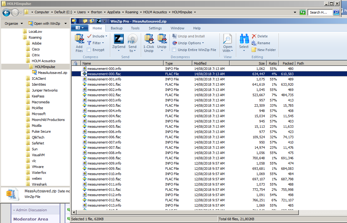

When HOLM does throw an error message during import it says something about reading restricted memory or similar. I can post a screen shot if anyone needs to see it.
HOLM will no longer even import an impulse file that it just exported. :xeye:
Unfortunately I could not get SOX working in Foobar. Don't know why, I used SOX a few years back, but no luck now. I did try as many wave formats as I could from other software; signed, unsigned, 16, 24, 32 bit, float or not, u-law and others. No luck at all.
Maybe it's time to contact the developer, even tho the website explicitly says "No Support". HOLMImpulse is such a good piece software it's a shame to see it fade away.
Pano, just had a thought, not sure if it will work but may be worth a try.
Have a look at the screen shot below. it looks like holm stores it's measurements as flacs. If you replace the flac for one of the slots (in the zip file) with a flac of the impulse you want then you may be able to "import" it that way 🙂
Just make sure to make a backup of the zip file first as corruption of the zip can cause holm to crash on startup (the way to fix that is to delete it and it will create a new one, but then you lose all the measurements that were in the zip....
Tony.
Good idea Tony! Not sure if the now not matching info file will make a difference, but worth trying.
I tried to cheat with the 3rd import tab where you import a recording and a reference. The import works, but the results are not valid.
I did try Tony's trick of replacing one of the measurement FLAC files inside the HOLM zip archive and it worked. :up: :up: Made sure that the sample rate matched the replaced measurement. All looks pretty good. The impulse file to be imported was saved in FLAC format and renamed measurement-001.flac outside of the archive. It was then just delete one file and drag the new one in.

Cool! Since that works you should be able to add in flacs (and corresponding info file) for empty slots as well, as it seems it only has files for slots that have already had measurements.
