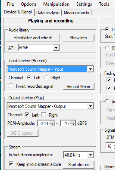

I have a couple of questions:
1. Does HOLM work with Behringer U-phoria Umc204hd ?
2. On the "Device and Setup" tab, how do you specify which input to monitor the driver terminal and which input from the mic?

I can't help with 1 as I don't know about that mic. But on point 2, I do not believe holm uses a reference signal for working out phase. Only the mic input is used and yiu can get relative phase by locking time zero.

It's all right there under the Device & Signal tab.
Which would be the input for the mic and which for the reference input? It doesn't explicitly show that. Based on what I read, HOLM only uses one input for the mic, and one output for the amp.
There is no reference input. HOLM creates and outputs a test signal, records the resulting signal from the mic and analyzes the recorded data with respect to the test signal to determine the impulse response of the system. The "system" is everything between the D/A converter and the A/D converter - amplifiers, speaker, air path, room effects, microphone etc.Which would be the input for the mic and which for the reference input? It doesn't explicitly show that. Based on what I read, HOLM only uses one input for the mic, and one output for the amp.
Correct. In that way HOLM is smart. It needs no reference input. Just a single input is all you get, all you need. HOLM, by default, removes delay and centers your impulse at time 0. You can change that or lock the time, but the default works fine for most things.
You can send more than one output, but it's all the same signal.

So I guess the impulse response is to find out the delay from the the moment the signal goes from the D/A then back to the A/D which will be used to calibrate out from the total delay to get the final minimum phase of the driver?
More than just that. The impulse response shows the round-trip time delay in the system, but it also completely characterizes the system. The frequency and phase response are obtained by taking the Fourier transform of the impulse. Because the impulse is the time-domain response, things like room reflections show up later than the primary impulse and can be masked out, at the cost of losing information about low frequencies. This allows you to measure, above a certain frequency, the anechoic system response in a non-anechoic environment. You will see that if you get HOLM working and play with it a bit.
