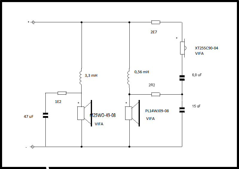

Cross over
This is the serial cross over setup with Vifa drivers.
Drivers are:
Vifa woofer P25WO
Vifa Premium midwoofer PL14WJ09
Vifa XT tweeter XT25SC90
Thanks for your replies!
