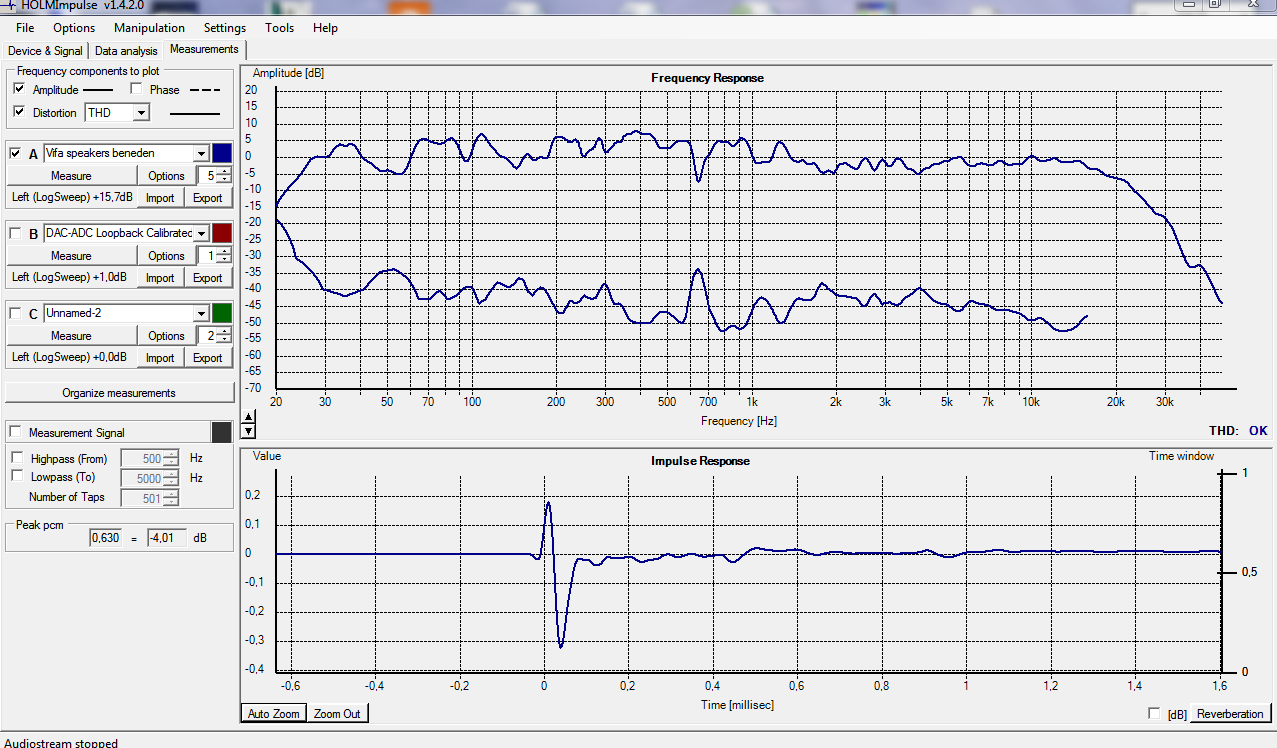

In room Holm measurements
Today i did some in house (room) Holm SPL measurements and I am not quite sure about the measurement results. I tested my main DIY Vifa speakers. The room is a small space of 4 x 6 x 2,7 meter (L x W x H) 13 x 19 x 8 feet. Frequency response smoothing N=12. Any thoughts?
