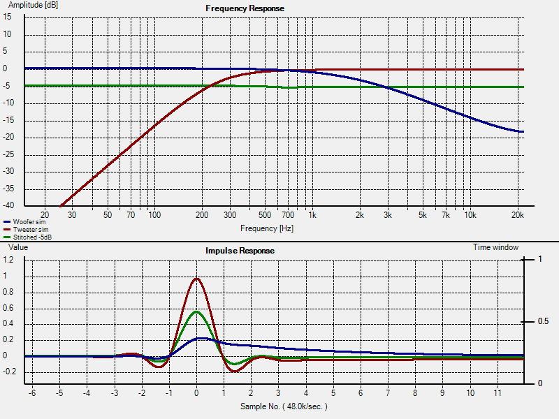

I hope this is the right place to ask. I need some basic "how to" on stitching in Holmimpulse. I assume the arrow between measurement A and B is relevant on the stitch icon, but I don;t know how to apply it. Also, it would be helpful to know how to match the decibel levels on two different measurements.

I believe that "stitch" combines two data sets into one by merging them together using the widow that comes up showing the region of the merge. Below is one data set, A and above the other B and in the middle is a merging of the data. I use this same technique quite often in my own software.
Stitch Simulated
I don't remember ever using the Stitch function, so I just gave it a try. The graph shows two log sweeps, one that is 2nd order high passed, the other 1st order low passed but not at the same frequency. Stitching was done at 700Hz. Stitch lower by 5dB so that it's visible.
I used the Match Phase option, which is default. HOLM bumps up the LP (woofer) response by 0.3dB after stitching. Maybe part of the phase match?
