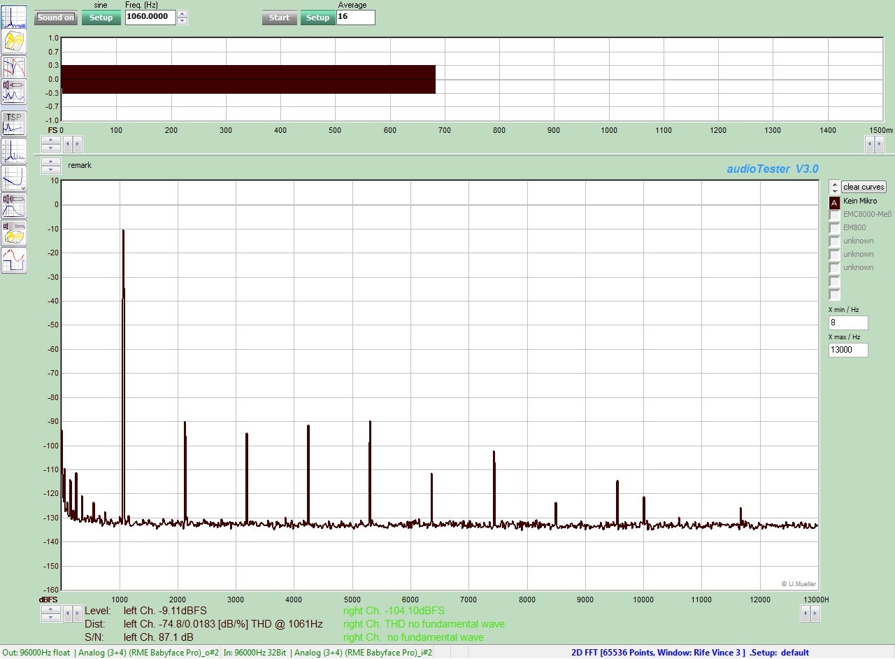

I repaired Winfrieds Holfi.
On one channel Q3 in the preamp was dead. Therefor the offset regulation was at one end leading the relays to be turned off.
I replaced D17 to a 1N4004 and added also some directly at the relay coils, on both channels.
On the second channel R27 was broken. By touching it the relays turned on, otherwise turned off.
The standby switch and the relays are ok. But the contacts of K1 are in danger due to the high switch on current when the big caps are loading the 220 uF.
The 0.22 Ohm will not help much.
Please find attached a spectrum of a 1060 Hz sine output 1 W at 8 Ohm (8 Vpp). Done with a RME Babyface pro USB interface and AudioTester SW.
It is ok for an amp without feedback.
I also added the simulation files of the amp and the standby circuit. I used the free version of Simetrix 8.3.
There is also a small simulation of the rush in current.

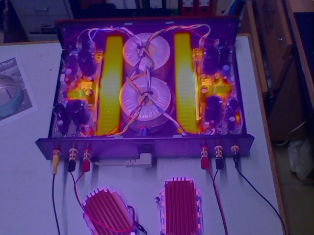

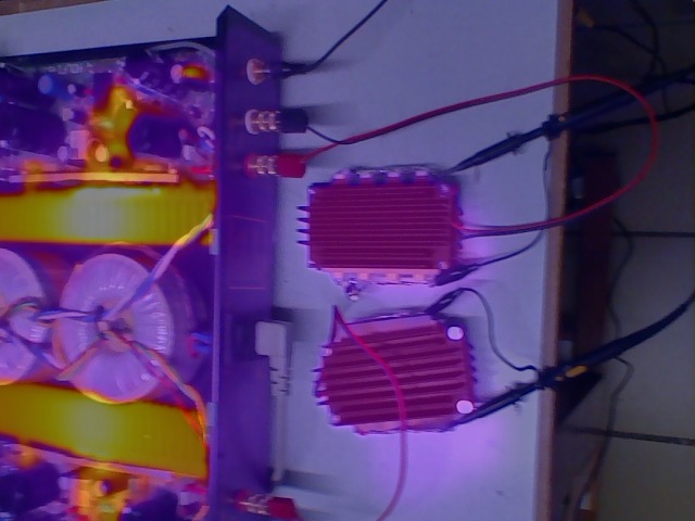

Just for fun there are two thermo pictures of the amp and the load.
