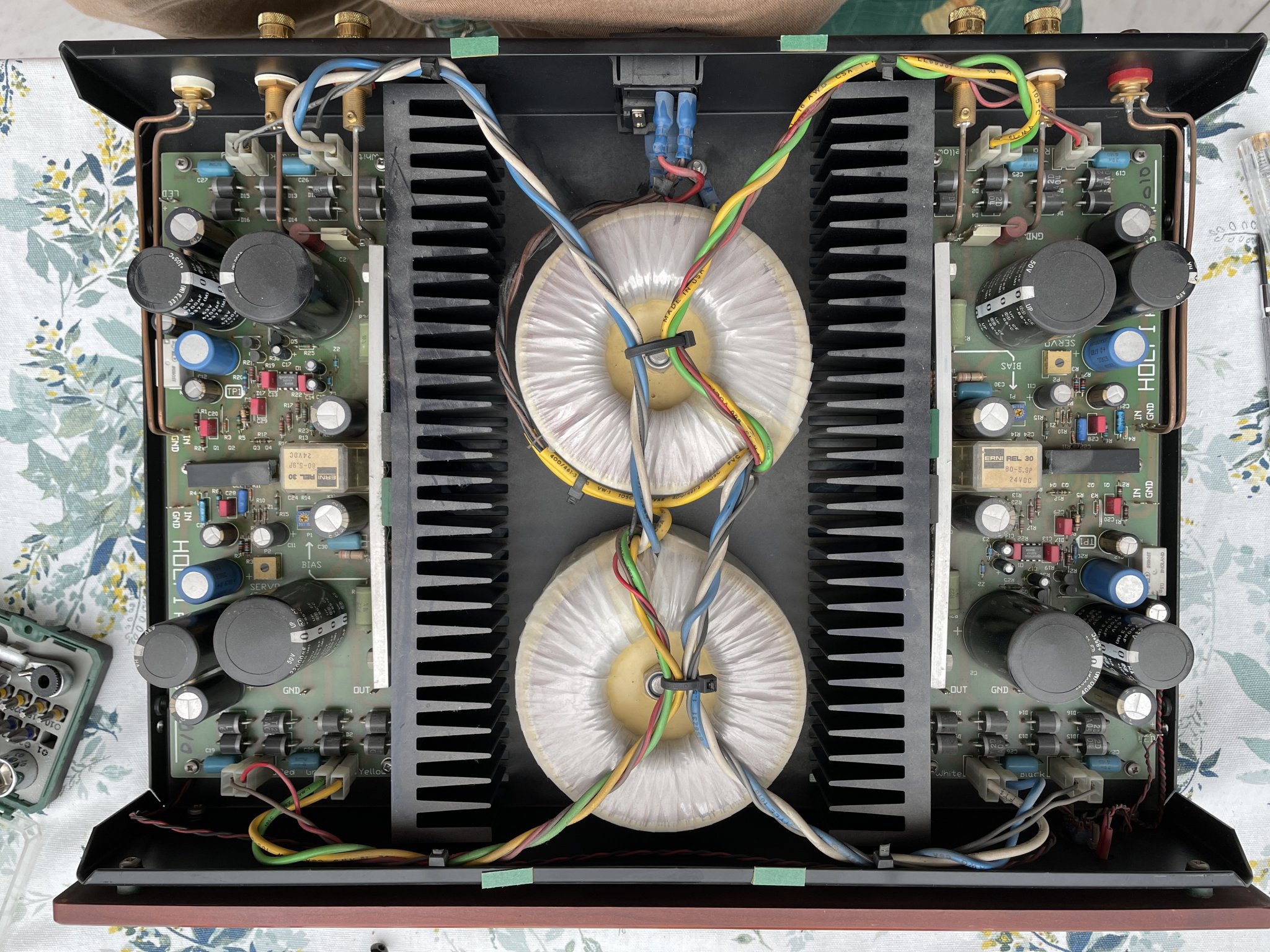

A Holfi NB3 has landed on my bench from a friend who loves this power amp. Although, one channel went "bust" and I don't have a schematic of it. What I know for sure is that NB3 is a pure double mono design having with separate transformers for each side which is an advantage here I think.
The initial visual inspection yielded a few strange things:
Two PCB screws were "travelling" around in the case and on the (failed) PCB which I fixed.
A 330Ohm Resistor in one of the four power supplies was badly burnt which I replaced.
A connection wire of the Standby Switch had somehow "unsoldered" itself from the board which I fixed, so the working side relay clicks, the failed side relay does not.
The Standby LED does not light up which I could not fix yet.
My switch-on test after reassembly showed one of the two mono-amps working OK, the other one (the failed side) showed a 26.5V DC voltage at the Speaker Output, where the working side showed ~0V. My fairly limited repair experience so far only tells me that there may be a broken Power Transistor or a failed power supply component.

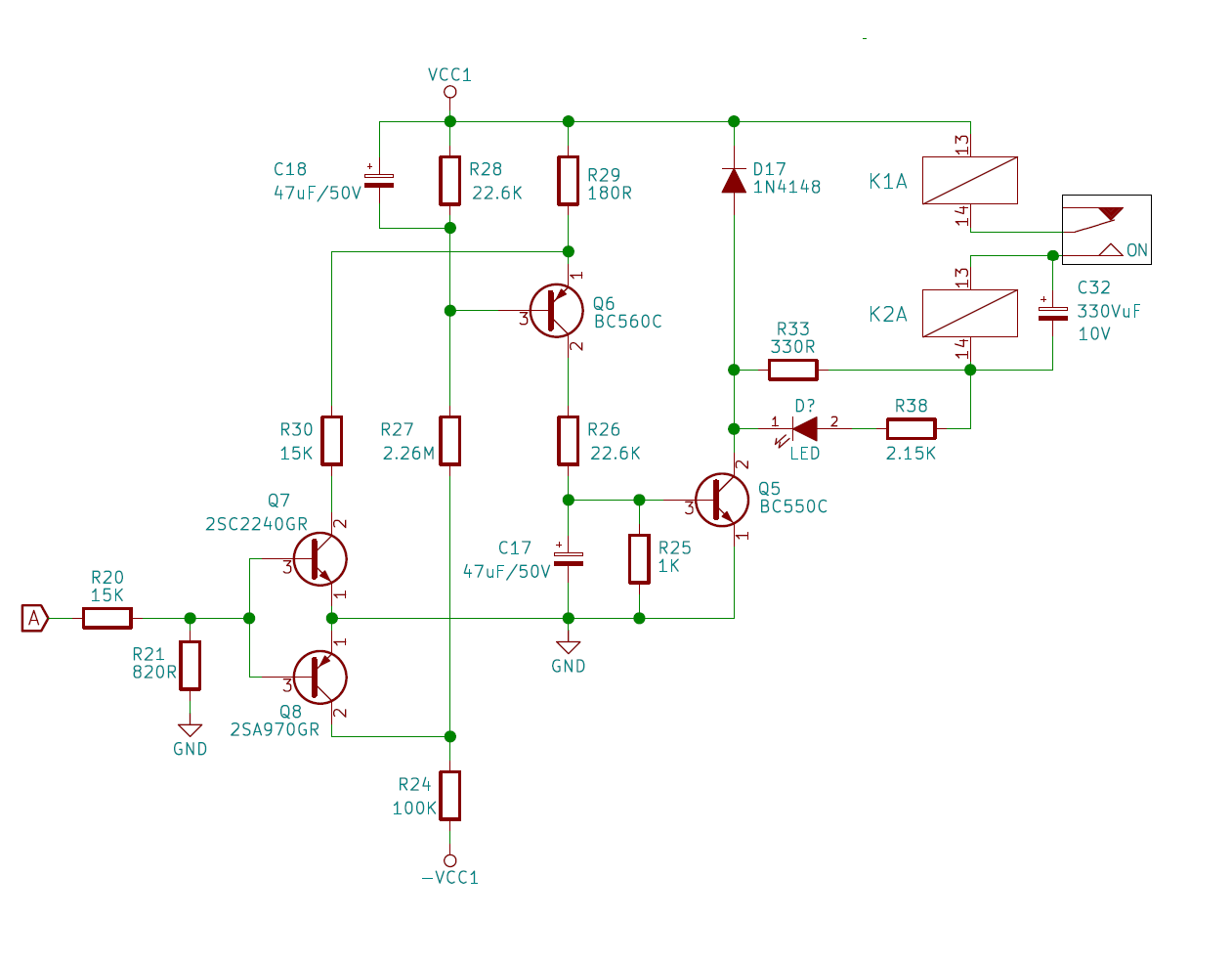

Hello Mogens,
So far as I could "easily" disassemble the PCB to view the copper side, the front panel switch disconnects (i.e. switches off) the two relay windings for "standby" mode and connects them for "on" mode which also turns the red LED off and on respectively.
See the edited picture:
Winfried
Hi again,
just looked at the PCB picture and saw that on your unit the standby/on switch connectors are bridge-soldered, so it's always "on", never on standby and the relays therefore only switch during hard on/off..
Greetings,
Winfried

Hi Winfried,
That's fine. I was just curious.
I know the relays has been re-placed in mine. I think they might be a source of fault over time. As I remember Holfi uses the relays to disconnect the voltage for the output transistors. I believe that this put some strain on the relays and the contacts go bad. Just, a thought.
Keep us updated when you have time to look at it again.
Mogens

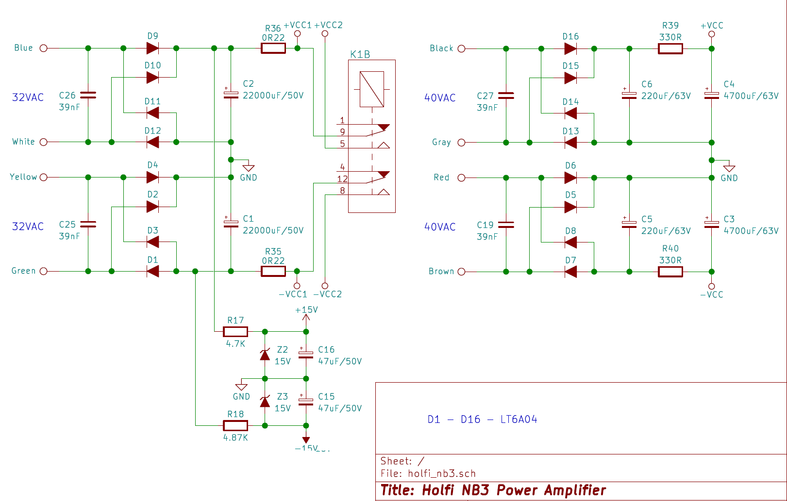

Hi Mogens,
I'm now back on the NB3 PwrAmp subject. After completely "extracting" the malfunctioning PCB from the chassis, I've done and continue to do some more measurements. When examining the Supply marked with VCC1 in your schematic, I've found two resistors missing in your NB3 schematic (for whatever reason) and wanted to bring this to attention. On the PCB they are marked R36 nd R35 with 0.22Ohms each and are in the rails for the poweramp section. The supply for the +/-15V stabilizers is connected before R36/R35 respectively. Here's a modified sketch of the Power Supply:
I'm still wrestling with the PwrAmp repair, but gain confidence to repair it eventually.
Winfried
Hi Winfried,
Thanks for the update. You are right about the resistors. I don't know why I omitted them when I drew the schematic. I suspect it was because they are not present in my amp and are just shorted with a piece of wire.
Let us know if how things are progressing.
Mogens

OK Mogens,
maybe, as a coutesy to interested readers and actual Holfi repairers, you'd like to amend your very helpful NB3 document accordingly. It's interesting to see different fitting options of the same identical board, as we have now seen with the Standby switch and the two Resistors in the Power supply.

Thanks for the acknowledgement and your interest! At this moment I feel like "O man! Let me finally find the broken part(s)!" more than to modify the unit. The proposen Mods. would mean to completely unmount the second PCB which was enough of a drag with the first one. I'll very probably rebuild the original hardware as the rigid wires are really rigid and I don't see risk there. I agree, though, that their use can be validly questioned to begin with...
Well, the Amp actually belongs to a HiFi friend wanting it back soon now. What I may still do, though, because it's so simple to measure, straight forward to implement and effective electronically: Add Snubbers to all secondary transformer windings, which may even improve sound (at least slightly 😉).

Hello friends,
the NB3 works again, just Transistor Q3 had died. Actually a hobby friend found the failed Transistor, he's a very experienced repairer (which I'm obviously not 😉 ).
Analysing the schematic it was also found out that D7 does not really work as a protection if the Standby switch is used! So 1N4001s were added (anti)parallel to each relay coil. This is a small, but actually a strongly recommended modification for all NB3s!
