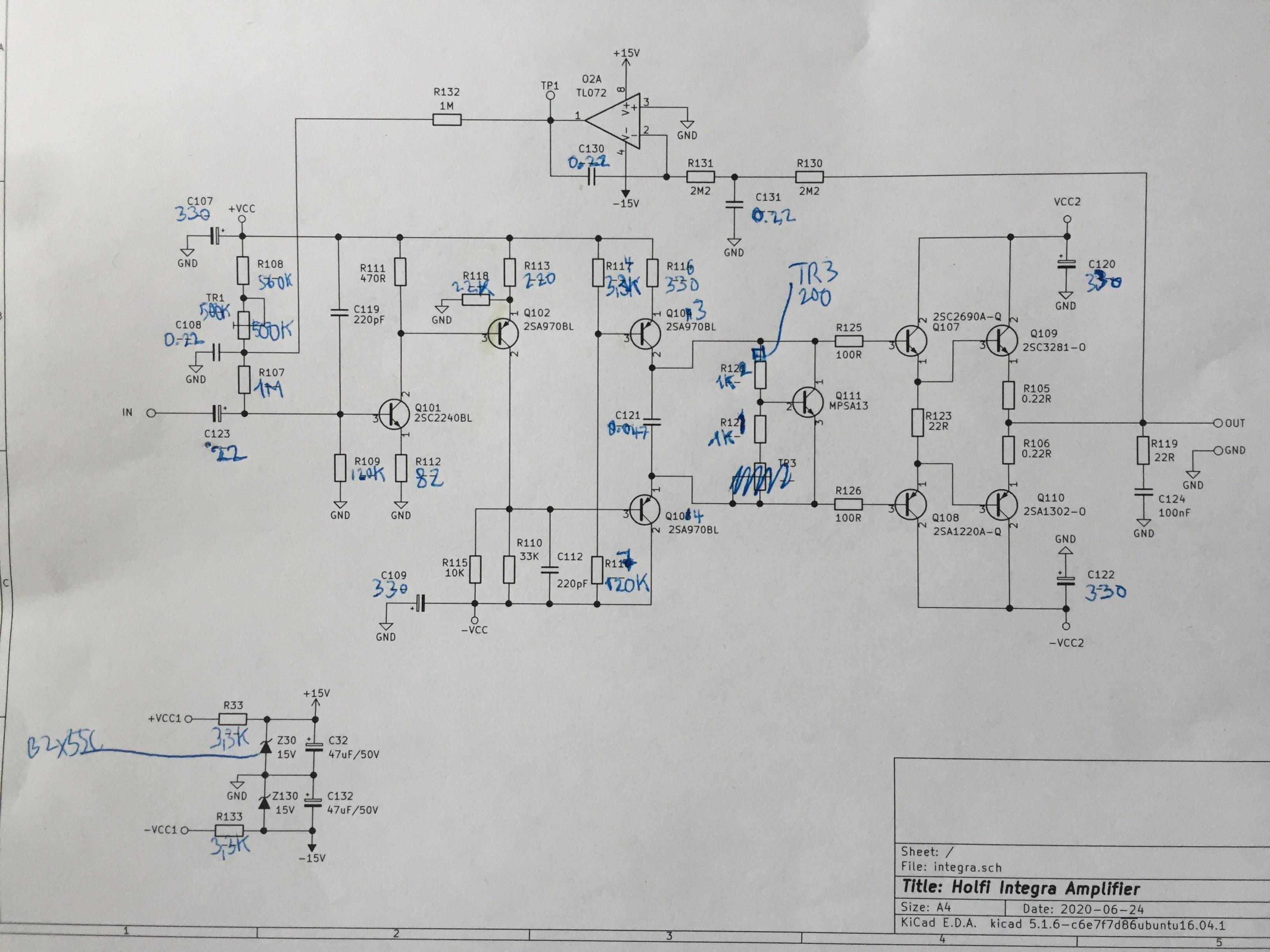

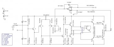

I have an Holfi integra amplifier, ver.1.1, I bought it thinking it would be an easy fix, but I didn´t expect to find every transistor on the power amp circuit replaced.
Can´t find any documentation online, I drawn a schematic to help me repair it. The output transistors were shorted so I replaced them, still it had full DC on the ouput, then noticed the first transistor (T1) was a 2sc2240GR and it needed more gain to get the proper bias, so I got a 2sc2240BL and solved the problem.
Now the only problem I have is no bias current on the output transistors and I find it weird to see a darlington BC879 as vbe multiplier (T6) that measures as a PNP instead of a NPN, and the pinout doesn´t seem to match the circuit board.
Does anyone know which is the original transistor? Is it viable to replace the base resistors and the transistor to a single npn instead?

The connection of the T6 transistor is incorrect.Collector must be connect to 1, base connect to 2
I have seen MPSA13 used in the position of T6 in another Holfi amplifier. Also being an darlington transistor.

I already got it working with a new BC879, but MPSA13 seems to be the one. I will replace it.
Thanks for the help.

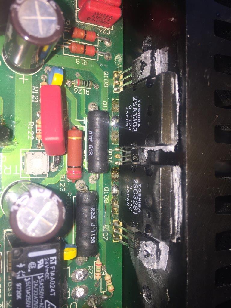

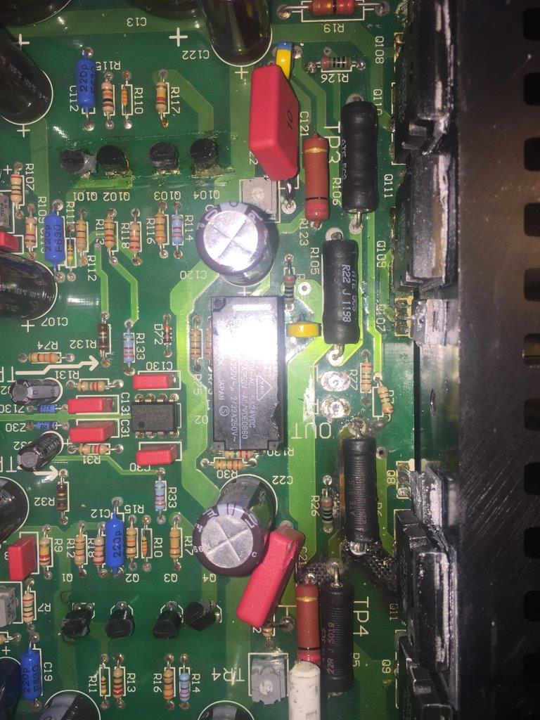

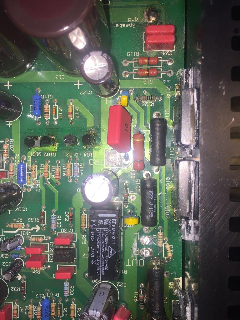

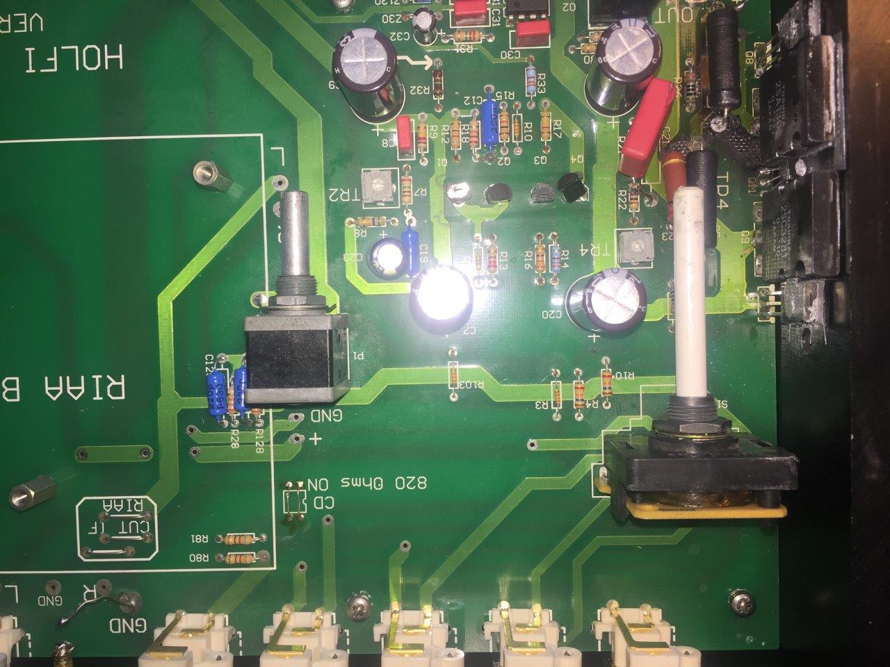

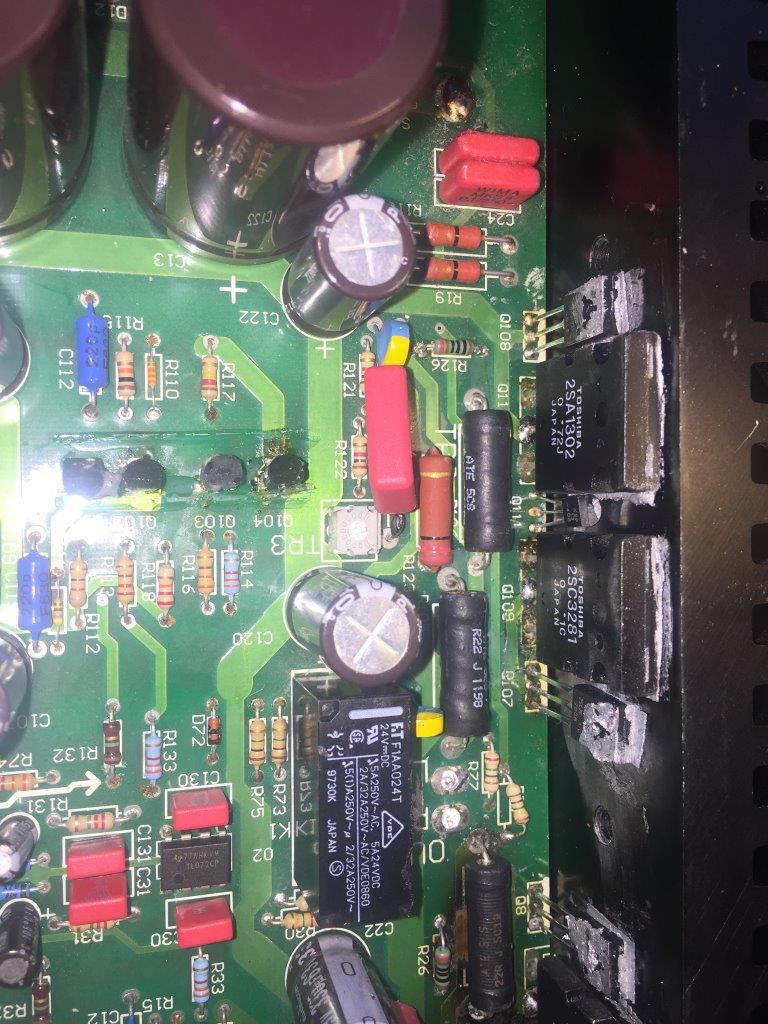

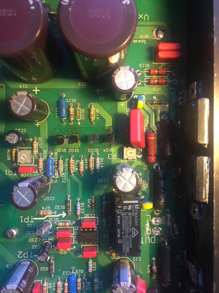

Hi....there are picture of left left channel.
Q108 is SA1220 - changed to new
Q110 is SA1302 - changed to new
Q111 is MPSA13 - changed to new
Q109 is 2SC3281 - changed to new
Q107 is SC2690 - - changed to new
Q101 is C2240BL - old, but probably not original
Q102, Q103, Q104 are SA970BL - old, but probably not original
I tried draw schematic, but I´m not skilled for that….
Let me know if its possible or to hard.

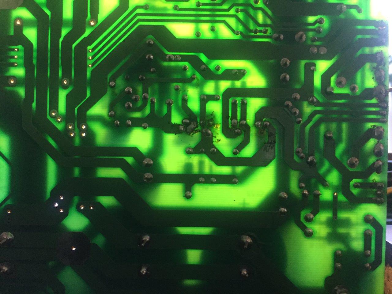

Lot of previous burns on right channel, but all cupper traces are good and tested for continuety….
Best from baek47

Hi baek47,
I have had a look at the pictures. Although it’s hard to see the resistor values I think I have a rough sketch of the schematic. I will try to start drawing it.
Just to make sure. You write you have to high a bias current in the right channel? Have you tried to power it full up to 230V?

Here is first attempt on the schematic from what I could see in pictures. There is likely an error so please try to validate that I have got it right. Also, there are some component values missing so perhaps you can fill these in and I will add them.

Great. It would surprise me if I hadn't made any mistakes. There are a few things that looks strange to me. The connection of R118 as an example. But, as far as I can determine it looks to be connected this way.

I have checked diagram with the amplifier - and I filled in missing values.¨
Yes - I think there are a few mistakes, but Im still more than impressed that you could go that far.….I have tried to check, with limited knowlegde on solid state amplifier, step by step....I think:
R118 is correct
TR3 is on one side connected to R122 and on the other side to R125, collector of MPSA13 and collector of Q103. Sounds right?
The R114m 116 and 117 should be swapped.
The pinnumbers on transistor doesnt match, but the symbols are correct.
I have put it in the schematic, see attached….and its a Holfi Integra 8 vers. 1.3
