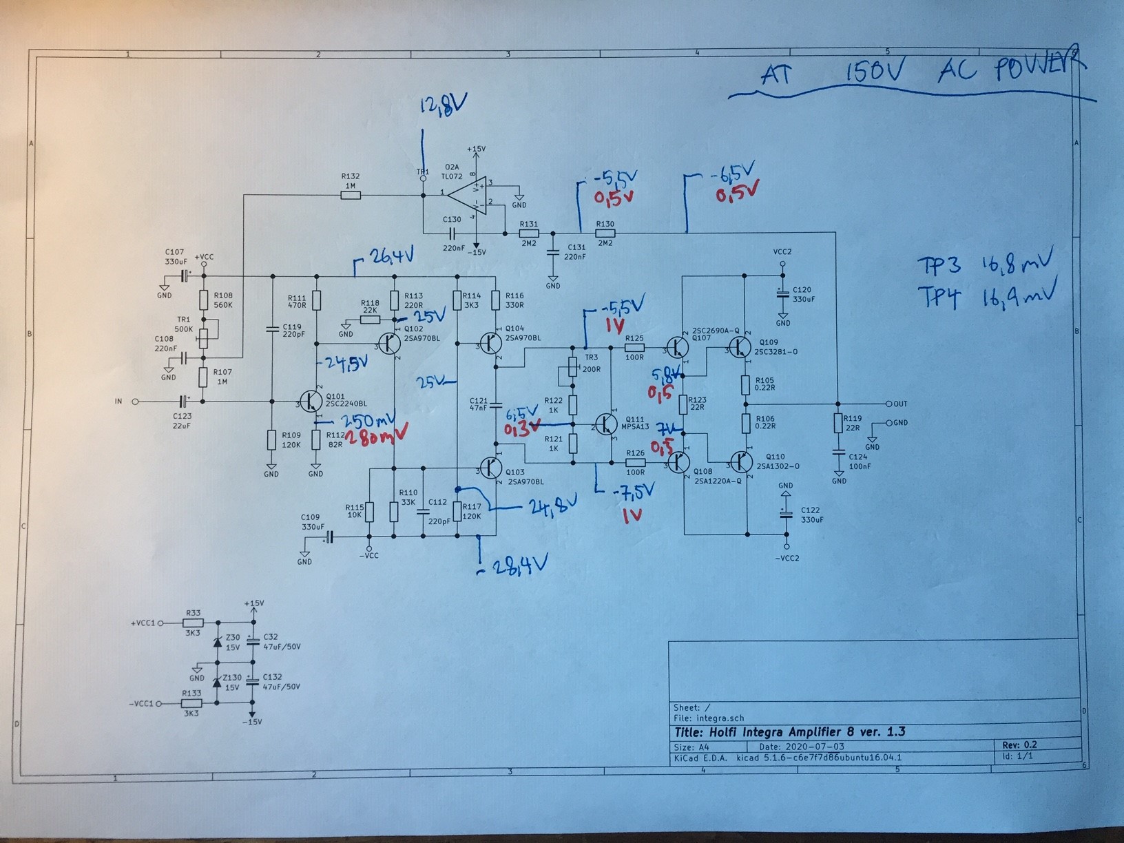

Fantastic, again - looks very good…..I tried with new resistor, but still no luck. Using the schematic I checked voltages, they were good on left side but right side only good until the 2240BL/970BL. I have ordered new and they will soon be at my doorstep…….

If you could add some voltage measurements on both the good and bad channel we could probably calculate where it's going wrong.
Judged on the pictures I thought that some of soldering on the input transistors could do with a clean up.
Where did you order the 2240BL/970BL? As far as I know they have not been in production for some years. I only know of an SMD version of the part. So please be aware of fakes.

Even with only the PSU supply voltages we should be able to some calculations. But, of course more measurements makes it easier.

I have meassured a little bit around, does it make any sense to you? When meassures are in blue color both channels are the same.....if red numbers, the bad channel meassures different. Notice Im still only at 150V AC power.

I did get the transistor and they looked fine and genuine, I put them in and everything - almost - went well.
  • I run full power, 230V - also without the variotrafo.
  • I have equal sound on both channels before the protection relay…..
  • Heat is fine - and equal L / R
I suspect the relay to be broken…….and I just got a new one from RS some days ago. Its going in this weekend....

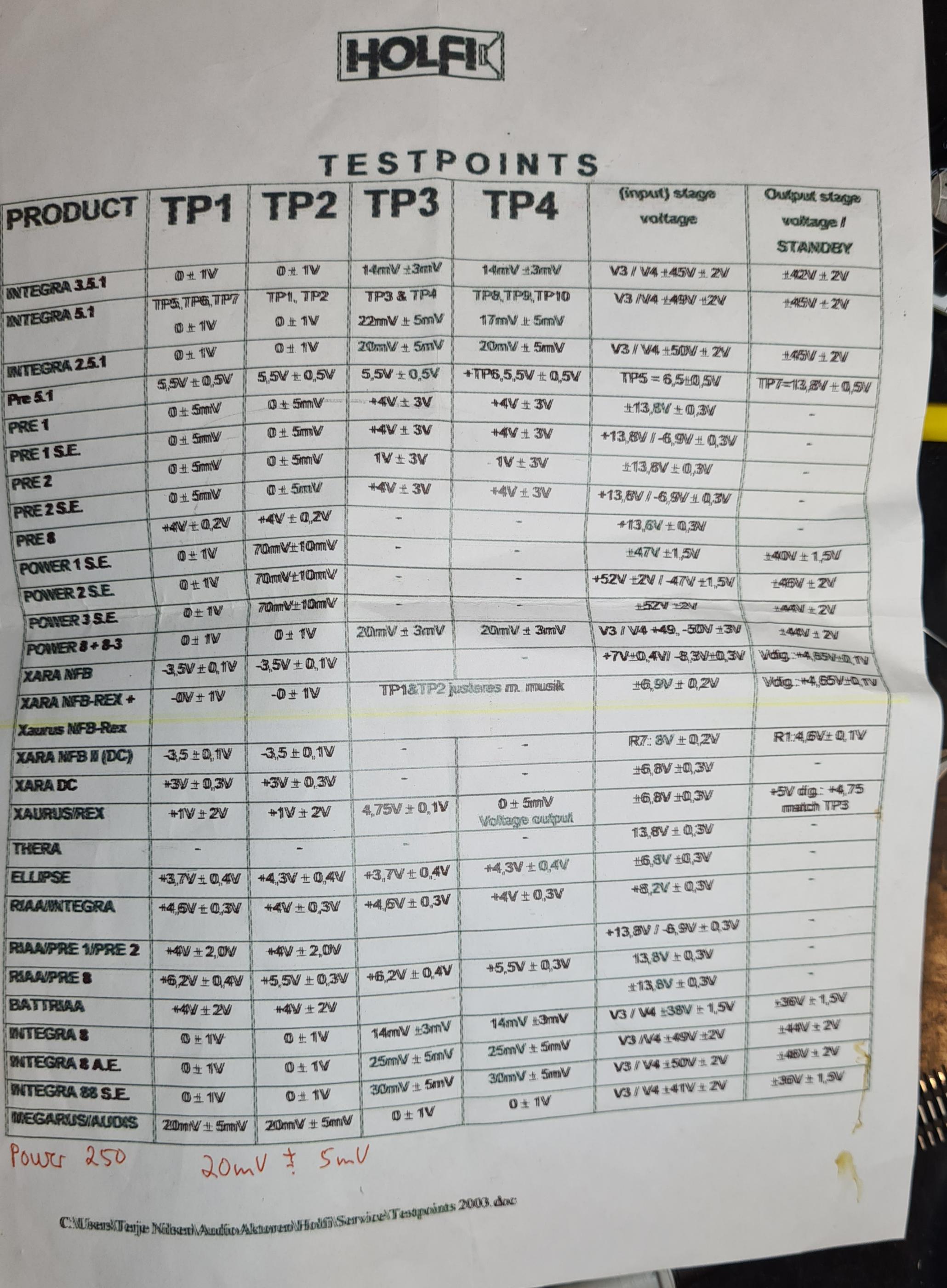

I have not fully adjusted DC-ofset and bias.
I have 15-16 mV bias and ca. 38 degrees directly on transistors - I plan to raise to 20mV?
I have within +/- 10 mV dc-offset - but the testpoint TP1 / TP2 meassure 7v.HIFI4ALL Forum: Holfi NB2 SE Power DC offset?

I tried adjusting again…..
It is possible to get the TP1/2 close to 0V - at least within 200-300 mV - and the dc-offset might have been a little lower and more stable.
I have raised the bias to 19 mV...

Sounds good that you have it up and running now. If it were me I would adjust TR1 so TP1 is as closed to 0V as possible. 200 - 300 mV is fine. That means that the servo is able to sving equally to either side of it's supply voltage.
As long at the servo can deliver enough voltage it's able to keep the amplifier output close to 0V DC.
Does this explanation make sense?
