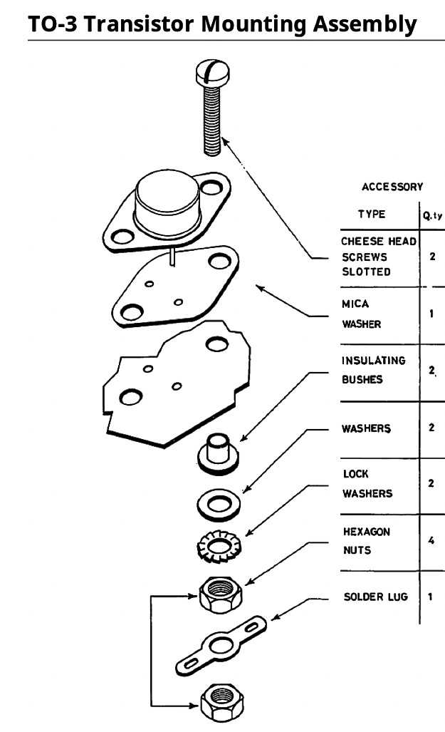

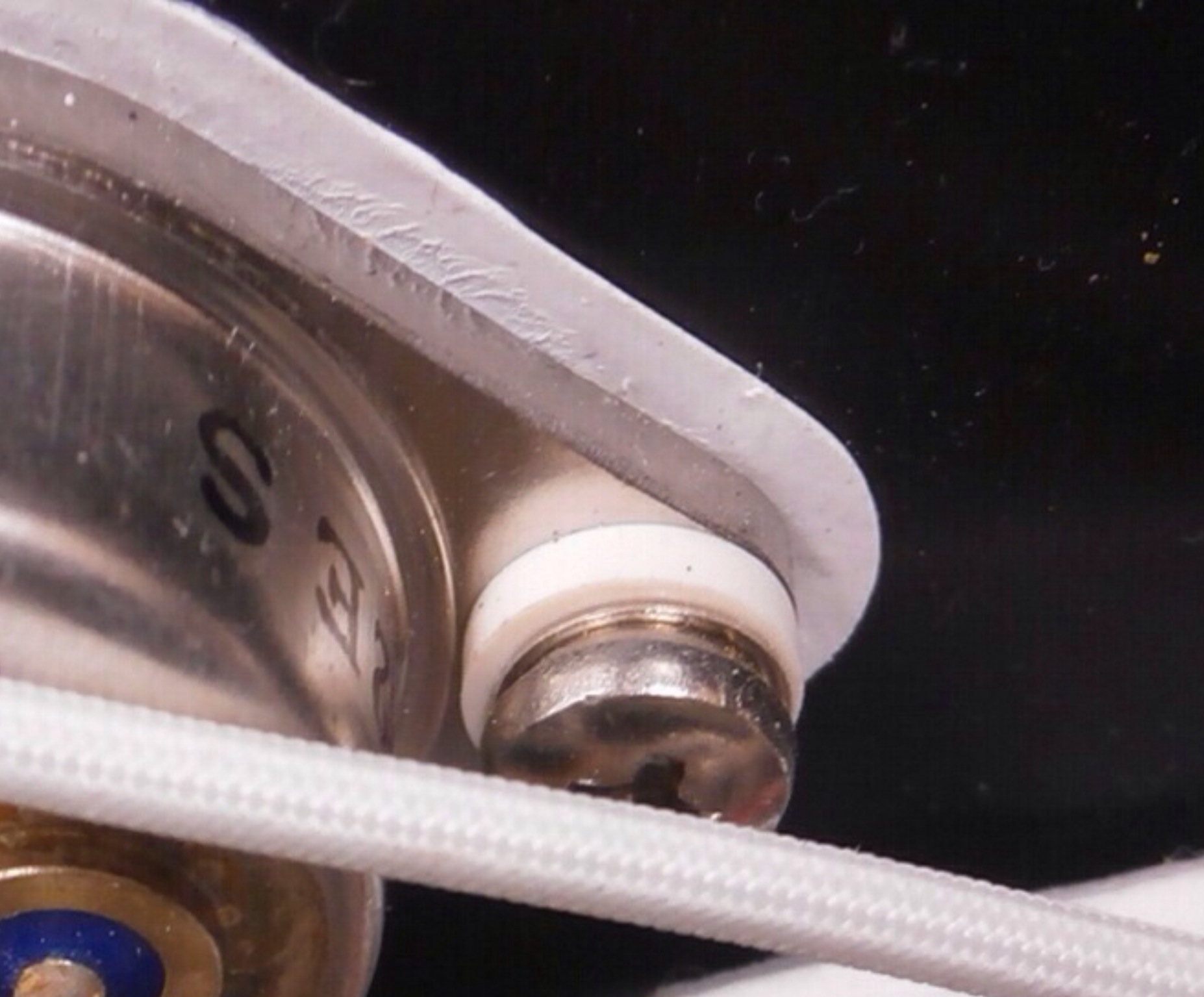

Thank you soundhappy. So it is all M4, except the brass welding washer that needs to be 4.2mm and fhe transistor washer TW10 ? Correct ?
I will make pictures tomorrow with two mounting kits on real transistors,
one 2SK180 and THF-51S/2SK182ES so we must be sure not make choice mistakes
or lack something.

Thanks Soundhappy. For the M4 screws, what length do you suggest ? I know it all depends of the heatsink... 25mm ??

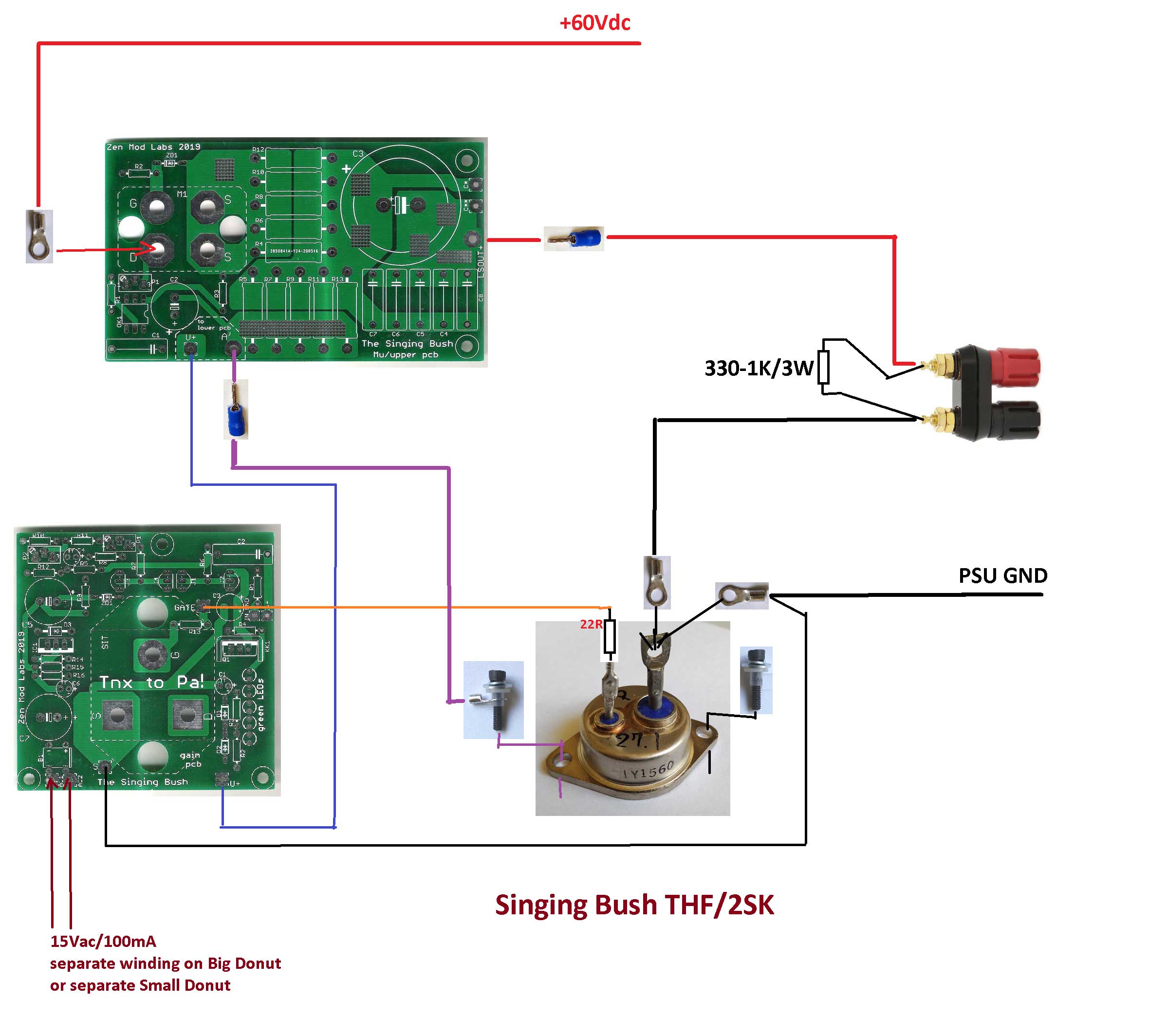

I don't see what's wrong, but I would do the grounding a little differently. I would bring the PSU ground to the CCS board and then return the speaker and THF grounds to the board. This would minimize the current loops. That's what I did on my BAF2015 THF amps.
Botte is making fun of me, which is normal thing ...... though, I'm rarely thinking about phase at amp output ( being easily reversed with speaker wires)..... for me - red terminal is hot; what you're going to do with polarity, who's going to tell 🙂
regarding wiring - power GND is connected to "power terminal" - source of SIT itself
there is hardly any energy flowing to pcb itself, and - at least in my organisation of things, this is most logical layout
in someone else's arrangement , different wiring layout could be better
though, point was in bushings, wire eyelets, washers , split washers and screws
Yes is depending on the Heatsinks dimensions and how deep you want to go with the screws inside the aluminium mater.
15 mm (0.59") to 20 mm (0.78") long is sufficient for direct mounting on the Heatsinks with THF-51S/2SK182ES.
Will be 5~7 mm less deep because flat washer + nylon bushing + transistor metal base +
thermal keratherm pad ( more if fat ceramic version used ) thickness

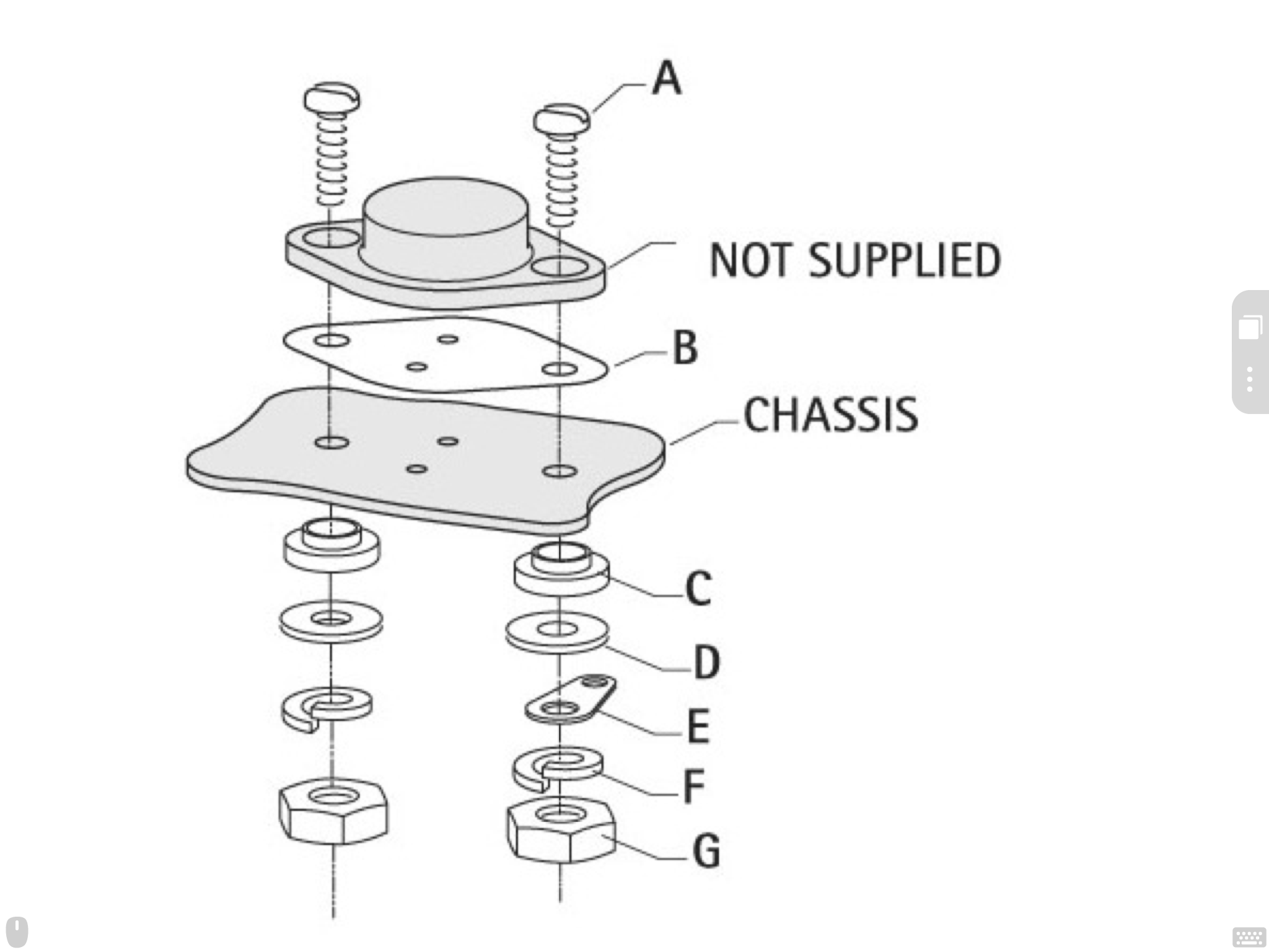

So it is all M4, except the brass welding washer that needs to be 4.2mm and the transistor washer TW10 ? Correct ?

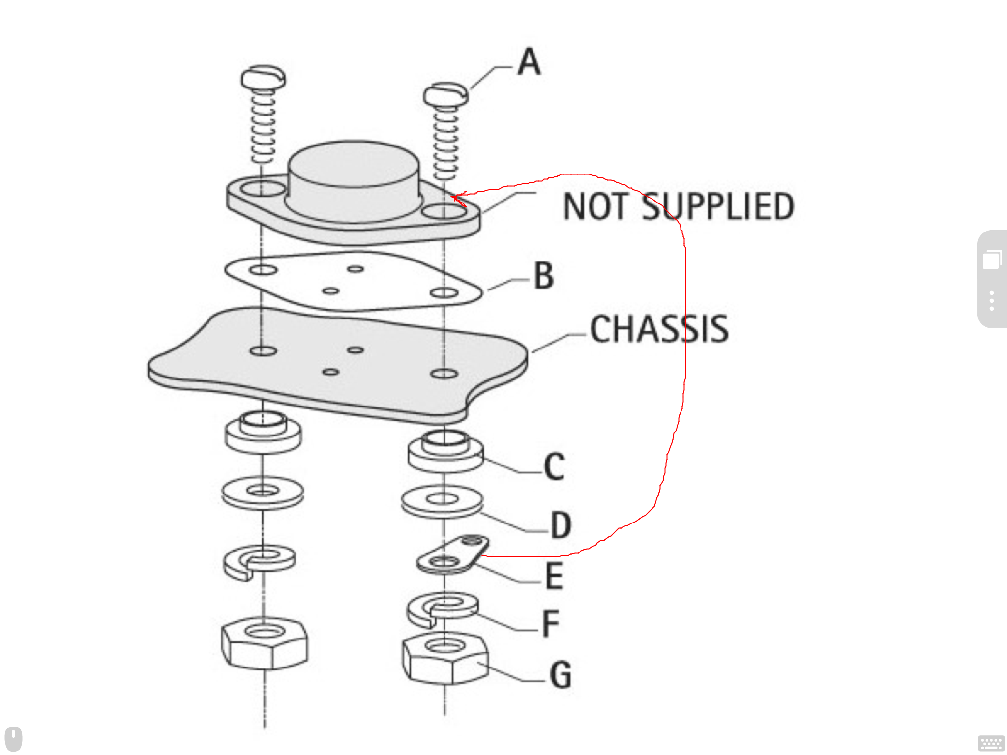

For your THF-51S or 2SK182ES no choice , wire is directly connected to the SIT case = drain
so only welding washer biger than external diameter of the TW10 nylon bushing in this case 5.2mm need be used
will sound better 😀
I agree with you.
The documents about the mounting of transistors in general is not made specially for high quality audio.
The best is a direct connection with the transistor case = drain no doubt.
In some situation of internal chassis wiring possibilities intermediary connection
of the drain by contact case and screw with solder lug and metal washer do the job.
Wire is less exposed on the high temperature heat because physical distance.
Your choice
