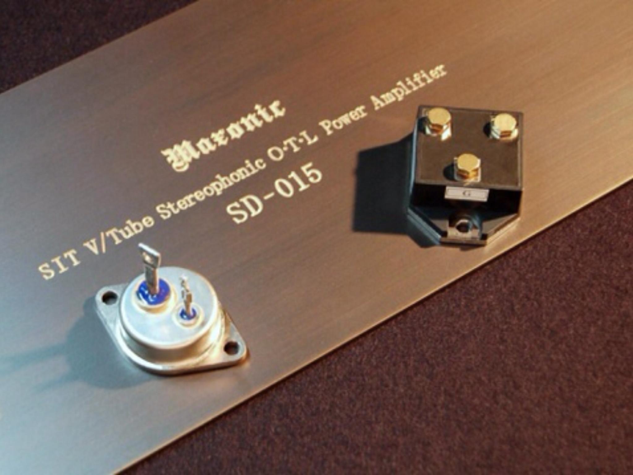

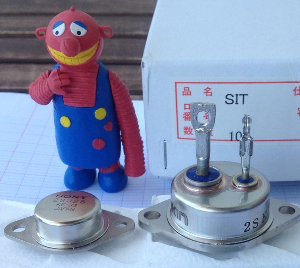

After post by member V FETish 2SK180 is a special huge "Jumbo TO-3"
Hockey Puck SIT 2SK180 by Tokin source NOS
I am interested to know the packages names of THF-51S and 2SK182ES etc.
I tryed to search but no luck.
Mytery industrial type maybe even uniq for those Tokin transistors only.
Very interesting.
I will continue my search then. 🙂
I find this transistor type beautiful. Especially shiny Tokins.
Can't stop staring on them.

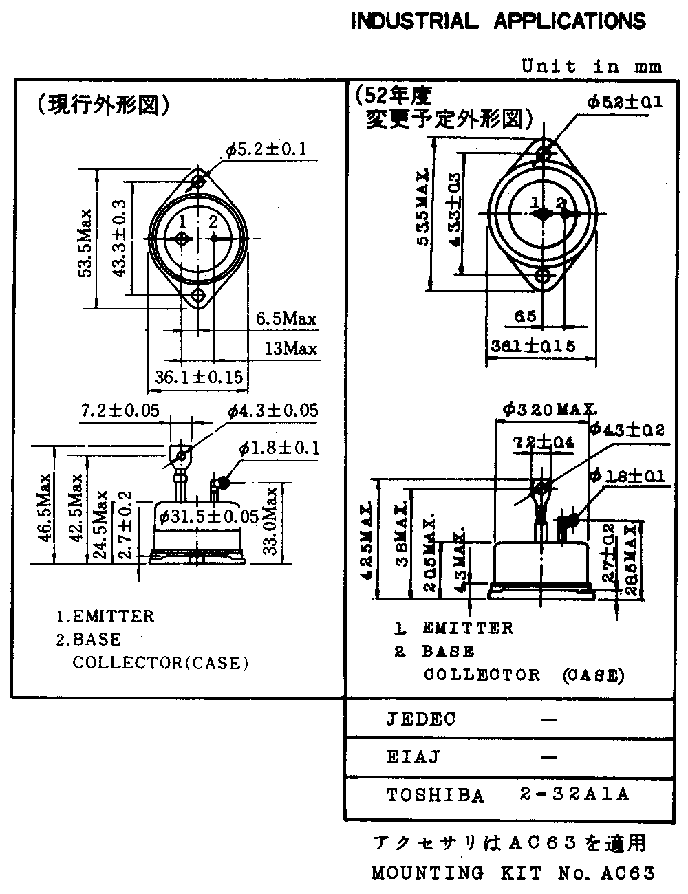

This looong Toshiba case have a weird package name: Toshiba 2-32A1A
That must be internal Toshiba naming.
Sometimes when I search I see it named as TO-03A1
Also found datasheet for Fuji 2SD806
There is writen that it is EIAJ TC-19, TB-30
But if you open EIAJ ED-7500A catalog it's neither TC-19 nor TB-30 but a mix with pins like in SC-25.
Still searching.

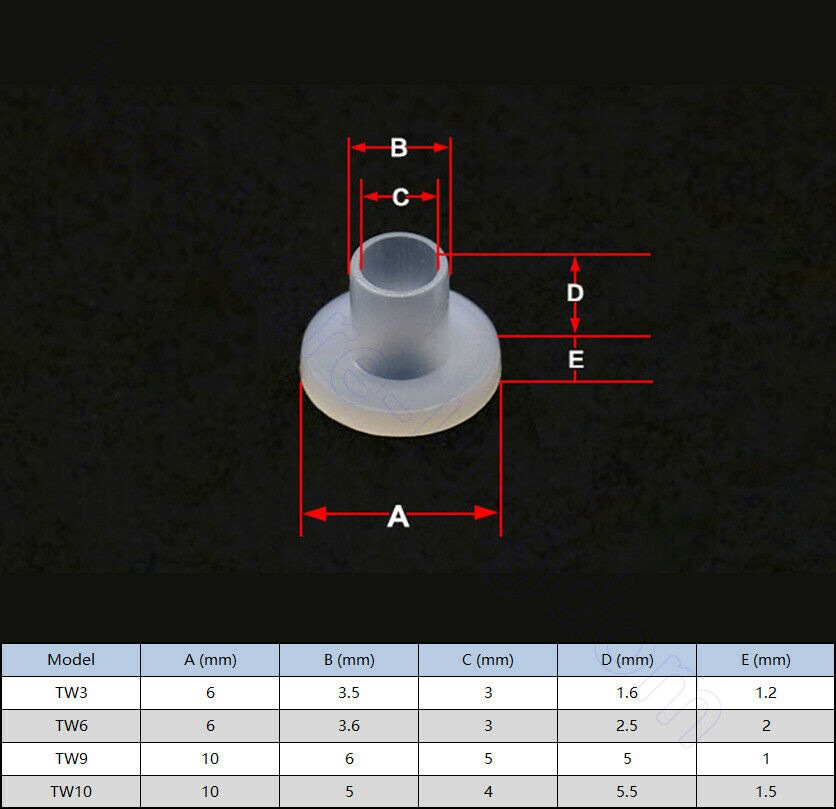

We would also need transistor washers.
Something 5-5.3mm wide and with 2.5mm height.
What everyone used in SissySIT?
Still searching.![]()

Toshiba produced as well Tokin 2SK180 Jumbo TO-3 equivalent with different package name G-TR

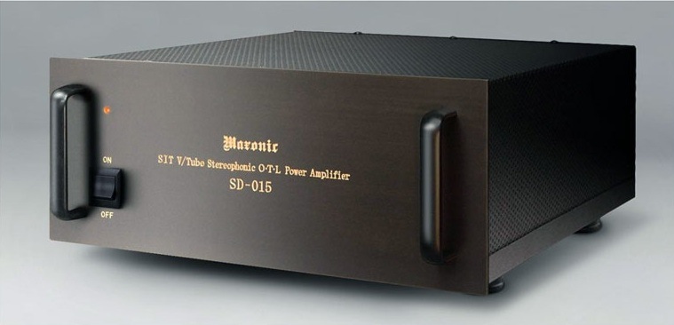

@ V FETish & Diyers
Your first contact with Vfet amps was 50 years ago:^) Impressive!
What is Your mysterious brand amplifier with Tokin SIT's ? Maxonic ?
BTW Tokin case " Jumbo TO-3 " name by Toshiba are G-TR = Giant TO-3 transistor

The right insulating bushing reference for Tokin SIT is TW-10
Transistor Washer for PC Plastic Nylon Insulator Bushing TW10 TW9 TW6 TW3 | eBay

@ Diyers
You can buy from the same Ebay shop all mechanical elements for Tokin mounting kit
TW10: Transistor Washer for PC Plastic Nylon Insulator Bushing TW10 TW9 TW6 TW3 | eBay
