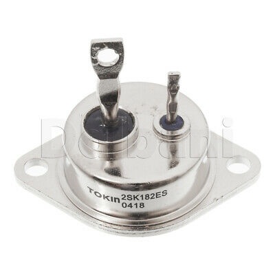

Better avoid this strange ones or at your own risk
2SK182ES Tokin Original Transistor TO3 | eBay
1PC THF-51S transistor | eBay

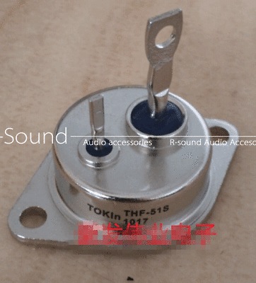

Also better avoid these too
tested as SIT: does not work. gate pin does not allow lowering nor raising the bias.
So:
Tested as an NPN transistor: does not work. (no conduction above 0,6V 'Vbe')
Tested as mosfet: does not work (no threshold above 4 V Vgs)
Might it be a relabelled thyristor marked as TOKIN THF? Do they think we are dumb?
we are, in buying these.
So:

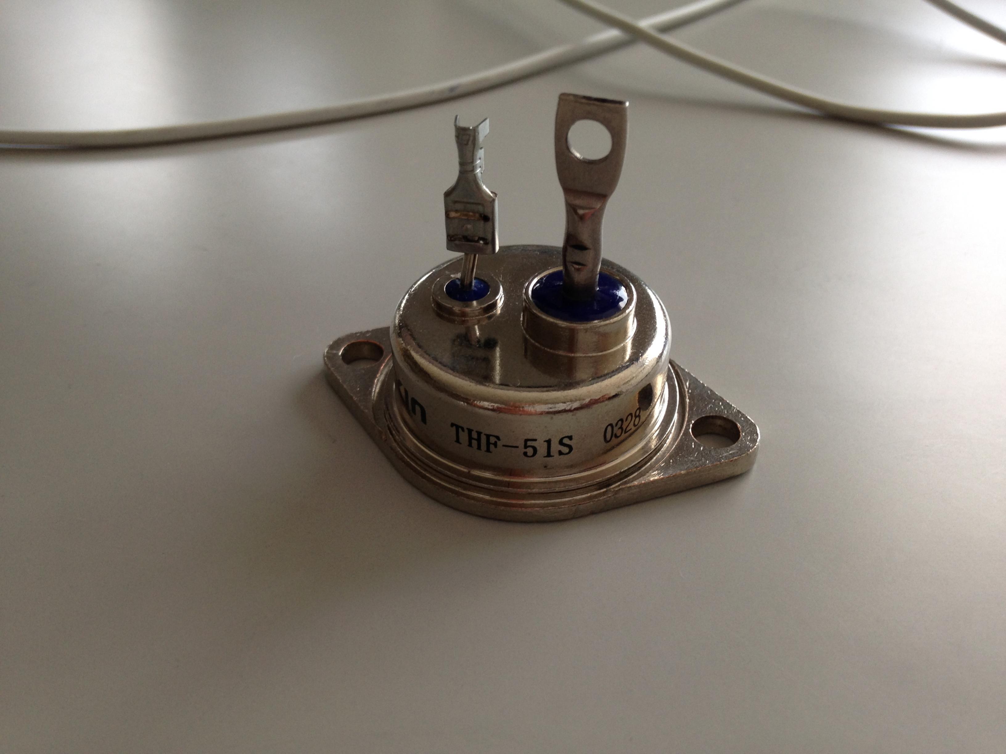

- Am I right that the connections of the THF are like the 2SK182?
Not two broken at the same time . . with the same "behaviour"

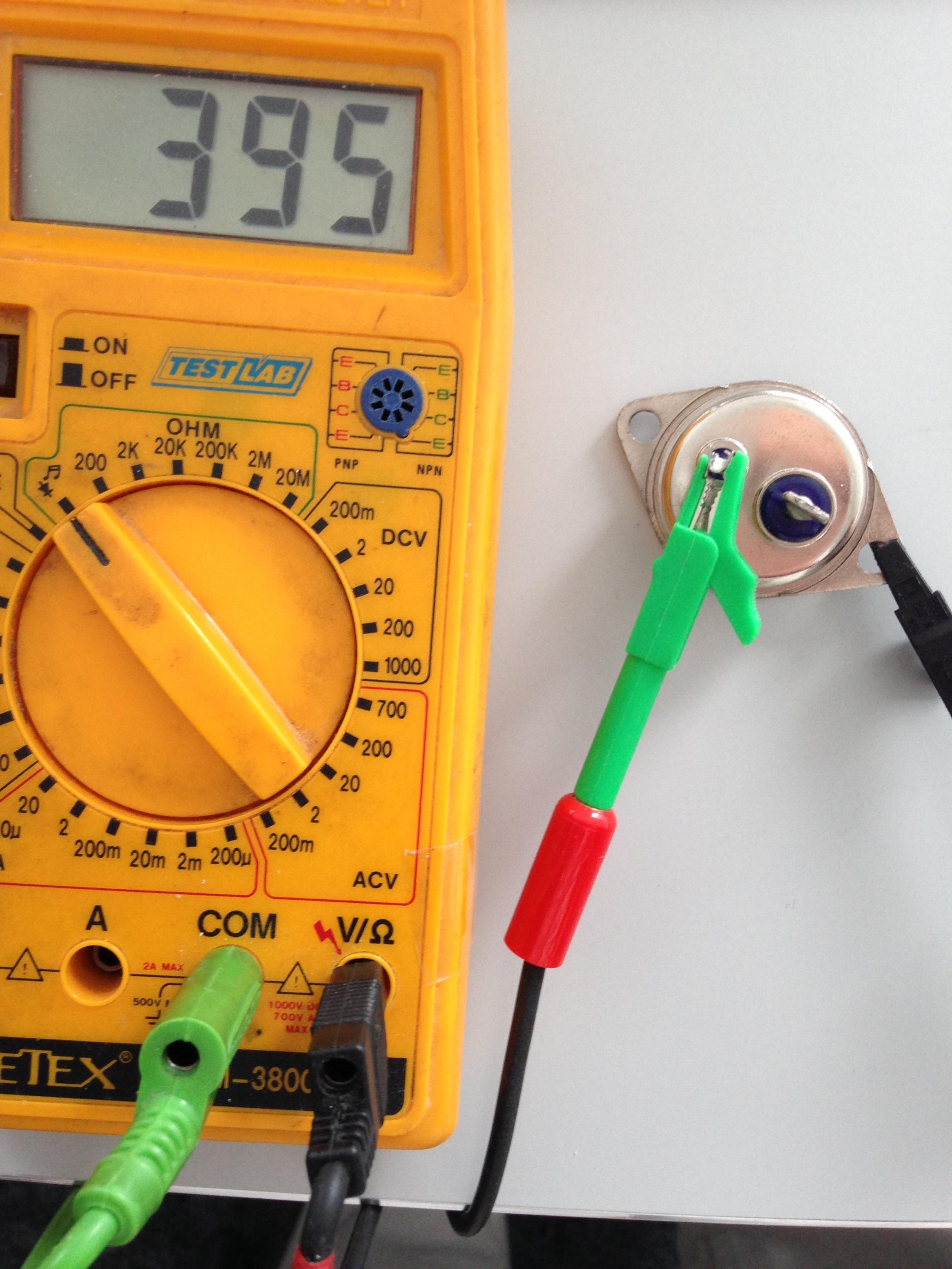

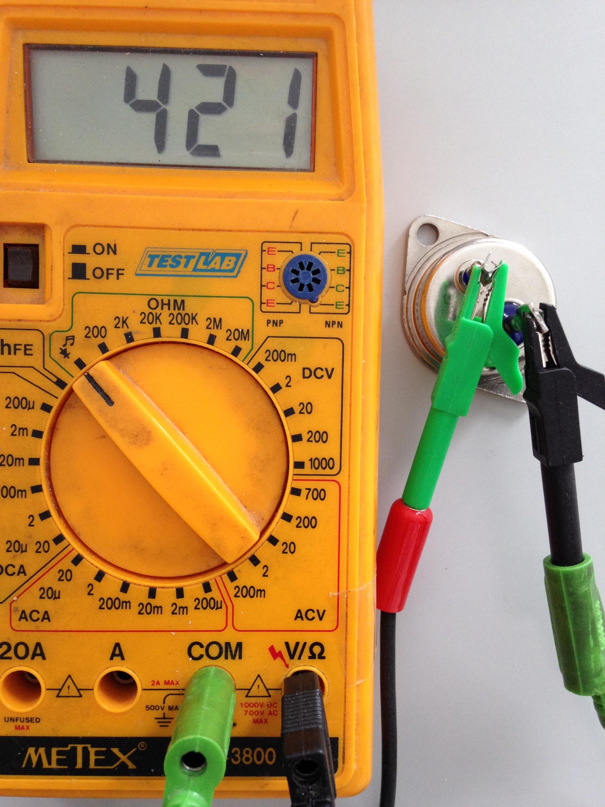

I did the test that is written by Sony for the VFET amplifier replacement procedure:
So. Both these "THF51" give . . . no low Rds/Rsd resistance at 200 ohm range , but using the junction voltage test I get a result. 😕
And no current flows with 25V over the unit and the 'gate' connected to a variable input +/- 12 V; whatever I choose.
It is not that the pins have been the victim of some babeltalk. It just makes no sense.
- Norm: Rds and Rsd should for the 2SK60 be around 1-3 ohm ohm.
- I measure Rds/Rsd one 0,35 the other 0,46 ohm on my old 2SK182.
- My 2SK180 gives 1,53 ohms reading both ways.
- -->the THF give none resistance. Infinity. Both.
- Norm: Rgs and Rgd upwards ords of 30 kohm in 2SK60
- I measure Rgs/Rgd at 10K in 2SK180, similar 2SK182
- -->the THF gives 560 ohms resistance. Both.
Problem is that those THF-51, pulled from the decommissioned equipment, were subjected to electroplating “beauty treatment”, During procedure, as all pins were exposed to electroplating voltage, semiconductor is simply burned.
I received two similar last year and they were burned, each one in a different way.
Also, these were mass produced for several years so it's not unlikely to find some fallout devices for sale as stocks dwindle.
What happened, how did the seller respond?Problem is that those THF-51, pulled from the decommissioned equipment, were subjected to electroplating “beauty treatment”, During procedure, as all pins were exposed to electroplating voltage, semiconductor is simply burned.
Burned . . .
It was a different seller on AliExpress, but those frauds use the same methods and likely the same source for parts.
Seller was playing dumb, so it was easier to press on AliExpress. They didn’t yield easily, but I got a refund.
Yes, they did. It helped that picture of advertised THF-51 was of original part and I received freshly electroplated parts with different lettering.
However, on parts you received, there is a new method. Original designation letters were preserved during electroplating. Original dull silver-gray surface is there. So, this was an original THF-51S. Clumsy electroplating procedure killed the chip.
