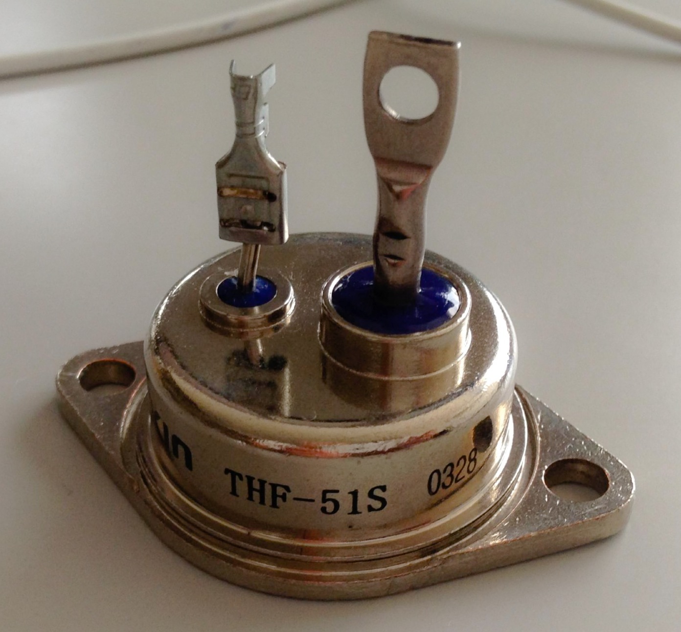

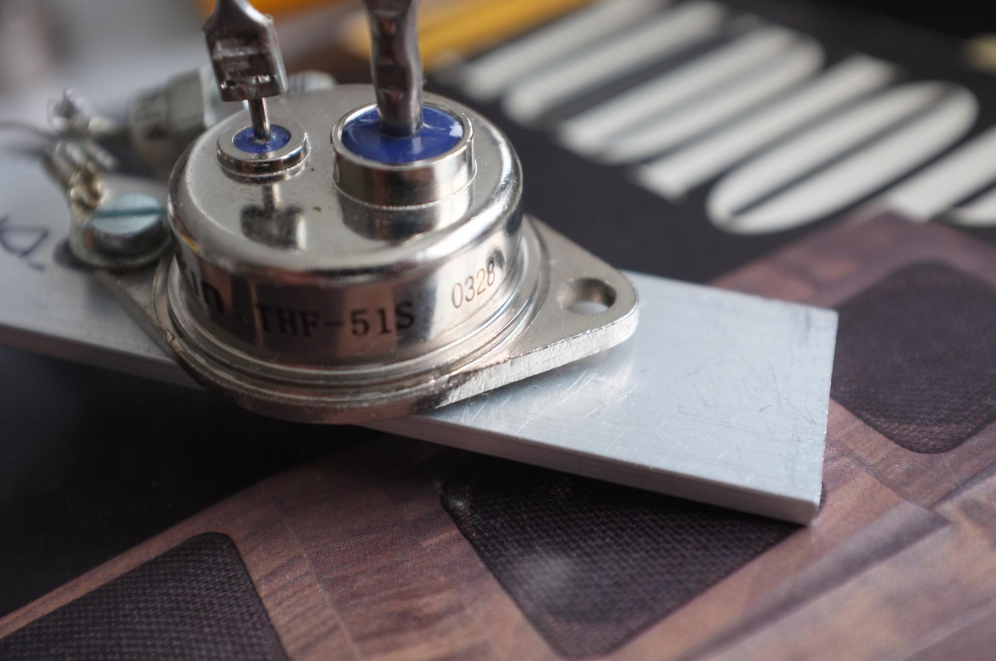

It is more that the TOKIN lettering was now done with letters from a correct [American] typeset.
The added numbers [0328] are a new invention. 🙄

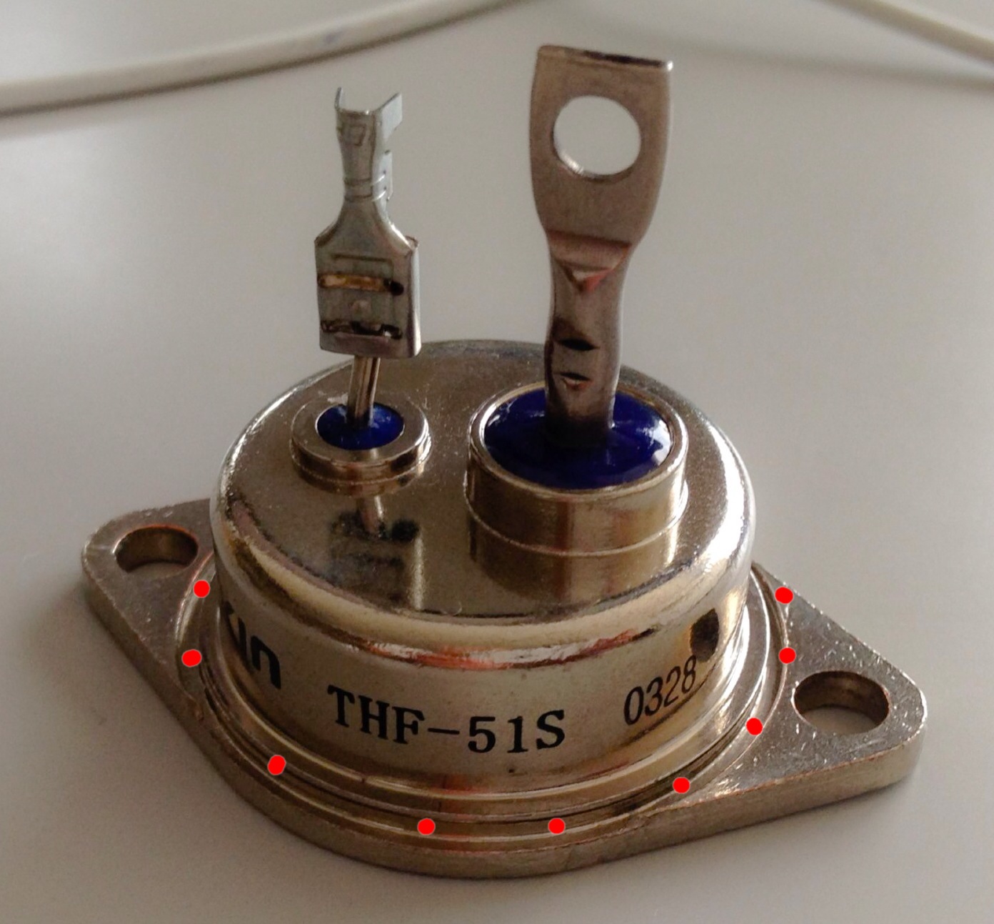

@ Triode_al
What strange circle ?
Look at the photo, place with red points.
I see this for the first time.. none original Tokin have this, photo on the right
You are quite right, there is a recessed, milled circle. Sharp eyes.
The round house is pushed on in a different way: the mounting structure has a edge on which the rim of the house fits on inside of that recess. Note also the base plate is stamped in another way.
The old ones have the house with the rim directly on the base plate. No recess.
"Make look-alike industry"?

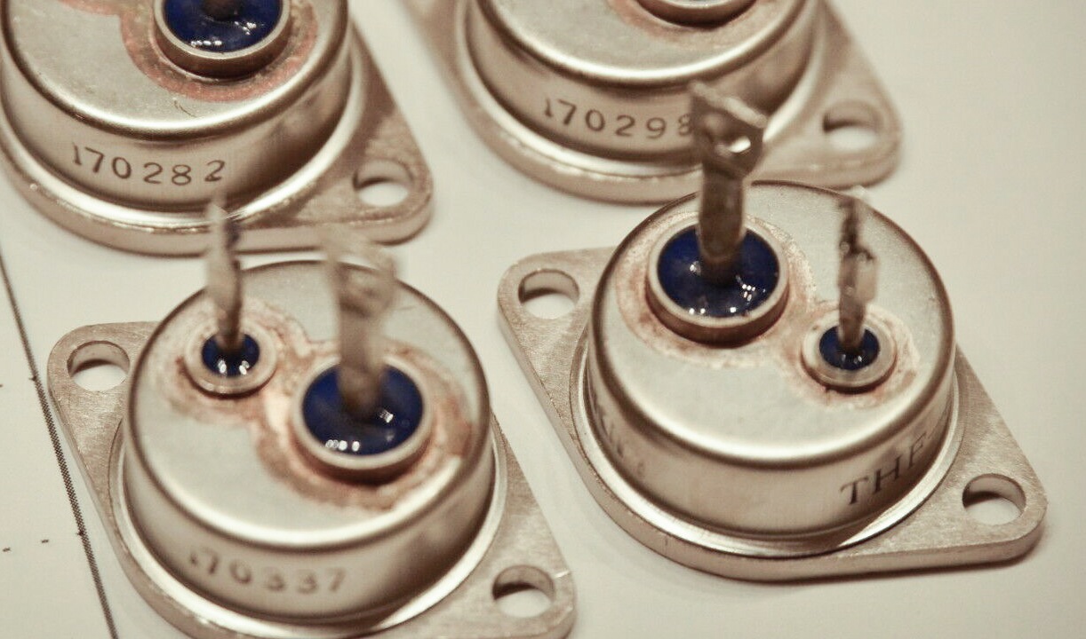

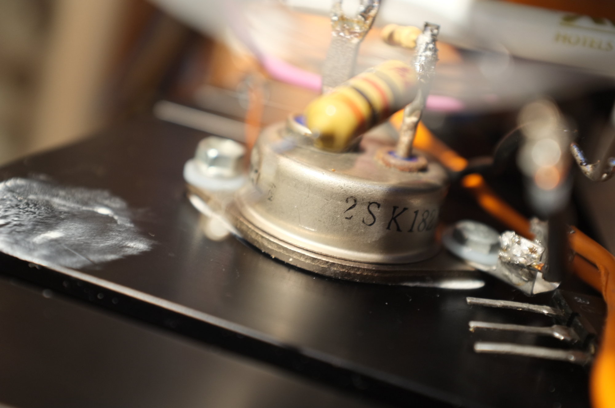

the old working TOKINs I have
Then the magnet test: the K182 has magnetic base and house, just like this THF. The K180 I have has a copper base - a much better industrial practice of course.

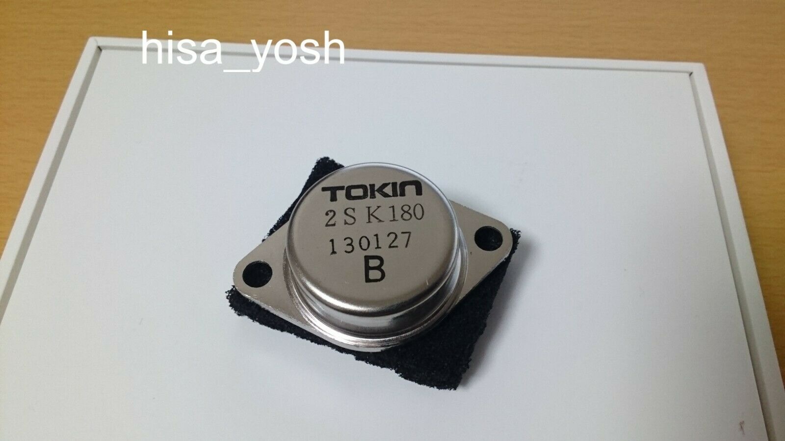

Today is the last genuine 2SK180 Tokin source on Ebay by new seller Hisa_Yosh from Japan.
Buy with confidence
2SK180 TOKIN SIT FET Power SIT Static induction transistor 1pcs | eBay
Buy with confidence

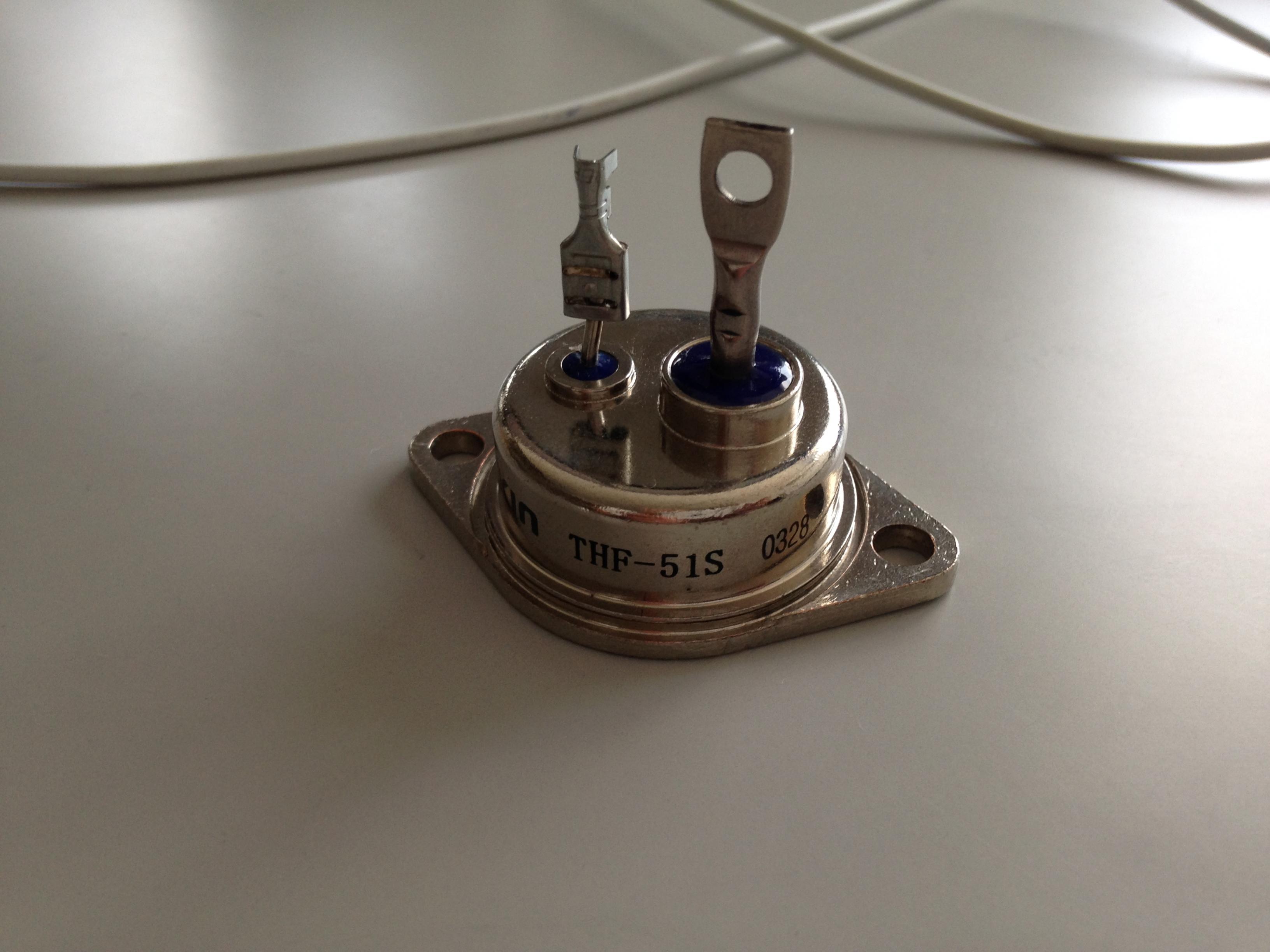

Also better avoid these too
tested as SIT: does not work. gate pin does not allow lowering nor raising the bias.
So:
Tested as an NPN transistor: does not work. (no conduction above 0,6V 'Vbe')
Tested as mosfet: does not work (no threshold above 4 V Vgs)
- The connection I made was big pin as source; house as collector via 15 ohm to + 25V; small pin as base connected to a potmeter 25K connected to plus minus 12V, over a 4k resistor to the small pin.
Whatever the position of the slider, Only a voltage of about (between -1 V to plus 1V is left). The small pin sinks all input current.- That is, with or without Power Supply +25V connected
- No current through the 'collector' pin.
- With my real Tokins I can set the gate pin to -10 or -15V, VGS, without gate current. Then I can bring up the 25V power line, and turn the slider untill it conducts. With real mosfets, they start to conduct above 3,5 volt or so in this setting.
Might it be a relabelled thyristor marked as TOKIN THF? Do they think we are dumb?.
we are, in buying these.
- Am I right that the connections of the THF are like the 2SK182?
This is a printed, electroplated product, because the price is cheap, so many AliExpress (Chinese sellers) some of them use my photo, and then upload the picture to sell on AliExpress
Pretend to make buyers trust them and attract customers to buy
(But the selling price is also very expensive)
Better avoid this strange ones or at your own risk
