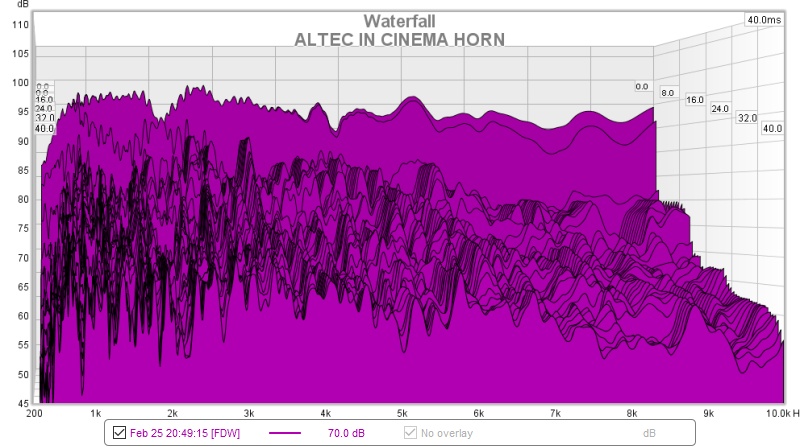

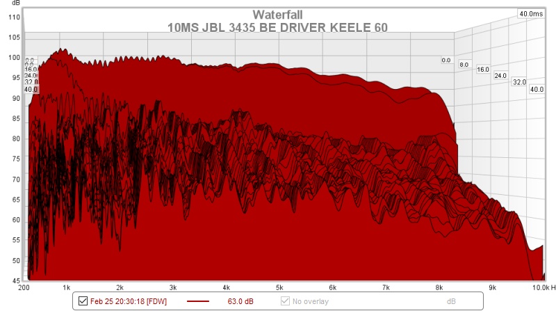

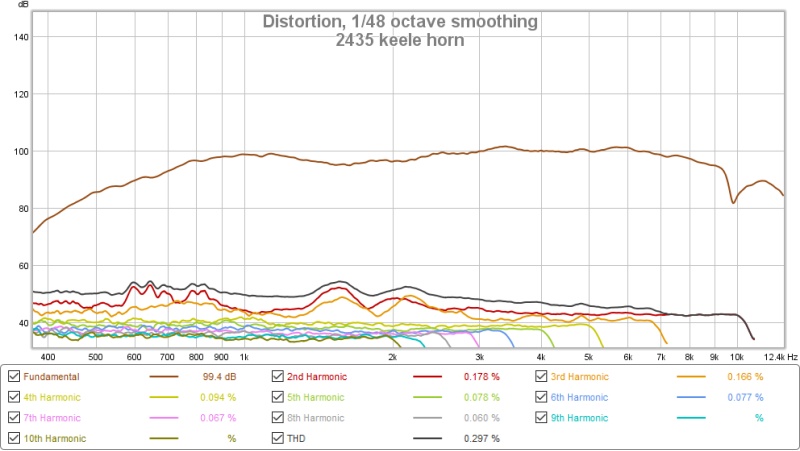

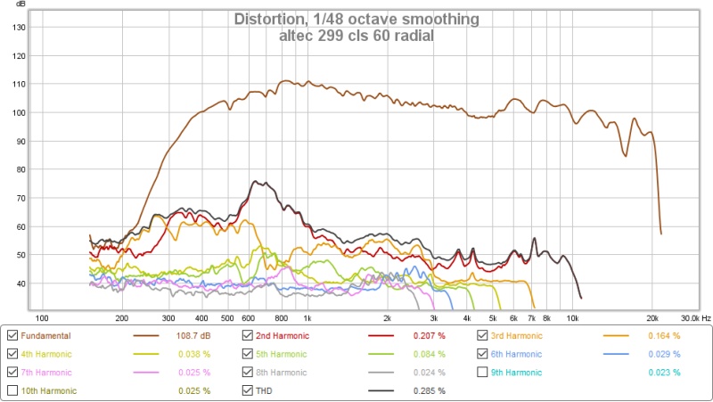

ALTEC 288 VS JBL 2435 10MS SETTLING
here is a comparison of two different drivers in two different horns. the jbl be driver is FAST - the jbl 2435hpl be is in the big keele 60 degree conic expo horn - the aluminum altec 288 8g is in the jbl 2435 cinema horn - 10 ms 🙂
JBL 2435 IN KEELE
ALTEC 288 8G IN JBL CINEMA HORN 2384
JBL 2435 IN KEELE

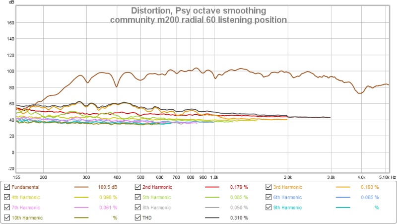

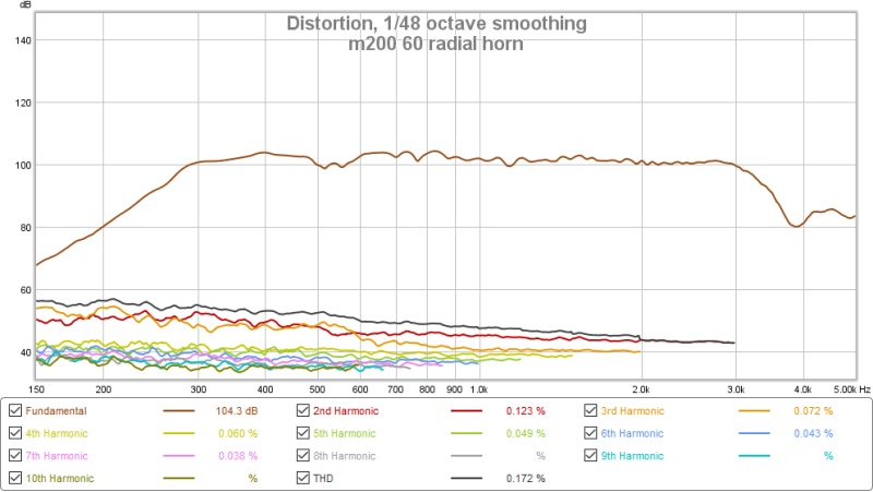

I have the M200's not M200A's, never had the new ones you buy online. The M200 aren't as extended in the upper range as the newer model but the midrange is dead on spooky. I was comparing them to the Altec 288, 299 and the little JBL 2435 be driver and within their range the only one that is near as convincing is the JBL because of it's resolution - BUT the M200's do not have the small coloration of the JBL - kind of a syrupy glaze. Both of them are better than the Altecs under 3K. They would be a great driver to use in the 2360 except how would you integrate the treble horn with that big horn?
Before I went off o this tangent of trying to make a 2-way horn system , that didn't work, and then to trying a wide range midrange with treble three way, (better) I was using the Community driver. Now I think I'm back, I just haven't found a driver that will match it in the upper midrange and low treble. Even with 128K streaming they sound convincing, LOL, put on a good album and it's heaven.

I don't have that driver. My guess it is exactly what people found. A great match for the JBL 2384 cinema horn. I can't speak of a direct comparison with the Community driver. The community is good to 3k where the JBL they speak of they are using all the way through the treble. I have not found a 1.4 or 1.5 format driver that I preferred over using a separate treble horn.
