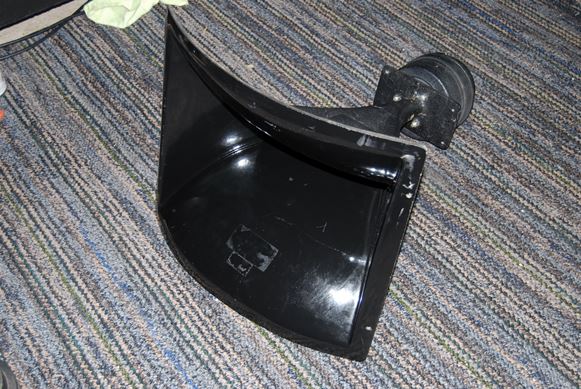

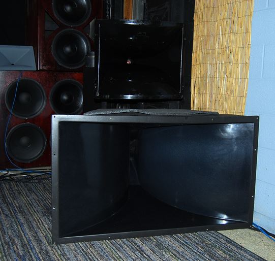

cleaned the gap, removed previous 50ml ferofluid of the 2435 drivers and added the recommended 100ml of ferofluid. mounted the jbl cinema horns 2384 and designed passive eq - sound is much better. now i hear the promise of this horn and driver combination. 4th order staggered acoustic high pass at 650 cycles with 2nd order acoustic 600 cycle low pass on the bass horns. low midrange is much better, the bass and mid horns are getting synchronized

Thanks! Very interesting - I will read and digest - I know the 2435 has virtually no exit snout and was designed to be used in the line array waveguides so maybe that will help - I made a quick adapter for the Altec 288 8g (long snout) to use with the 2384 and it measured very well - better than the JBL 2435hpl - haven't listened to that combo yet. The 2435 is really nice in this horn with some passive eq.

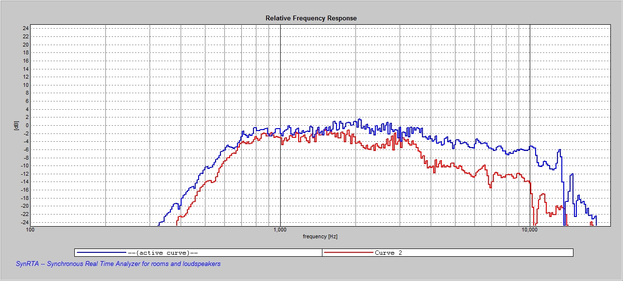

Yes I will do that - I want to compare the Altec 288 8G to the JBL 2435 in the Cinema horns. I'll get some measurements and put the two through some listening soon. 😀

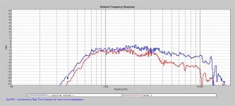

😱 😕blue is altec 288 8g gpa diaphragm
red is jbl 2435 hpl beryllium driver
JBL 2384 CINEMA ARRAY HORN ALTEC 288G VS JBL 2435 BE

You are welcome.
In this horn 700 to 8k. That's with no eq. If I eq the JBL driver for similar response there will be around a 12db loss in sensitivity.
I have other horns where the Altec drivers could be used 400 cycles up. I also have a newer pair of 288 that are ferrite with tangerine phase plug. I'm now curious to compare them to the alnico radial plug shown here.

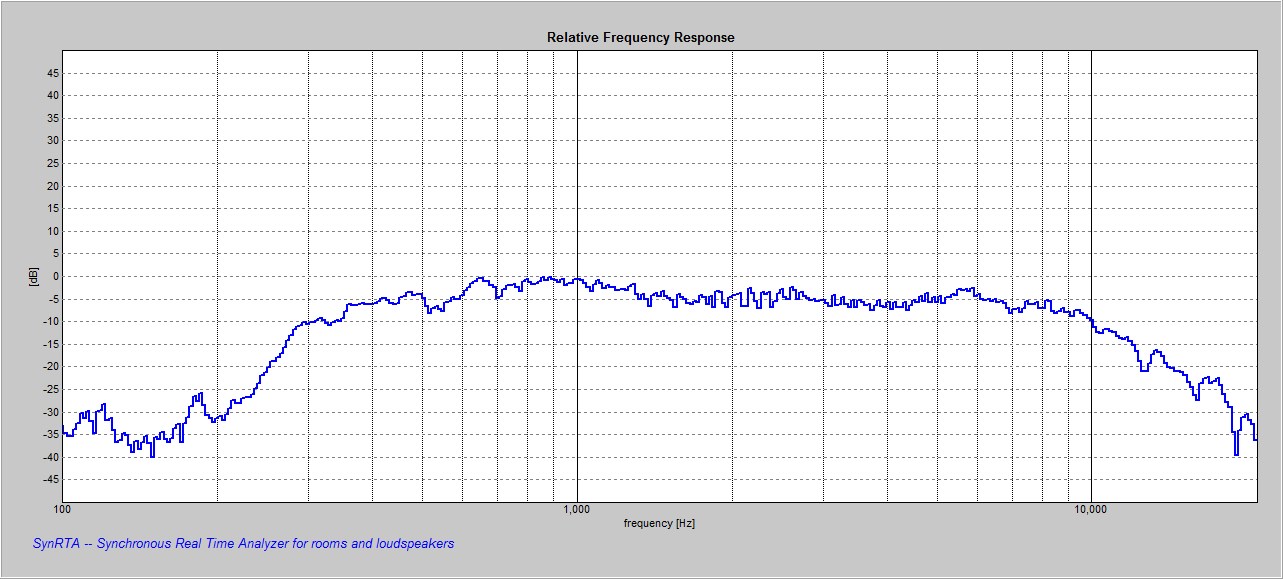

here is on axis comparison 3 feet out same input level no eq 1/48th smoothing
Compare that to the same 2435 driver in my big 60 degree radial horns. i'm still listening to the altec 288g in the jbl cinema horns. they sound great. strange the old long snout altec alnicos are so much better in the new jbl cinema horn YET the short exit snout be jbl 2435 is so good in the radial.

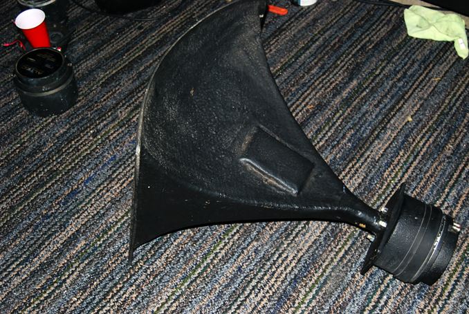

The RH-60 is a fiberglass horn made by Community Light & Sound. It is aprox 24" wide by 22" tall by 25" deep in the 1.4" Altec version. The horn was made in 2" and 1" versions also. I have the 90 degree 2" version too it's called the BRH90 - BRH = Big Radial Horn - It's a 60 degree CD/Radial with both conical and hypex flares. With the 299 driver shown in the pictures (Pascalite dome) I use them from 600 Hz up. The 299 actually can be used down to 300 Hz in this horn but my midbass horn captures (85-600 hz, Fane Studio 10) that range better than the compression driver. Compared to the CMCD we are talking about this system where I have a superior midbass low midrange system crossed to a horn that takes care of the entire upper range. This sounds better. Differnt Horny Animals 😀
I'm really attracted to your midbass horn
Is this something you can purchase or did you build it? It looks like the former since I can see screw holes.
Any measurements of it with the Fane?

I'm not familiar with Cinema system, but the horn is a snout-less bi-radial (kind) that requires the boost at the high end? It's interesting to see a conventional long snout driver has better HF at least on axis.
