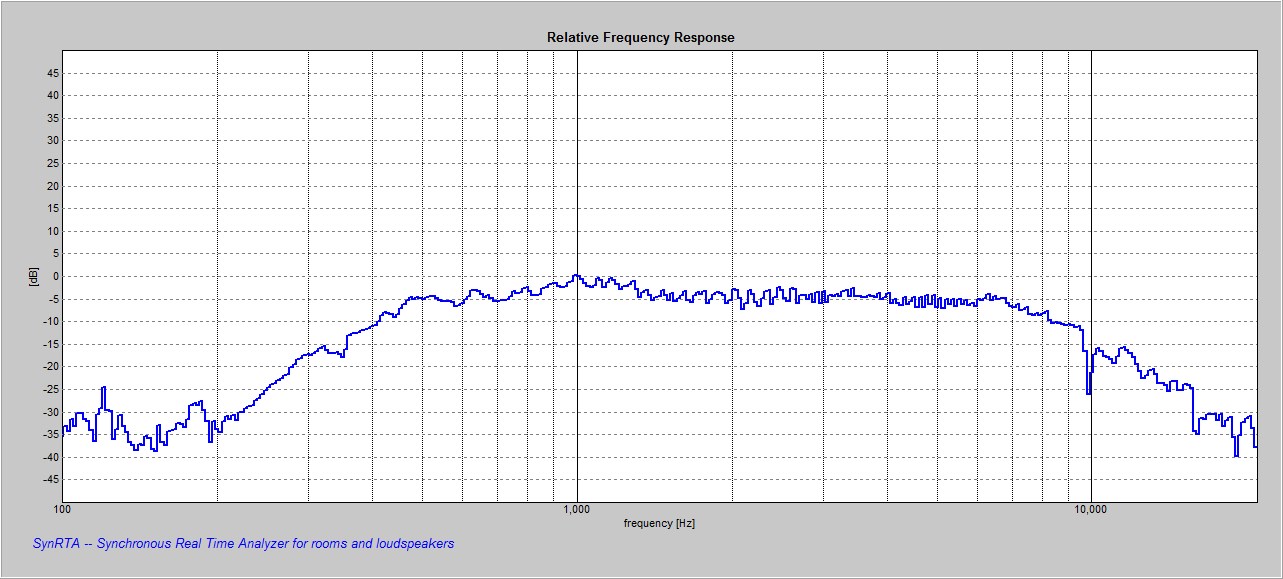

I'm not familiar with Cinema system, but the horn is a snout-less bi-radial (kind) that requires the boost at the high end? It's interesting to see a conventional long snout driver has better HF at least on axis.
It's a waveguide. Not biradial. The compression driver (Jbl 2435HPL) is snoutless. I was also surprised to find the old Altec driver to outperform the modern JBL driver in a modern JBL top of the line horn. 🙂 😱
The same JBL driver in a BRH60 (BIG community 60 degree radial) requires very little padding to run nearly full range.
With eq the JBL 2435HPL driver sound good - problem is my mid bass is 108 db sensitive and the JBL cineama horn/jbl driver needs over 9 db of padding in the midrange for good response. The Altec 288G (the biggest baddest alnico 288 ever) need no eq. Maybe it's the massive motor strength of the Altec?
The same horn as used in the 4722 (and other larger Cinema speakers) The horn is the JBL 2384

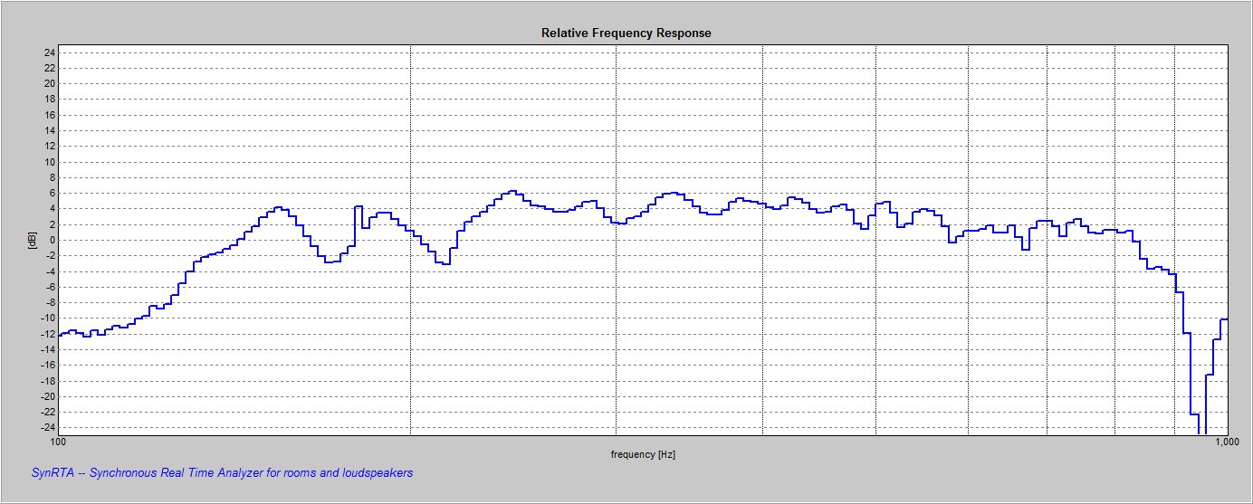

I'm really attracted to your midbass horn
Is this something you can purchase or did you build it? It looks like the former since I can see screw holes.
Any measurements of it with the Fane?
They are a pair of fiberglass Emilar EH153 bifurcated horns designed to be used with the Emilar EC600 6" compression driver in free space. I used to use them with that driver in half space where they worked well to 150 hz. A local fellow heard them and bought them from me years ago and never got around to using them (they are big) so I bought them back and decided to find a more suitable driver to use with them other than the compression driver. (I was using 15 and 12" drivers in front horns and was never really satisfied with the low midrange - Altec, EV, TAD, B&C, ect.. ) The B&C 8PE21 ended up being a great match and works well down to 100 cycles. I tried the Fane Studio 8M and found it wasn't as good as the B&C. Than I found the Sudio 10M - I will post some measurements for this in the near future. The B&C is a great driver in this horn and 10M is spooky good and better

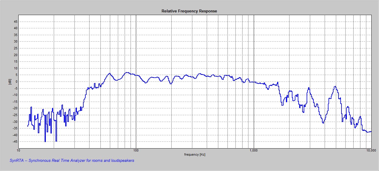

SYSTEM STANDS AT;
low bass - 40 cycles down - 1/8th space mono front bass horn 18 inch, rear corner dual 18 mono
bass - six 15 inch bass drivers 40-80 cycles with eight 8 inch floor loaded couplers- stereo
upper bass low midrange - fane studio 10m in front horn 80-650 cycles
upper midrange treble - altec 288 8g in jbl 2384 cinema horns 650 - 8k
high treble - celestion cdx1730 in faital waveguide wg101
