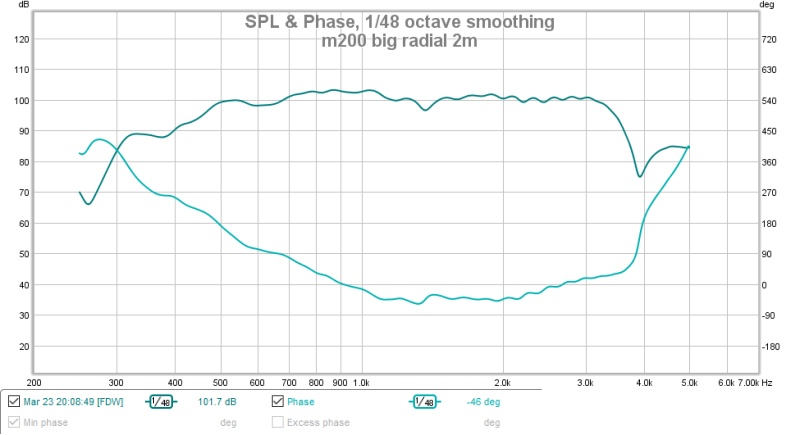

You could stretch the M200 out that far but you will have a deep dip in the response centered around 4K. I have done this - it doesn't sound bad (not a peak a dip) but it doesn't sound right either. I like to cross over below 3.5K or above 7K, in between is kinda hairy with horns. A good 1" driver is much better than a good larger mid/large format driver 3K up.

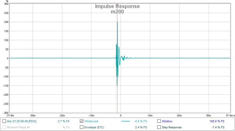

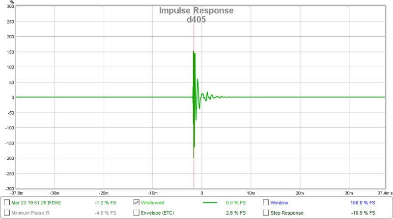

community m200 vs selenium d405ti
both these drivers have outstanding midrange sound, the m200 has something in the sound that seems unrelated to frequency response that is more more realistic. an incredible amount of SNAP or life.could it be the more linear phase 😕
what i mean by better is with a good horn system that is tuned in the sound from the recording can almost scare you. by scare you i mean you actually hear real sound that is not artificial - it canbe stunning when you are used to listening to regular hifi playback both these can do this but the m200 is very consistent to the point the mind adapts to the real sound -

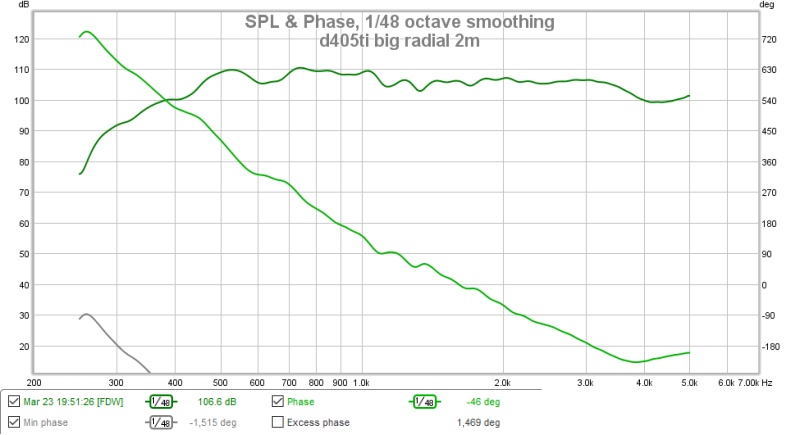

2 meters away in the brh90 big radial horns

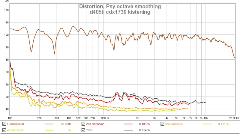

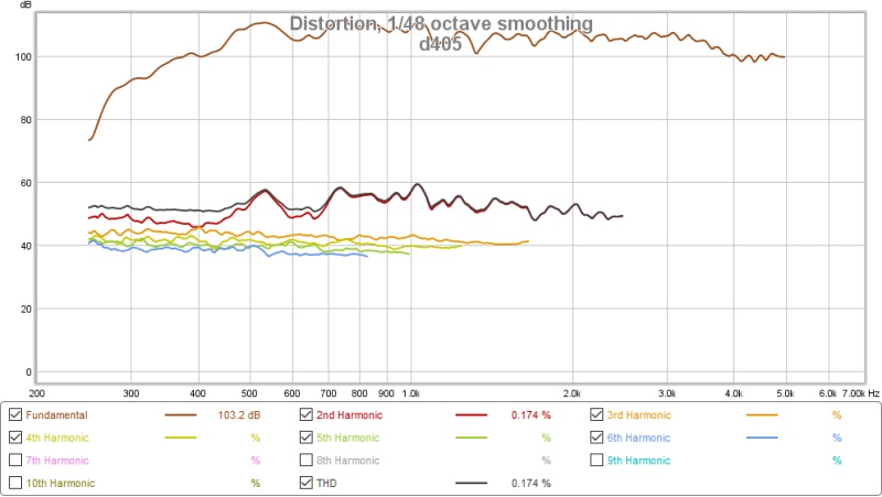

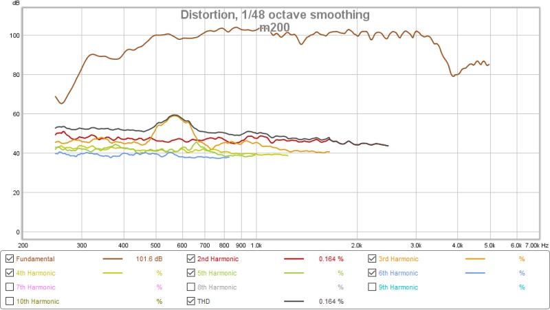

re: your recent measurements. The d450ti 'looks' like it would be the better driver, but you've mentioned quite a few times how much you enjoy the m200's sound.
Would be interesting to try and better qualify/quantify the measurable differences that lean your preference one way or another. Obviously, haha.
exactly - i'm trying to figure this out - this thread is basically me thinking out loud lol
i really like the d405ti, it's debatable so i shared this - i have been going back and forth with these drivers for a couple of years now. the d405 is much wider bandwith but like all the other 2 inch drivers i have just doesn't sound as good as a good one inch above 3k

I've had the same experience, though more limited. I had JBL 2445's on 2350horns ~550hz - ~3200hz, iirc. Above that I had DE250 on RCF HF101 horn. Both were above some built by me Inlow sound 135hz mid-bass horns with 8pe21's. That was an awesome combo.
I tried to run the 2445/2350 combo out to 6k, but it just didn't work for me at all, once I landed around 3000hz I was much happier.

i have the jbl 2350 and have to say these community horns are better. the 2350 is pretty bad above 3k like you say where these are actually much better in that respect. plus they load the bottom better.
if you take some convoluted open cell foam like the gedlee guy uses uses and put it in the throat of the 2350 they clean up quite a bit. that throat is the problem

I say 700 hz because it only loads the m200 driver that low. It is rolling off at 700, it will not be linear below 700 hz. I see people measure horns here all the time at 3 feet, a meter, a foot, at the mouth-- too close! It needs to be measured at least 6 feet out to know how low the bottom range will work - as far as power handling and your amps you could probably drive the m200 down to 100 hz lol
