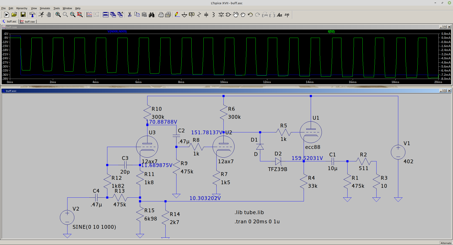

As to the mute... a lot depends on what you connect it to tbh. If it's going to another valve stage then there should be no problems.
If its going to a solid state amp then it still shouldn't really matter but I would advise against connecting leads with it powered up. The 10uF output coupling cap and just the 475k resistor to ground mean that a substantial voltage spike could occur under certain conditions.

I think if you never use the mute circuit all will be OK. Its a very nice circuit topology very low distortion - well thought out. However I suspect there was a leakage issue with the 1n914 and somebody changed it for a jfet not realising the problem this would cause.
I've put a zener and (back diode) to mimic the breakdown of the JFET. As you can see over 5ma flows through at 40v which will quickly destroy it. Mooly I put a .asc in a previous post if you want the try this. So the design I think is flawed, and I would personally make changes to stop this happening again. I would also speak to the guys selling the unit.
Thanks... the .asc called 'buf'?
I tried it quickly on my sim and agree that under certain conditions (very high signal levels) you could exceed the FET's breakdown voltage... so it isn;t a great aspect of the design I suspect.

Yep the collapse of negative feedback makes the problem rather worse driving V5 into hard conduction.
