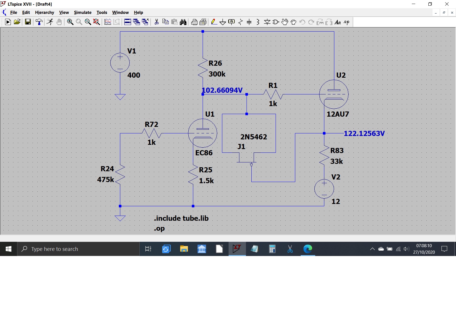

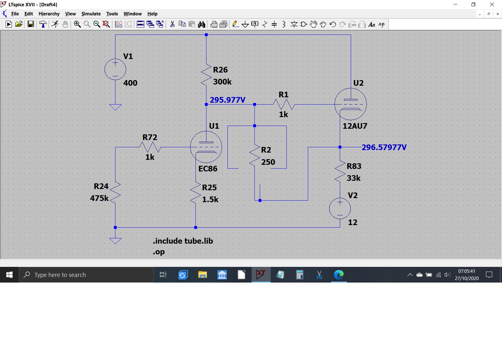

I've just had a play around with that stage as a simulation and this is the result. You can see that the FET itself makes no difference to the DC voltages when operating normally.
If we place a resistor across the FET then the voltages obviously change as shown.
The valves used are the closest I could guess at for a sim and the the exact types used do make quite a difference to the voltages although the voltaages all track 'in proportion' with different devices.
Edit... that's better. First image was wrong, I changed the sim but didn't re-run. All good now.
So with, without and with resistor:

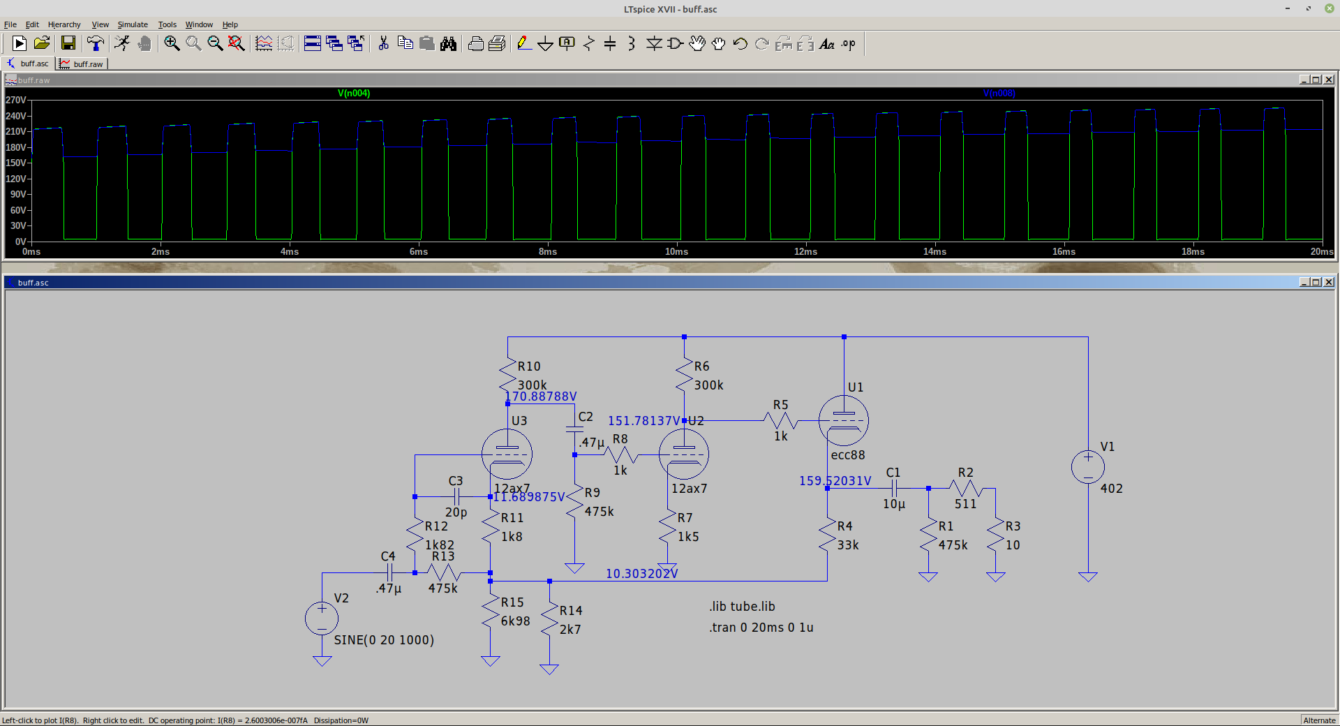

Ok so with the output mute relay shorted and a large signal driving the JFET can end up with 150V of reverse voltage. The plots are the grid and the cathode of the ECC88. This is almost certainly the reason why they blow. Maybe audio research should be made aware of the issue.
I would replace the JFET with something like a 1n485b low leakage 200V and a series 10k resistor. I notice their previous schematic was using 1n914 rather than the jfet.
