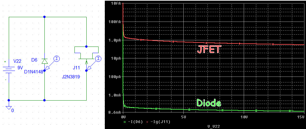

No idea why they are using a FET as a junction diode.
Lower leakage current.
1N914 et al are doped for good conduction and low (not ultra-low) leakage.
The ONLY point of a JFET (for many users) is that SUPER-low input current, so they dope for low-low-low current.
The JFET diode was well-known to 1990s sample/hold builders.
Whether it may be good or bad here, I can't say. Thousands of amps have been built without grid protection, and many serve well. However the tube used here is one of the more sensitive. We could also wonder if the low-low back current is needed here, if a 1N914/4148 could really be heard. Not by me, but by somebody?

Before any tube warms up, the 300k RL of the second tube drives B+ through the JFET, to the cathode of the 6DJ8. The Cathode is returned by 3 more resistors in series, a 33k, and 2.7k in parallel with 6.78k, to ground.
If B+ comes up before the second tube conducts, the forward Gate current might exceed its safe level.
A Pico-amp JFET gate is very sensitive.
Check out the safe gate current for that exact JFET type.
I bet pico-amp JFET gates are Very sensitive to static charges.

Well the 2N5462 is rated for 10mA forward gate current,
But it is only rated for 40V in reverse.
Is there anything that the circuit can do to exceed the 40V reverse?
Either in the case of the circuit working properly?
Perhaps a power on transient.

If there is Reverse Current that causes gate to source/drain to exceed 40V, the current times the voltage might damage the gate.
10mA
Forward conduction:
0.6V x 10mA = 6mW in the gate
1mA
Reverse conduction:
40V x 1 mA = 40mW.
40mW will not destroy a JFET Channel (Source to Drain).
But 40mW Might destroy a gate.
Has it been determined for sure that the JFETs were destroyed, or not?
Both the gate current, and the reverse voltage ratings, of the 2N5460 and the 2N5462 are the same.

Yep if the output is loaded and the stage is over driven the grid of the cathode follower could be drive very negative wrt to cathode and put more than 40v across the JFET. The NF will make matters worse here. I think you said the JFET was reading 250R so destroyed. Think I would be placing a 10k in series with the gate of the FET.
