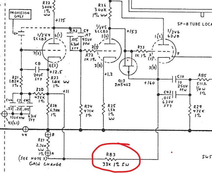

Have you checked the cathode resistor of V6 and other associated parts and connectivity of those parts. Wouldn't a an open circuit R83 or open or high resistance path here cause the cathode to assume a high voltage and hence transfer that via the FET to the anode of V5?
Given that V4 anode volts is correct I'm assuming the cathode voltage is also correct which is shown as around 12 volts on the diagram.
The 1k grid resistors see no voltage across them and are far to low in value to have any concerns over noise contribution or other qualities. Any 1k of similar physical size. Manual says 0.6w which is a standard small rating. 0.25w would be fine as well as no power is dissipated here.

I have measured R83 in circuit and it's 32.5K on the RHS and 30.5 on the LHS.
I am only using logic and measurements in situ before unsoldering everything, but the R27 2.7K is 1.95k on both sides and for the life of me I can't find R28...but it's all a bit of a mystery to me!!
These were the voltages on this resistor, can't recall which side I tested
33k 12v RH
33k 21v LH
Thanks!

I would measure the voltage from ground to each end of R83. On the faulty channel you mentioned having 350v on the 'single leg of the FET' which is the gate and which goes to the cathode of V6.
So the 350 volts you measured should be present on one end of R83.
You must check the voltage on the other end of R83. What is it? It should be around 12 volts.
You have to check resistors out of circuit but you only need lift one end to do this, no need to totally remove.
Also...
The stage around V5 is self contained and self biased.
If you remove the FET and remove V6 (diagram shows V6 heaters are not in a chain so no problem doing this) then the anode of V5 should bias up to the correct voltage.
If it doesn't and it is still high then you next remove the 1k grid resistor in case the valve socket of V6 is electrically leaky/carbonised and there is a conduction path there.
If the voltage on V5 anode is then normal after lifting the 1k then you are looking at leakage around the socket of V6 and/or the board/wiring itself.

Quick and dirty checks (beware shock hazard) are to see if a resistor with lots of voltage across it is getting hot. If you have 300 volts across a 33k its going to be hot. So if it is much hotter than the one with only 150 volts or so across it then chances are it is OK.

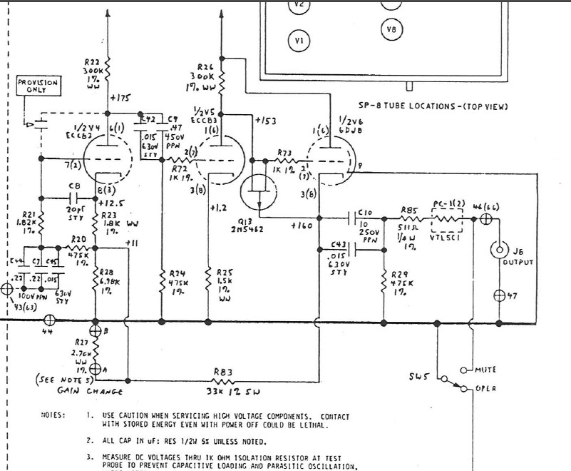

Lets just recap on what should happen. Concentrate on one channel at a time otherwise it gets really confusing. Lets build it up in stages.
V5 is self contained and self biased. If you remove the FET and remove V6 then the stage should bias up to the voltages shown give or take. So that is the starting point. You need to see around 150 volts on the anode of V5 in this initial state.
Lets try and cover all bases here. Is it possible there is a problem with the (to me) under rated coupling cap C10 (and lets not discount the parallel C43)?
Lets isolate these two caps and leave them isolated until the thing is fixed 🙂
The reasoning for that is that if the switch SW5 is in 'mute' and if there is leakage in one of those caps then that would tend to pull the cathode volts down and upset the whole chain.
So lets take them out of the equation and isolate them.
V6 is just a buffer stage. Having got the correct voltage on V5 anode (150v or so) then V6 when placed back in circuit should bias up to the voltage shown. The anode volts of V5 should appear on the grid of V6. I would suggest leaving the FET out of circuit while doing this.
The cathode of V6 should be as shown at around 160v.
Try following that 🙂 and that and see where we get to.

Did I miss something?
The schematic in Post # 35.
The JFET is drawn as a P-Channel JFET.
An N-Channel JFET, would have to be connected the other way, with the gate to the grid stopper . . .
The only reason for the JFET to be connected from the grid stopper resistor to the cathode is to prevent the grid from going more than about 0.6V positive than the Cathode.
That JFET is nothing more than a Diode when connected that way.
A Common Signal Diode would provide the same protection, but would have Much Less capacitance when at 0V or less (reverse biased).
And, for normal operation, the JFET and signal diode will be working from 0V to reversed bias voltages.
The higher capacitance of the JFET (compared to the signal diode), could cause high frequency roll-off.
Simple . . . signal diodes are less expensive, lower capacitance, and usually higher reverse voltage breakdown than a JFET.
Use the solid state device of your choice, but make the choice when you understand the tradeoffs.
Hint: make sure that both the Drain and the Source are connected together. And the Gate to the other point of the circuit.

so the plan is I will remove FET on LH channel again, put in V6 and power up and test voltages? The part that confuses is me is what I do with the capacitors C10 and C43 in this trial as I am not sure what isolating these actually means - just disconnect on one end?
If I do this then how do I get output across to R29/
