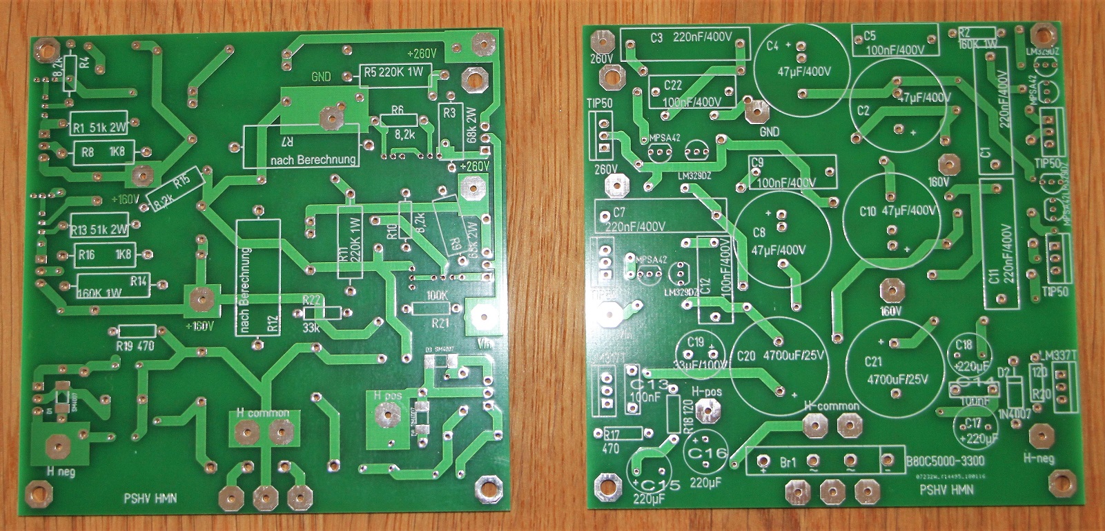

Are there PCB's of this project for sale? I'd like do buy a complete set - mainboard + PS.

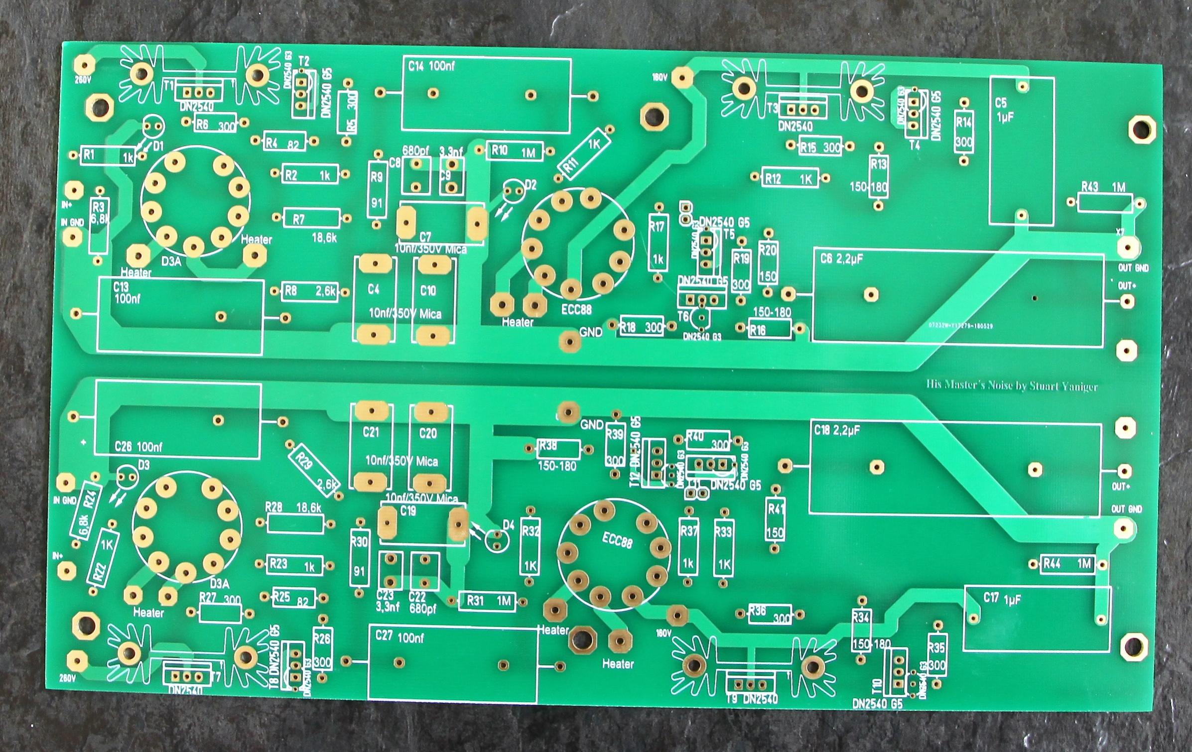

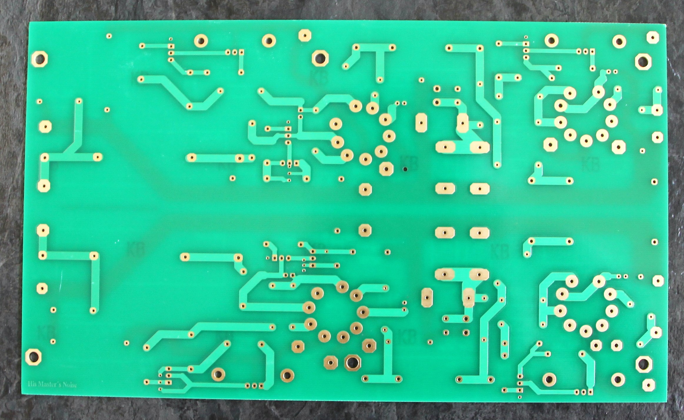

Cause much people are interested in this project, i will post some hints for a faster building of the amp.
- the load resistor R1 is 6,8K. It had to be calculated carefully. The sound of my set up was awful. I changed to 56k and the sound changed to clear and marvelous.
- if using the D3a, use for R7 18,7k (1% tolerance) and 34nf (if possible 1% tolerance). Use for R8 2,61k. So you match the RiAA-line near perfect. You have a difference of 0,5dB at 20kHz.
- the current defining resistors with 120 and 300 Ohm are to large. I builded in the meanwhile 5 Boards for friends and me. I used for my DN2540 (in Europe bought) this solution:
Use for the first stage R5 between 68 and 82 Ohm. That gives me 20mA. In most times 82 Ohm matches 20mA.
For the second stage R14 and the cathode follower R18 use 150 to 180 Ohm.
- for a cheaper building you can use the T092 Version of DN2540 (G3) for Q1, Q3, Q5 and Q6.
- Sy used a red led for biasing the second stage. I found no red led with a correlating forward voltage. I used yellow leds. But a higher bias is no problem. The bias point is a little suspended.

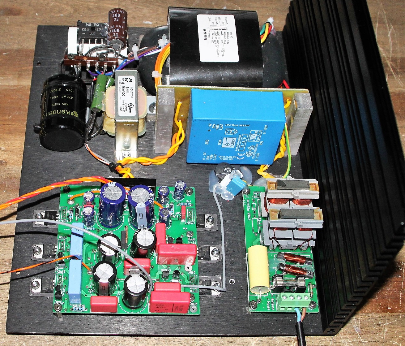

Ha, that looks so different to mine! I think Im probably going to replace my transformers with some torroidys, (i know it says not to use torroidal, but they seem to be the best transformers Ive used and they dont hum). Im really not happy with the one i got made. You found some r cores by the looks of things, Where did you get those?

If somebody wants a R-Core-Transformer; absolutely no noise:
