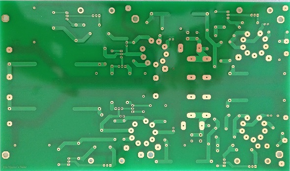

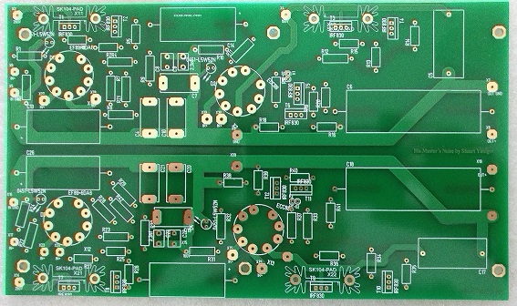

Hi freecrowder,
there are some boards available; PS and Mainboard.
send me an PN, please.
regards Frank
regards Frank

Board
May I buy a set from you?
