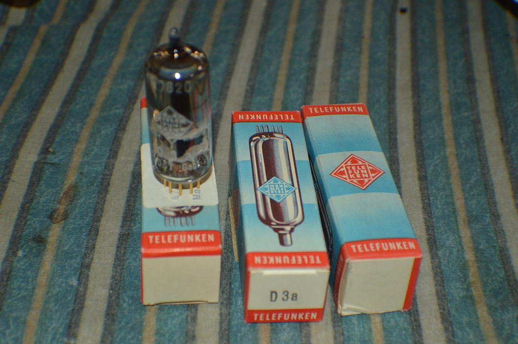

I got 4 on Ebay from a seller in Germany, $100. He wanted more but I gave him a best offer of $100 and he took it. Arrived in fine condition.
That sounds like a good deal, not like $100 for just one tube from the Tube Depot website.

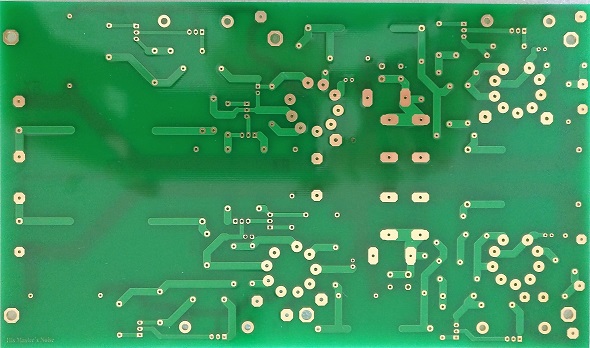

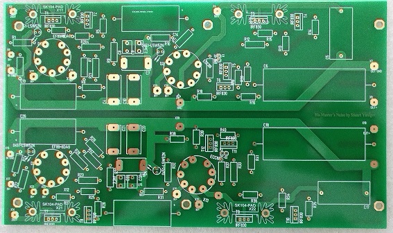

Boards are $3.00 shipping to Portugal probably $9 or $12. It depends on which clerk at the post office

Are the boards just for the audio circuit?
Do you have a photo of the boards?
And maybe assembled board?
How did the tests turn out?
Luis

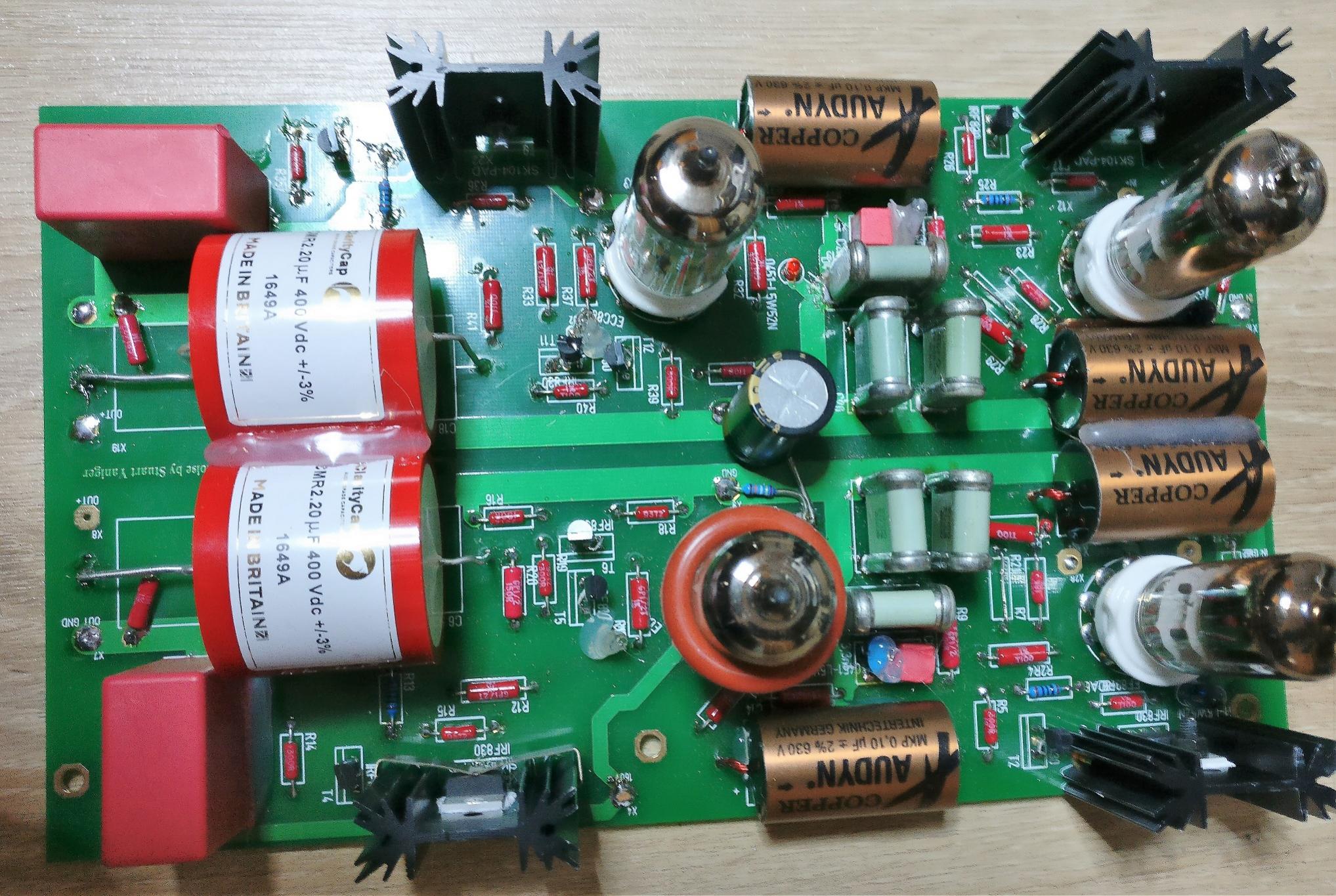

Hi Luis,
to trim the RiAA you have to use the complete first stage, cause the Resistor (i think Ri) is part of the RIAA network. Read Sy´s explanation carefully. Its very helpful.
Myself i used measured and matched 10nf Mica East-Europe. My RIAA-network matched with 3 x 10nf Mica, 3,3 nf Wima FKP2 and 680 pf and 20,7K as R7.
Mica caps are great, I find them very neutral. Did you do your own board? It looks like the board was made with the 3 parallel Mica + FKP2 designed into the board.
I love that you have space for the big axial caps too.
Jac
Hi Jac,
the Micas are great. I made this board first for mounting in my Hovland HP100. As I developed the board, i made sure that there is place for different capacitors and for the Micas I owned. The best is, the most russian or east-european Micas have a tolerance from 0,5 to max 1 percent. Now is the hovland sold and i have to build a case for the noise-machine.
I build a second board (this is sold) so i bought 100pcs 10nf Micas (matched). Fortunately they match the place on the board.
