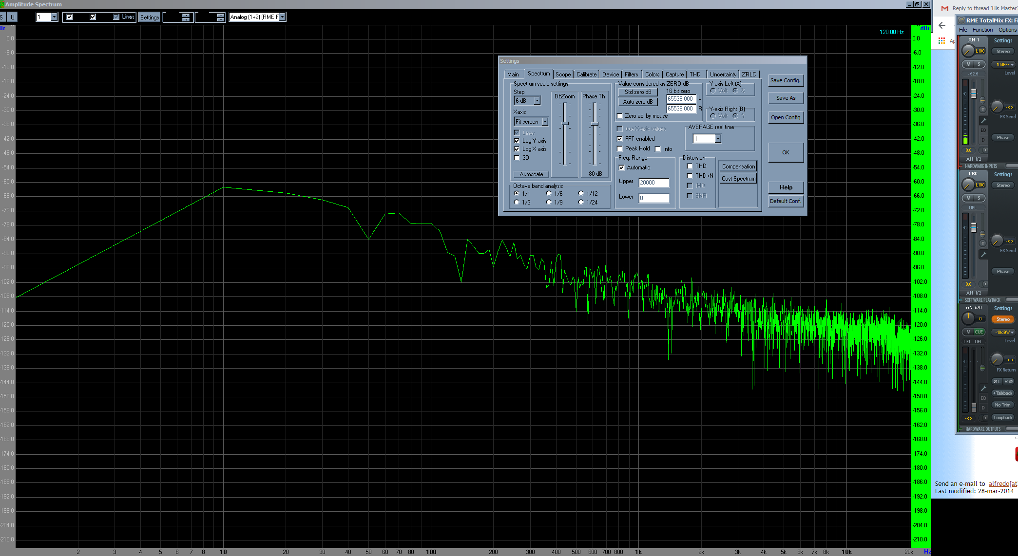

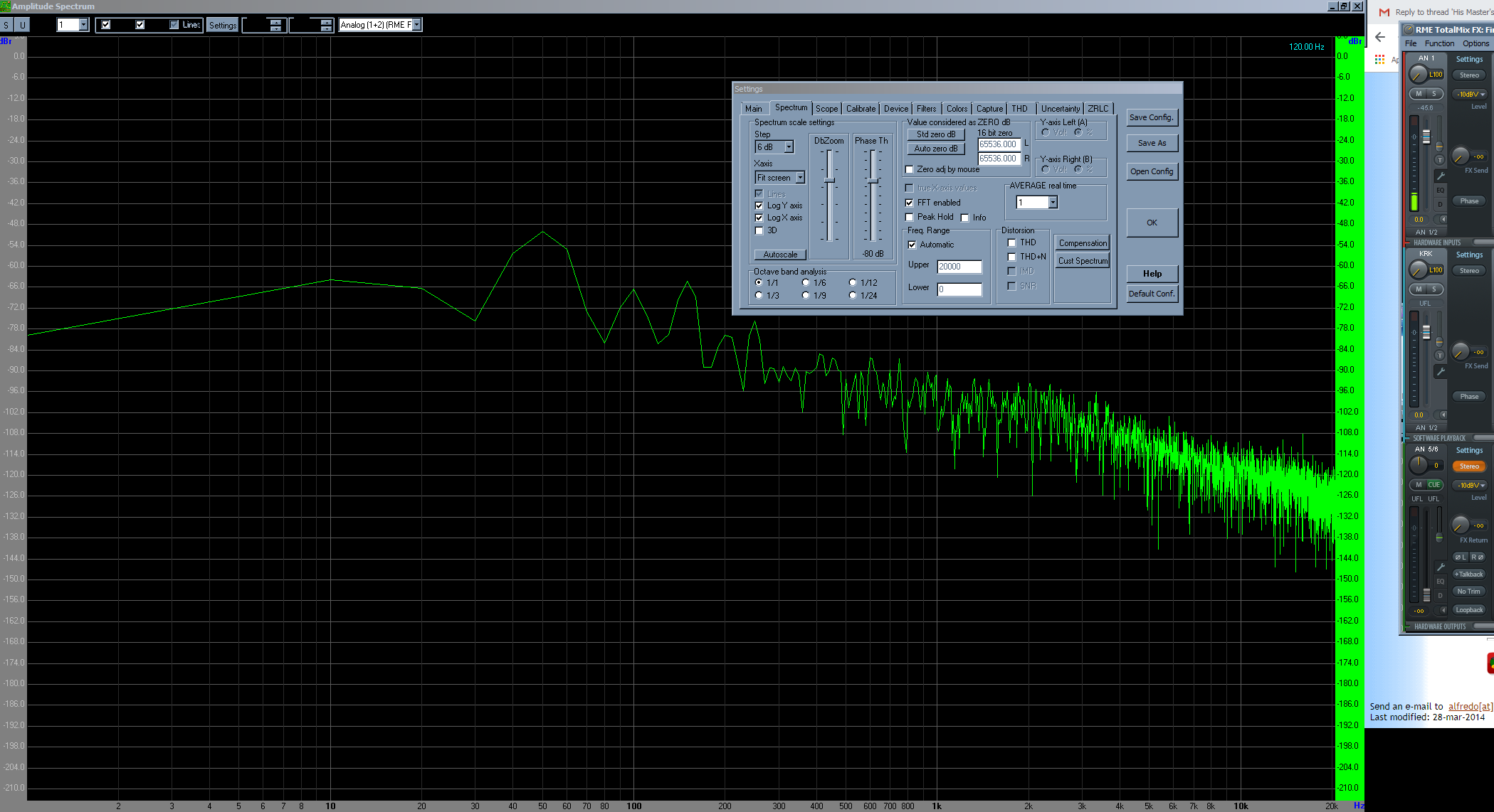

Hmm, I have an rme ufx but I suspect the running noise on this preamp would be similar to the running noise on the ufx. What software you using, I'll give it a go.
It is called "visual analyser 2011" in my case 2011, but it appears there is also a new version.
Download
VA Analyser screenshots for his masters noise

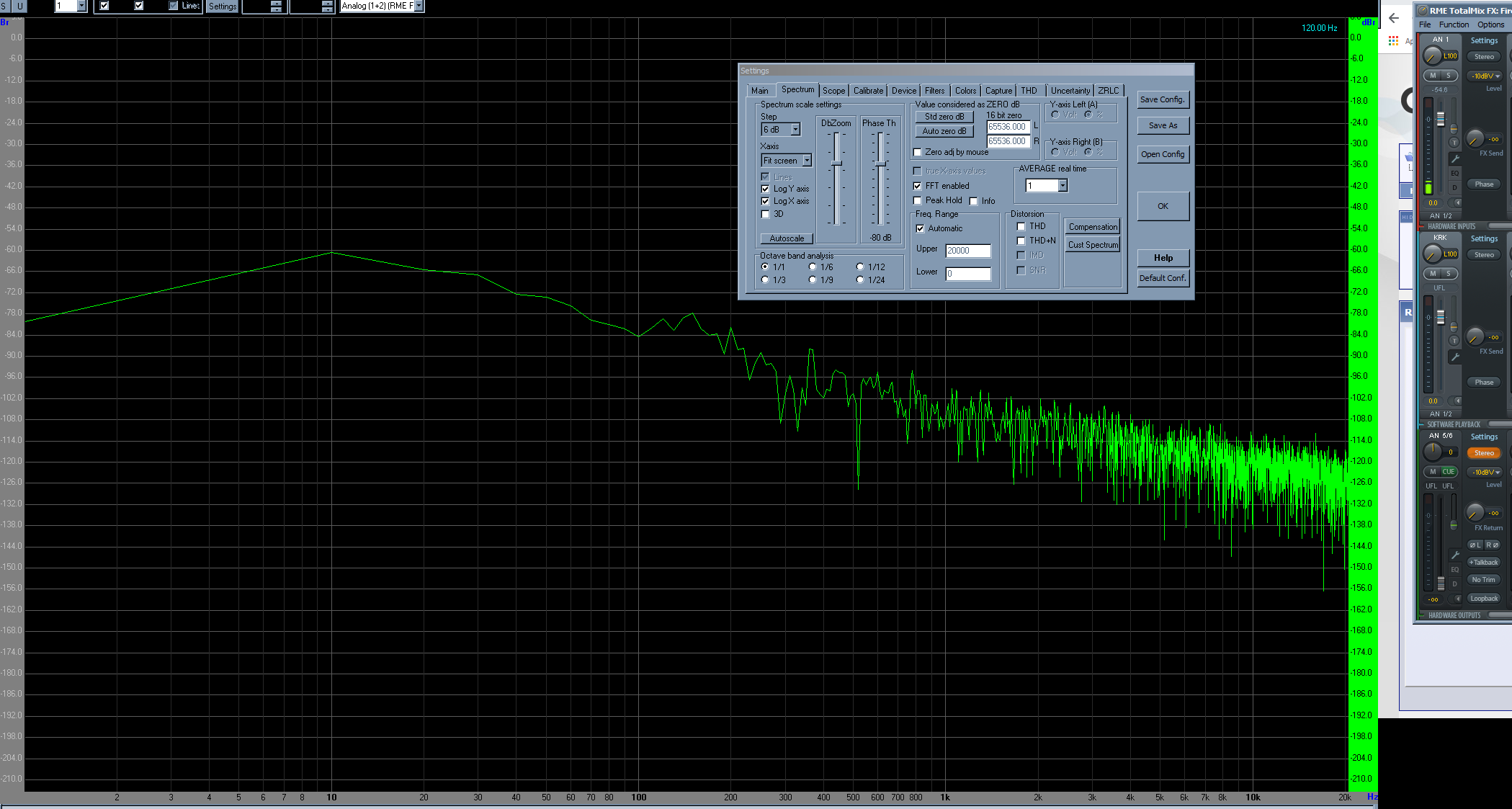

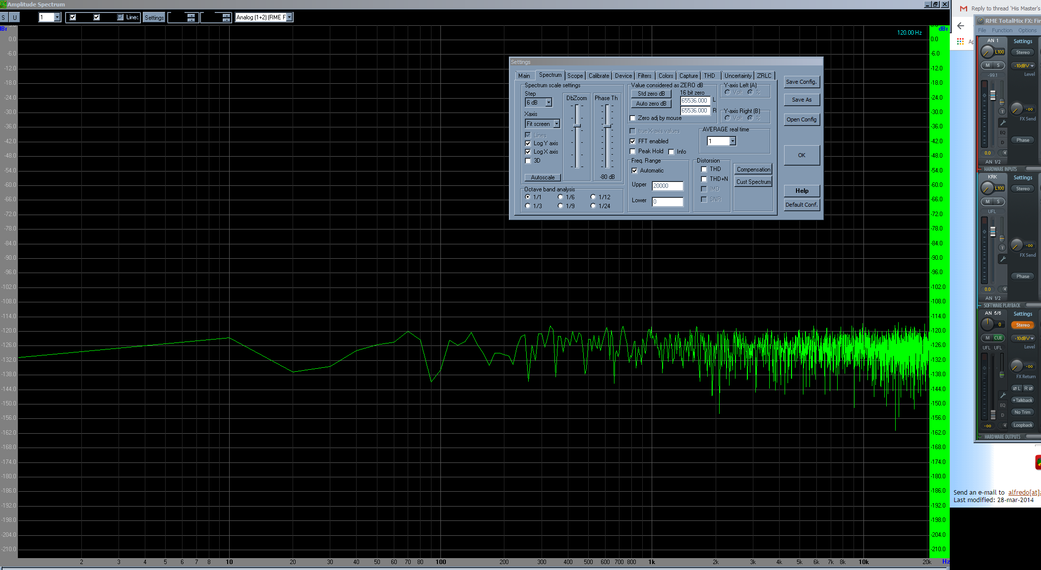

Hi, Im not sure if ive done quite what youve asked for but its my best guess.
I have done 4 shots
1. soundcard input with nothing connected.
2. HMN connected with open input
3. HMN with a shorted inputs.
4. shorted input to ground.
I realised that i needed to short to ground as the inputs on mine are balanced. Shot 3 i had shorted hot and cold input together and not to ground!
Hope this helps.
D.

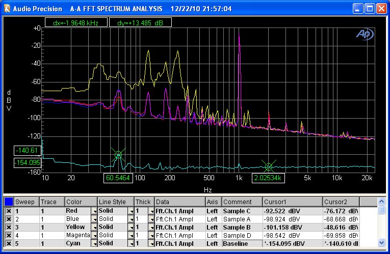

Thanks a lot!
Very similar data!
For me it's ultra critical having horn loudspeakers of 100+ dB/W and eventhough the S/N was ok, I had to push it further down.
I worked more than a week on this, including fine-tuning the RIAA curve.
With the trade-off of less overall gain, probably rducing the high CCS impedance but increasing 50/60Hz noise control (but still sufficient gain)...the noise spectrum got a lot flatter (including the 50/60Hz region going towards -90/100dB).
I will share what I did and why (for everyone to choose if they want to use it at own risk/need)

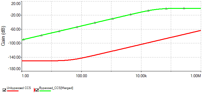

So, checked my notes for my mods:
CCS2: Bypassed with 4.7uF (S/N better especially in mains freq range)
D2: Bypassed with 3.3uF (S/N better especially in mains freq range)
R10: Parallel resistor 47K (since the 1M was om the back of the PCB), After CCS mods, got extra level in low freq of RIAA (several dB's) and could not be balanced back to the rest of the RIAA curve by only adjusting R7/R8/C2, so I needed to lower the low-pass F3 and could approach it by changing C3 or R10. Since I wanted to lower noise as well and want to keep impedances as low as possible R10 was choosen to get the low RIAA back on track)
R7: 19k7
R8: 3k
C2: 34nF
R1: 56k (matching my Benz Wood)
Transformer: Lundahl LL1931 (1:16)
Played a bit with a zobel (16k2+3.08 nF) on the secondary but left it out for now (maybe further investigation later)
Checked the RIAA with Dr Feickert Adjust+, sine generator/Oscilloscope and the spectrum with the visual analyzer.
Driving the pre-amp with a 22k to 10Ohm attenuator.
Arno
