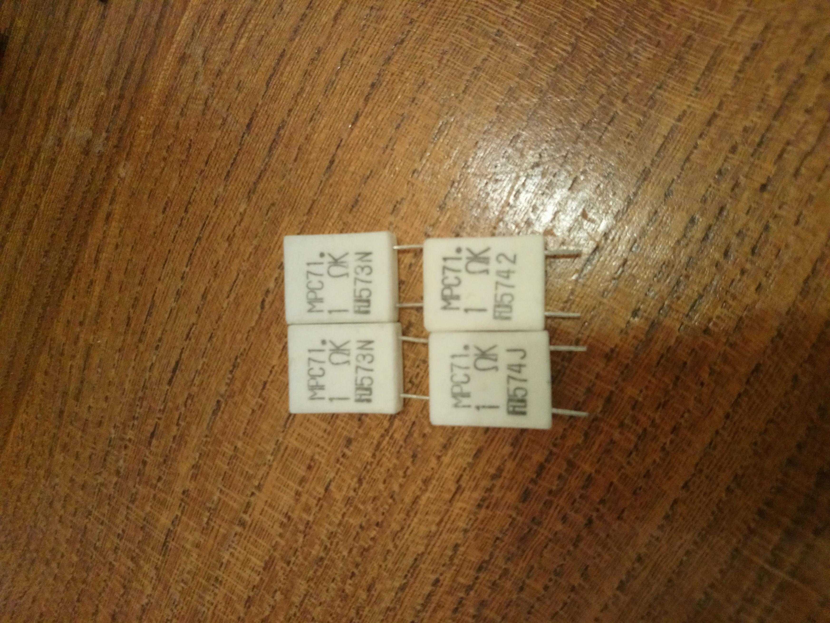

Is not possible to put together your heatsinks to create some type of tunnel for your fan, that way would be much more effective. You can buy 5W metal film resistors and carbon films also.
I would buy 2R and use 2PC to get 1R 10W. Did you ever tried plate resistors like KOA etc. to me those acceptable also.

I tell you what you guys, this made such a difference. It felt so much easier to set the bias and dc offset up, infact i was able to get both NPN and PNP to match in bias.
Cant believe the difference changing the type of resistor made.

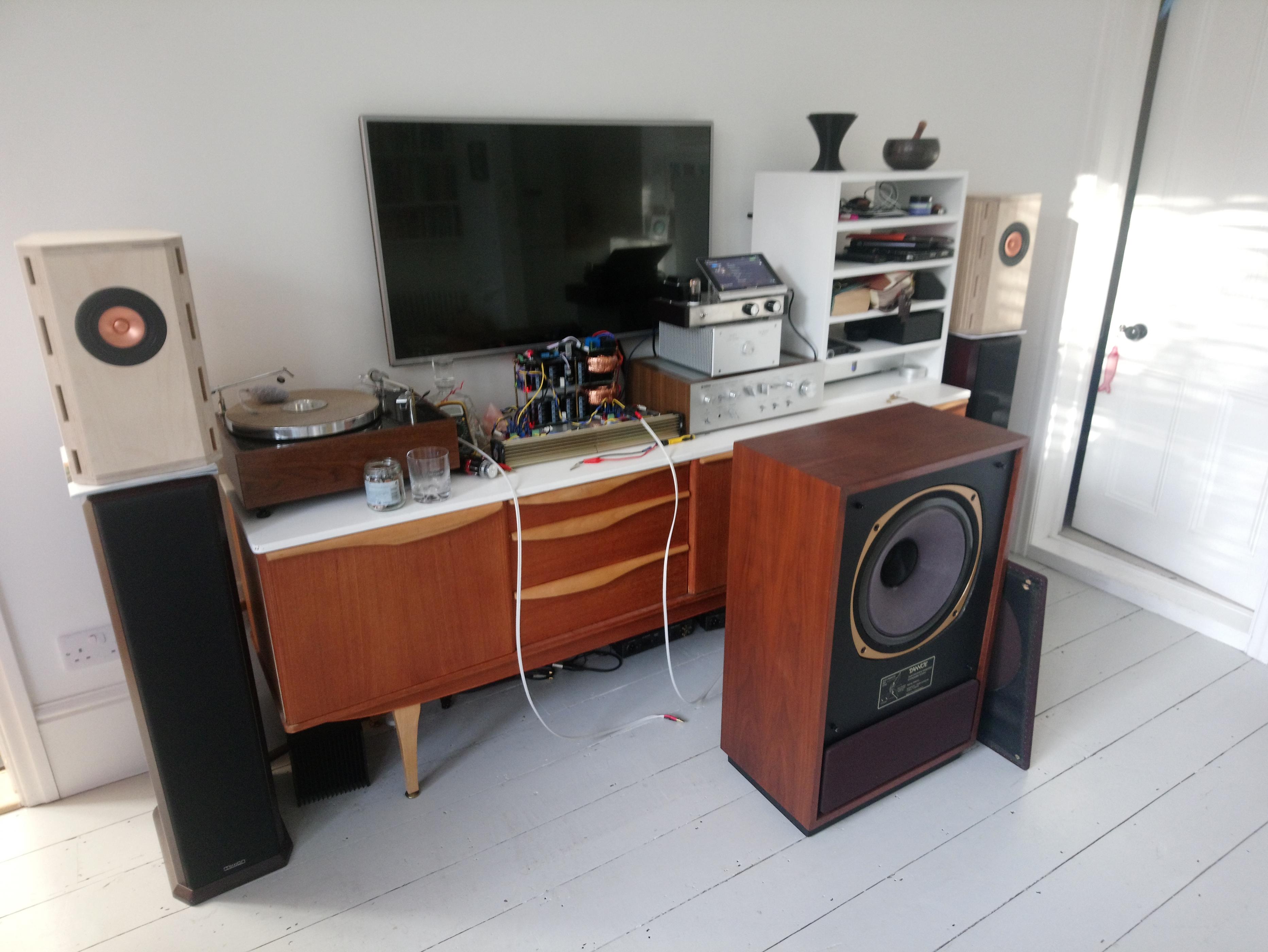

What a good day it was for testing, i was really able to put these amplifiers through their paces and they did not disappoint.
Ill keep it quick and simple.
Preamps:
Yamaha ca-600 (i like the mode function where it joins the Left and Right signals together so the preamp outputs share both signals) . This allowed me to test one amplifier at a time but getting both L/R signals coming through.
Diy Marantz 7 circuit Tube Preamp
Speakers:
Planet 10 onkens with MA alpair 7.3
Tannoy Berkeleys (i was very surprised how good it sounded with these amps)
Things really came alive when i used the big tannoys it gave a good impression of how well the amp performed and how the transistors used sounded.

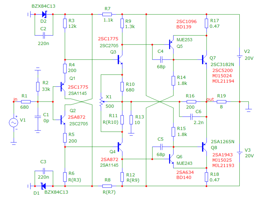

Amplifer 1:
The MJL21193+MJL21194
Amplifer 2:
NJW0302G+NJW0281G
Both Amps were tested at 0.6A and 0.7A, allowed to be fully warmed and stable, i didn't want let the rail voltages drop below 16V. I will may 1A just to listen and test more, my thought was to eventually try and get a stable bias where my PSU you can handle the load and i get good measurements from my scope. I mean i tried 1.5A and it sounded strong, further tests showed no benefits cons were HEAT,PSU having a hard time and bad rms value tests from my scope. Just using 0.6 - 1A tests better for my current setup which is fine.

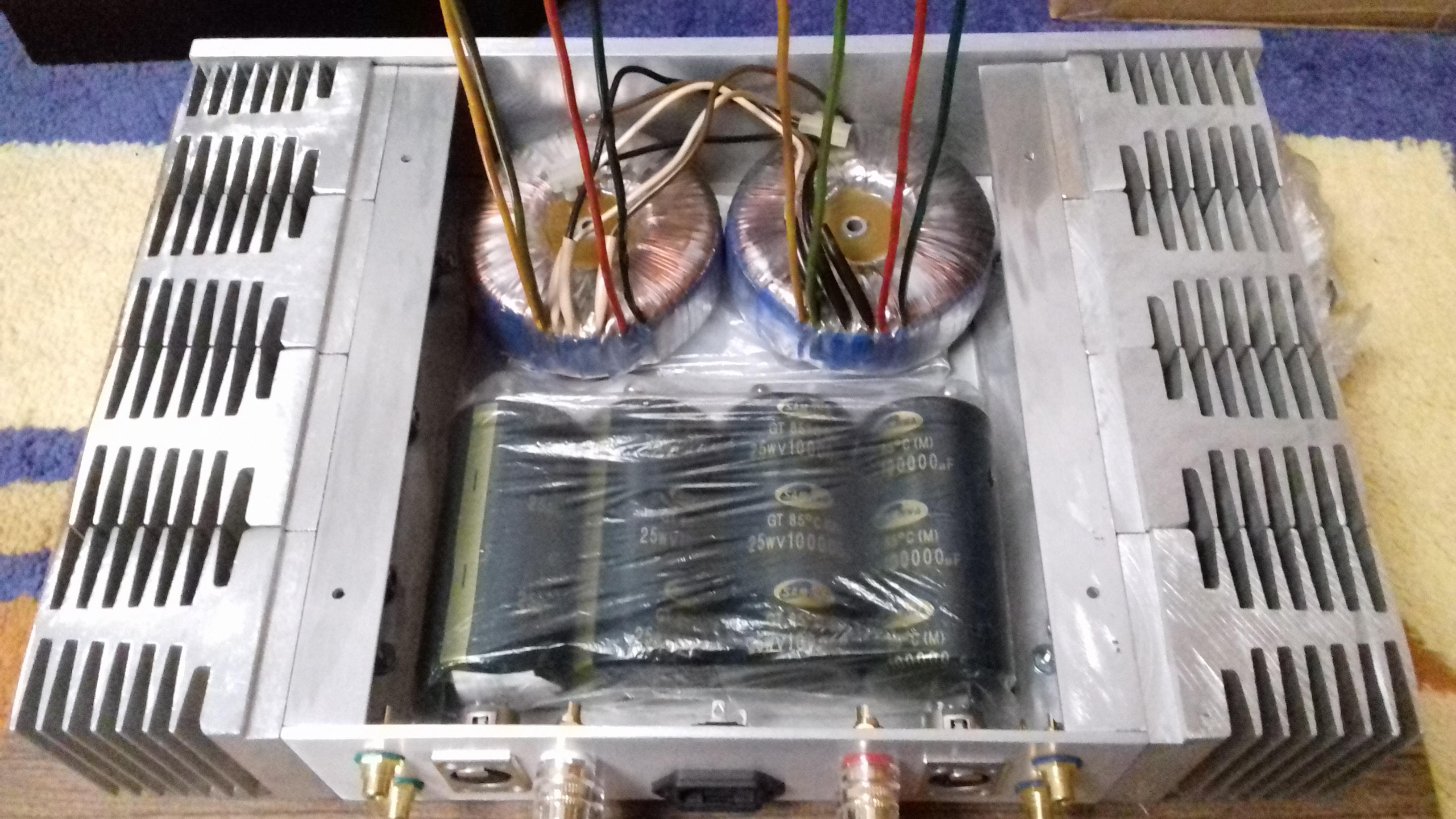

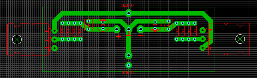

Hi Vishal,
You may have seen the below photo of my amp (Jean Hiraga 30 Watts) It was a complete DIY right from the PCB's to the Enclosure.
LR4B6UXbhw5nVNwaWaCx0tZbea3H4qTzR6N7z5T4fNVGon1vOGT8aqacmOZGWZ5SvBH9WB4w5YDbtup73X_SB3U9ZD4eHaovFC0MuFie8HqitmT1-fABMx0bXU0vkb3AeGjIqSb8XaHc3iNQz-qNcdp0JYS0uHOcsJkvCx6BjDHESdrNgfzF2iH3d-fpHg5rclVNxgSV6ew9IFcCyCK1CyToYBuY6_gc5tIWPSG3R1_zj4KtfEUxLQIGubHvIw2vBcdjmcG54PFDNf_MugZPfx3PNVkoiKV-KfD01nU4C_ML2XcpGTKeVSigpwnXp0ZUnC9KVDjrm75jUALKrJtI16SEZFdB99QL__lNQNU4LBc4a7QuPIEcdpt0zvncKWGYhwvFvNcargk248hFmUV2wy9JpShnoD-xdhYenHhc_Foteoxzjxi_Q0GWsFx8Zht_QO_LFasj0waYTDdy41A_hh-InUknqYjkfnjRVz4z7vEBebzLWd8mq75TAF6XBm8i_j5w4brKiVf0vN7wfJSQtxa2aGfFeJ20b2WupbcdPYcFrqP6LVAjtINj_3BQrFXuHN6_mgX_wqo3jleIDUNdVcIA8KB_kYaygDQ6Mnrpv-Td4ei-ndcqgLXhSDmEKG8=w1160-h870-no
But Now as the time has passed I too have updated my amplifier with Proper PCB's, Power Bank (4,40,000 uf Per Channel) and a Heavy Enclosure (Enclosure is a complete DIY) with More bigger Heat sinks. The Amp PCB's were made as per my layout from a PCB manufacturing company, Soft turn on & Protection PCB's were purchased as a complete assembled kits.
When i shifted to Proper power Bank there was a huge difference in the low frequency. The difference is on the better side, the low frequency is improved a lot the difference is like day & night.
When I was using Cap multiplier the lower notes were blurred and the intensity was very light. (but still it sounded very good in mids and high region)

Belive me this 30 Watter is a Real Monster. And so dose it looks now.
Sadik
Sadik that is wonderful man, i like how you also had the metal work etched something i would like to get done on future projects.
I am in the process myself of finishing my Hiraga Super 30w using Chokes and a big PSU, although i decided to build the le monstre as a test run!

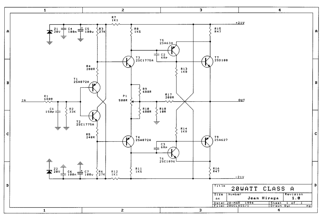

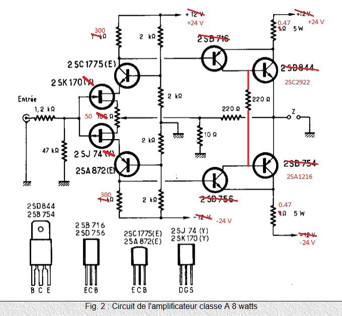

I will do this scheme
That is the modified version of the Hiraga class A.
I am not a fan of the 13V diode on the front, that version.
I built that and never like her at all.
Much more the 20V Zener D type.
Keep all the resistor values, the rail voltage can be lowered, only because I am not sure the type of heatsink you got will take the heat.
May be use 15 or 16VAC transformers.

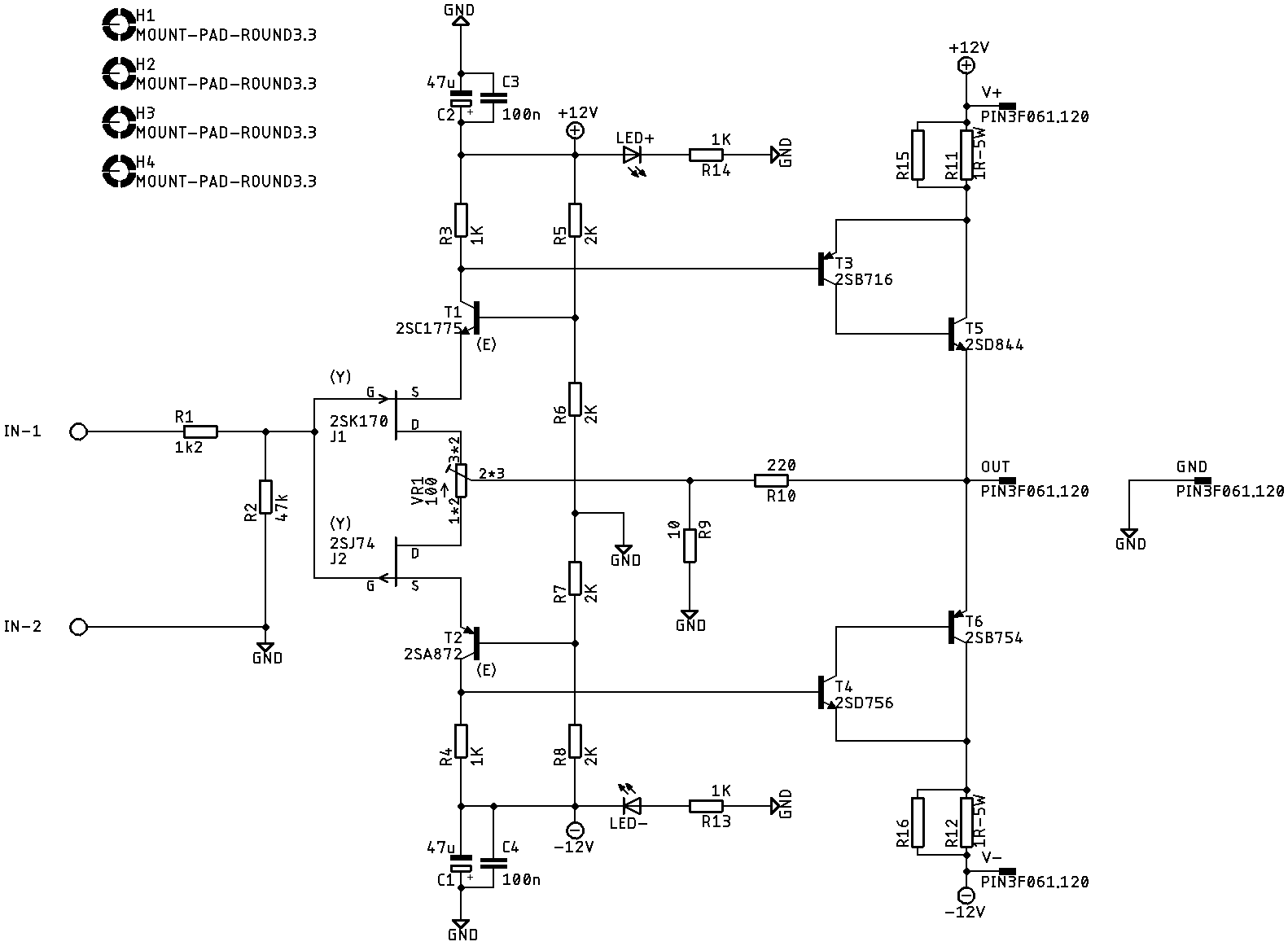

Many years ago (30?) I modified the Hiraga Le Monstre schematic and built a 25 W amplifier. After having moved around a couple of times, I replaced the amplifier with new ones.
Now I have started to go back to this amplifier, following the attached schematic, but not using the pair C2922 and A1216 (I don't remember which drivers I used). I used a 2x18 V tranformer with CRC-filtering giving plus/minus 24 V (no huge power supply).
Have someone tried something like this?

Some findings regarding the JFETs used in "Le Monstre":
The original design uses the JFETs 2SK170Y/2SJ74Y which yield a current of approximately 1.3 mA in the input stage. The voltage drop across the 1 kOhm resistor is 1.3 V and the quiescent current in the output stage becomes 0.6 A. That's the original design and it is simply the best because it provides a substantial voltage gain of 7 in the input stage. Unfortunately these JFETs with IDSS classification Y are almost impossible to get nowadays.
The JFETs 2SK170GR/2SJ74GR yield a current of approximately 2.5 mA in the input stage. In order to maintain the quiescent current of 0.6 A you have to reduce the 1 kOhm resistor to about 520 Ohm. The voltage gain in the input stage drops to 4 (-5 dB).
The new version using the JFETs 2SK246GR/2SJ103GR and a 470 Ohm trim-pot yields a current of approximately 2.7 mA in the input stage. For a quiescent current of 0.6 A a load resistor around 480 Ohm is appropriate. But there's a big problem with these JFETs. The forward transfer admittance is significantly lower and the voltage gain in the input stage only is 1 (-17 dB). Hence the new version clearly is inferior, a loss of 17 dB in open loop gain is way too much IMO.
Conclusion: Go for the original JFETs with the lowest IDSS you can find. They are unrivaled in terms of gain and low noise. They now are produced under the new name 2SJ108 and 2SK370.
