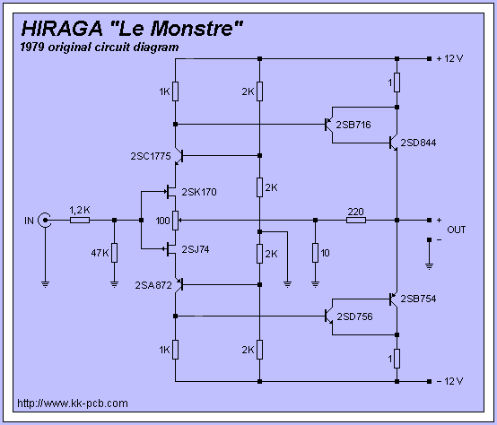

Hmm, so by reducing 10 ohm or increasing 220 ohm in the feedback loop i get more "return power" in the input, is there a downside? witch resistor do you recommend changing and to what value?

I have discussed a bit with a colleague of mine about doubling the value of the 220 ohm resistor. what do you think about that, is there a downside by doing this?

Yes you have halved the feedback and consequently increased the distortion and output impedence. This cannot fail but to have an impact on the overall sound of the amplifier.
Your test speakers are very low sensitivity for this type of amplifier, you should consider using more sensitive speakers as your overall solution. i cannot recommend messing with the feedback.

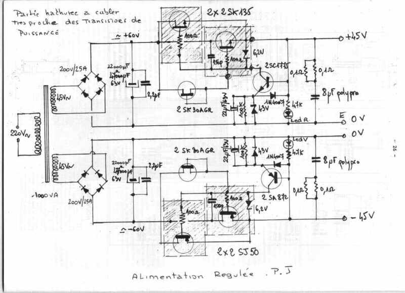

38400μF but the current is not regulated,only rectified...can anyone suggect a regulation scheme?
Your 38400 seems a bit low.
Although the original might be overkill I would suggest experimenting with more.

i wouldnt say its not enough and i doubt higher values have audible effects...but anyway my main concern is the regulation which i dont have right now...

Hi Tasos, please read post #1192 and #1193 the regulation psu and caps multiplier.

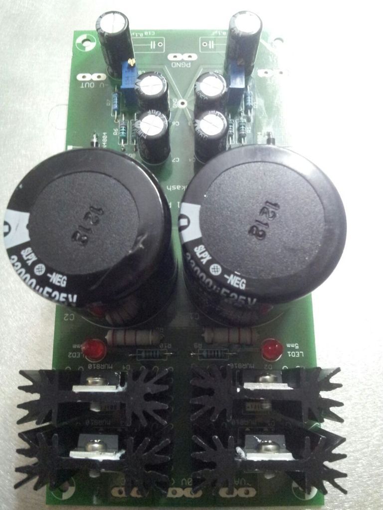

I actually found out that i had R1 and R2 interchanged
Have 2x22000uF Kemet caps per channel.

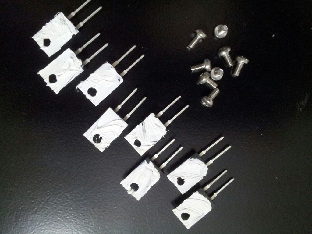

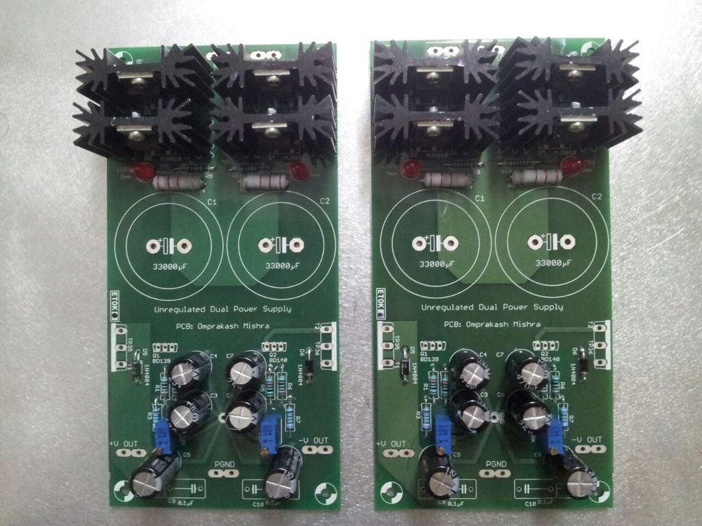

I have got some voltage regulator PCBs for sale. They are professionally designed and built following the schematic wich was introduced with the Kaneda power amp. Currently they are assembled to deliver ~13V at the output but they can be easily adjusted to any voltage. I use them togehter with JIMS audio le monstre PCBs, and they can be perfectly mounted back to back. Send me a PN if you are interested in a pair or two of the boards.
Fake 2SJ74s anyone?
Two weeks ago a asked a "nice" chinese seller (goodtronic) how he insures that his parts were genuine. This is what he answered:
"Sorry... I think this 2sj74 is not very good one... "
The german seller i just got 8 pieces at €4,76 a pop from was not so nice. She asured me that every single FET was checked for authenticity.
Well the 2SJ74s I got used to be J270s in their earlier life...
I am so annoyed - I will have a hard time sleeping tonight.
The hunt for the parts of this amp is highly aggrevating.
Anybody know a good source for 2sj74 at the moment?
Did anybody buy here lately:
Transistor HITACHI 2SJ74-BL - Transistors audio
(Hitachi???)
€3 a piece would be OK if genuine.

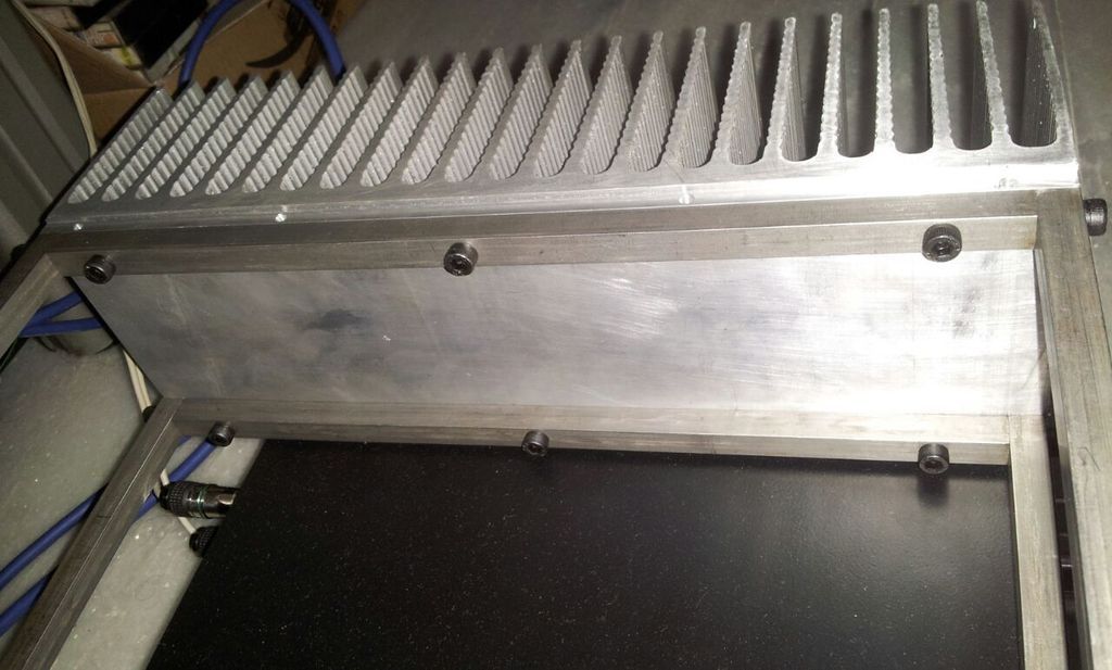

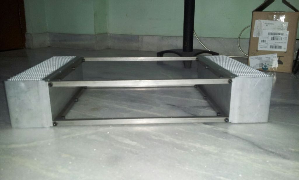

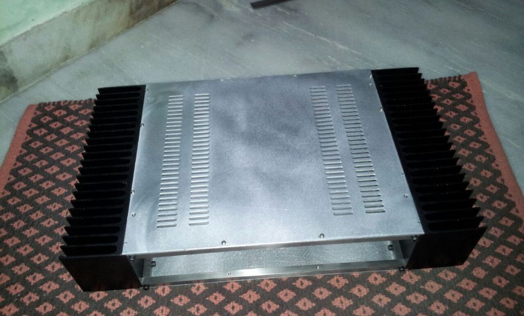

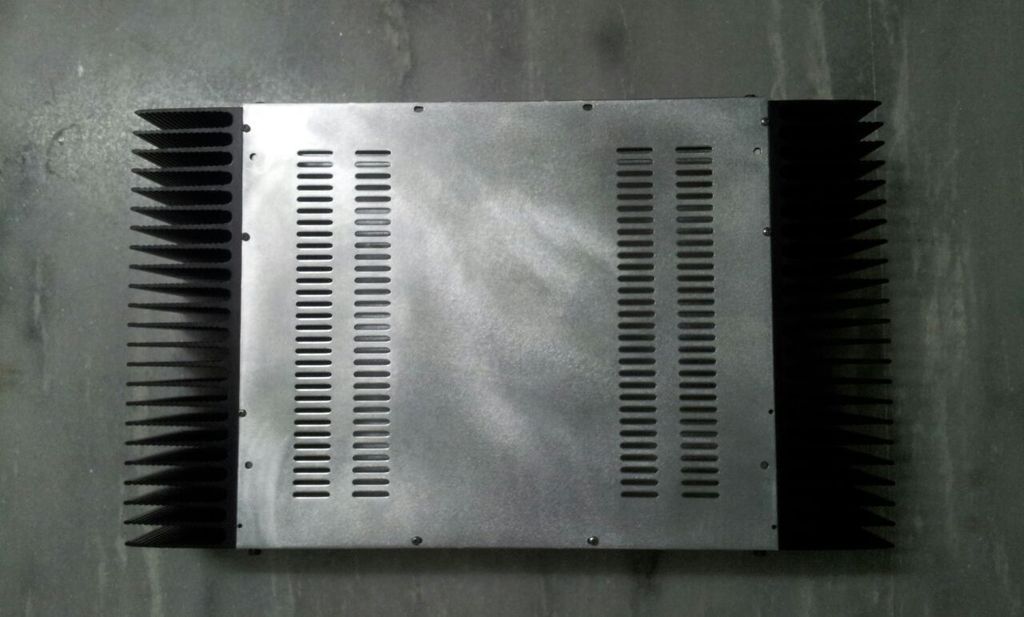

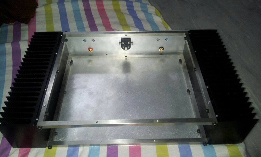

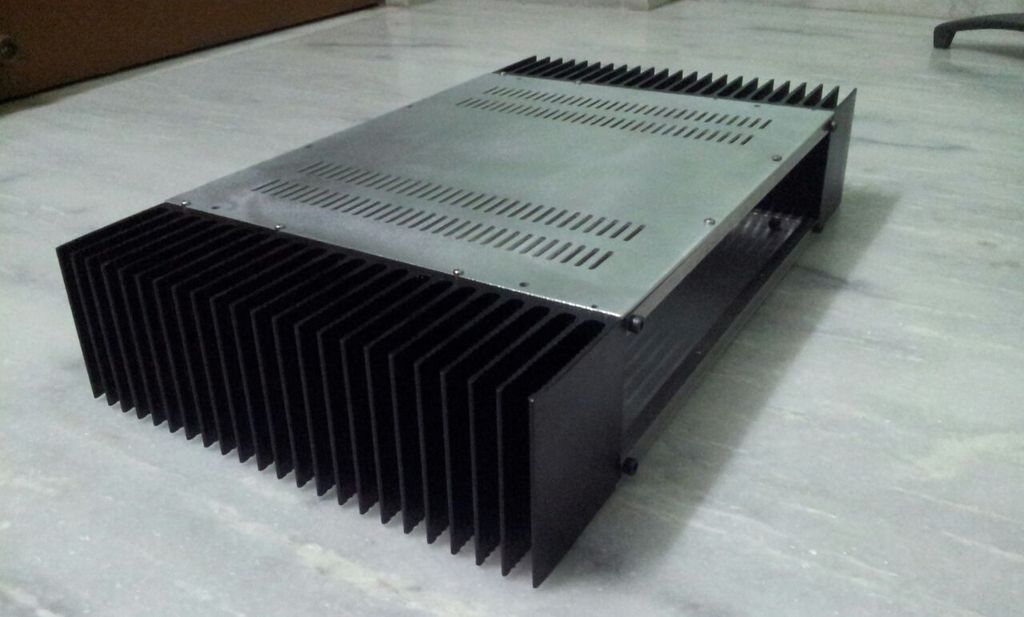

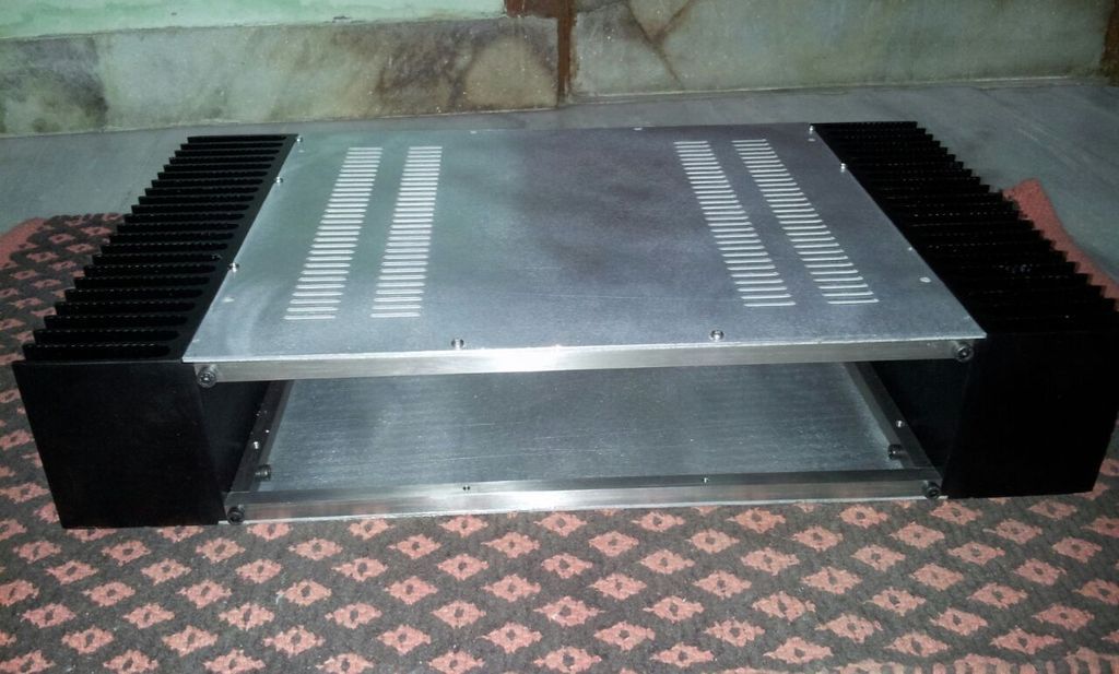

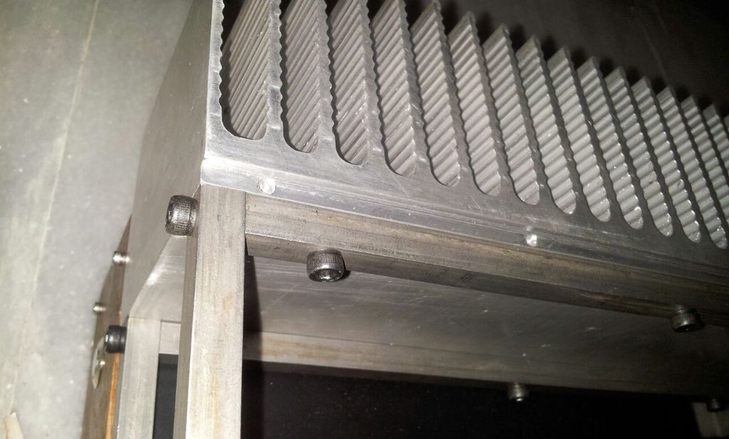

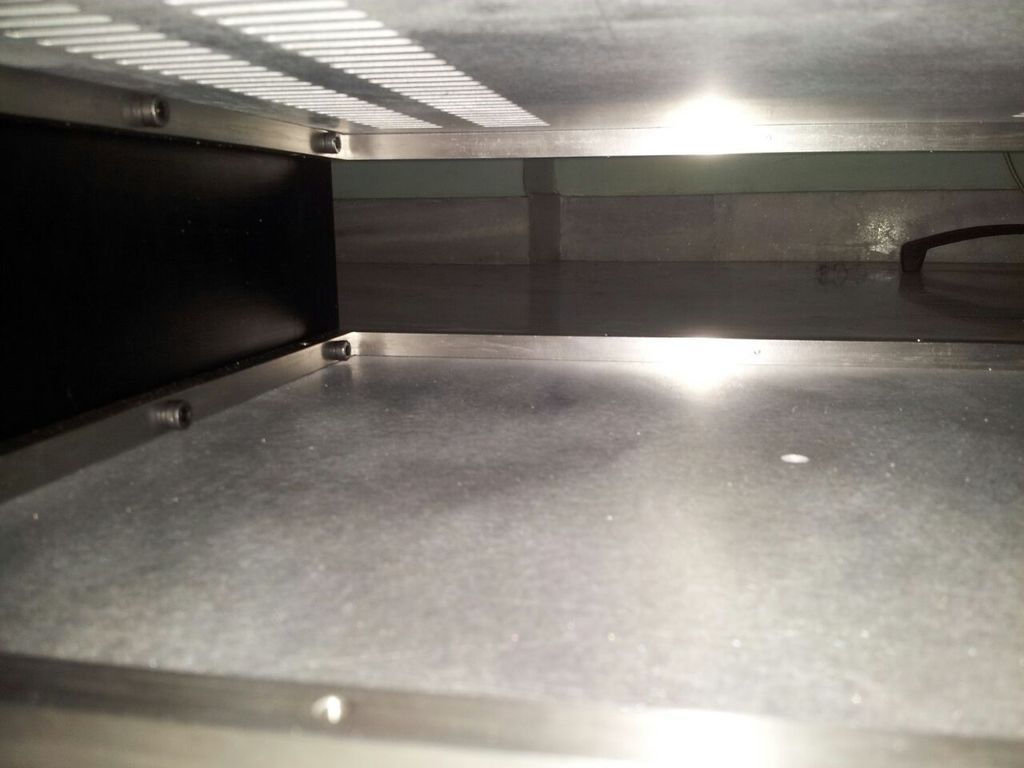

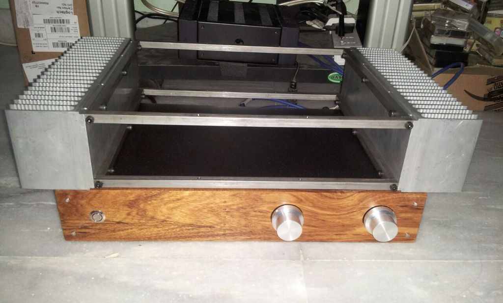

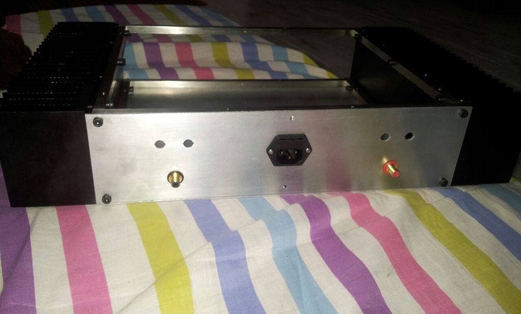

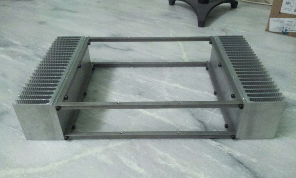

Yes heatsinks are anodized in Black color. Cab anodizing and faceplate is pending.
Regards
Sachin
