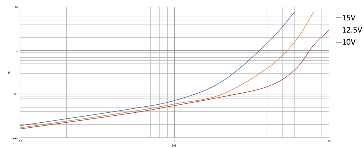

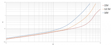

Interesting. What was the bias value and was it the same used for all different supply voltages ?
BR,
Eric
