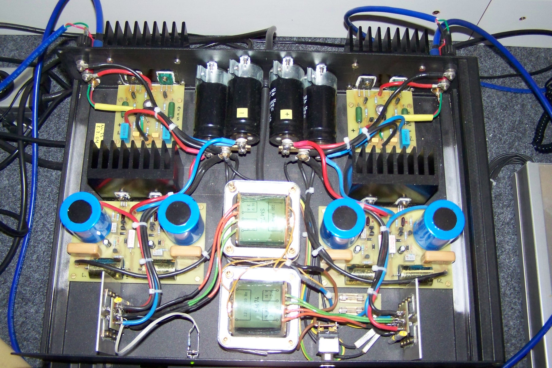

What is the power consumption of 8w Hiraga amps ? 8w x 2 channels = 16w , 25% of 64w = 16w. So I'm guessing just 64w power draw for Class A.
Pretty cool running.
At 850 mA idle current from two rails of 13 volt (after CRC filter) it is 45 watts. That is cool for an almost "pure" class A.
My shunts absorb some 10-15 watts, and the power resistors in the CRC another 10 watts. The max power is then slightly below 8 watt indeed.
At 14,1 volt/1.100 mA it does get 62 watts. I have had that setting for years. It does then need a large heatsink then with a low thermal resistance to keep the classic output transistors below 45 degrees. This does give 8 watt.

GL lot give very too high current from jFet... then to high noise in 2sc1775 and 2SA872... that is amplified by 2SB716 then 2SD844
Look at the "constant noise figure" of them ! We must not exceed about 1 mA in idle what that was expected by the designer
You have to gain at GR lot with an Idss at about 3mA no more
