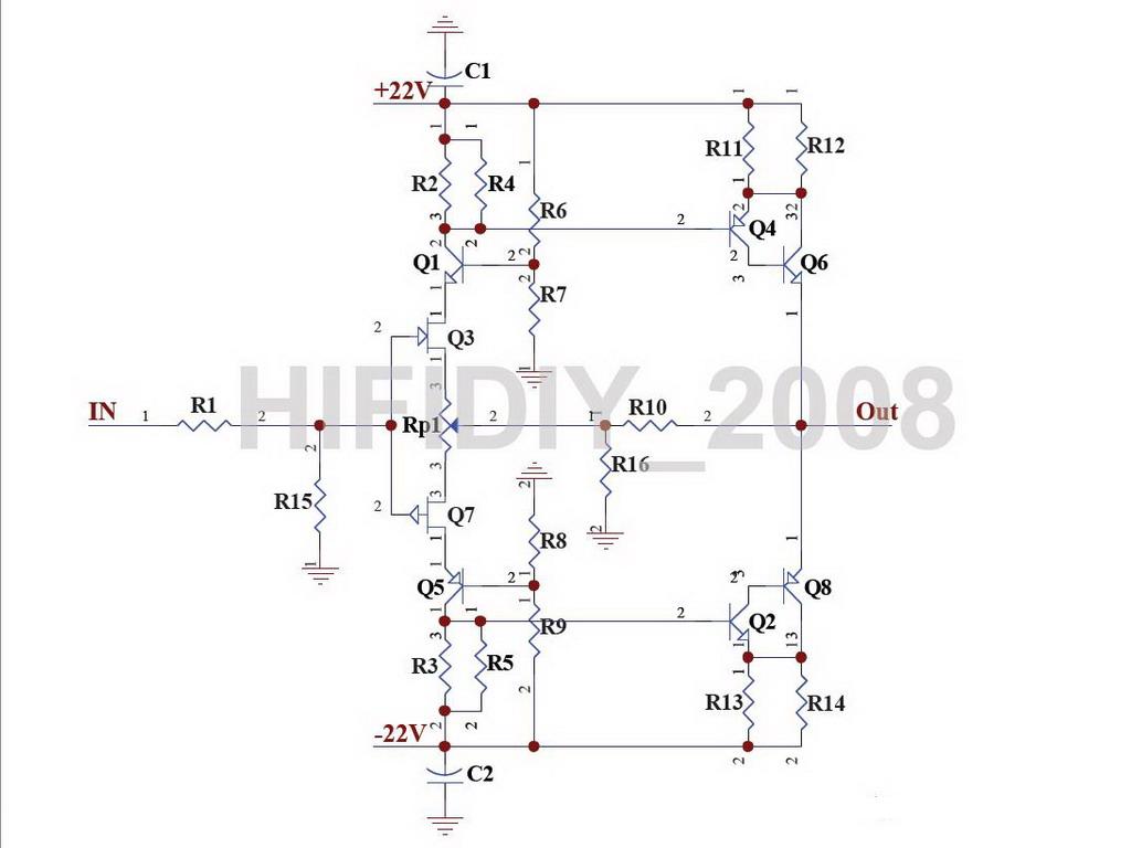

So to Start Again
We need
2SC1775/2SK170
2SA872/2SJ74
2SB716/2SD756
Right I Have now source the 1775 so let’s say I have the 2SC1775 for the moment so ok
We have
2SC1775/2SK170
2SA872
2SJ74 Replacement is a 2SJ103
2S716 Replacement for is a 2SB647
/2SD756 Replacement for is a 2SC2632
So let’s say
Q1 2SC1775
Q3 2SK170
Q4 2SB647
Q5 2SA 872
Q7 2SJ103
Output
Q6 2SC5200
Q8 2SA1943
Please Note the replacements were recommended by my supplier

Joined 2008
Hi Colin,
Don't worry - I can remember having trouble finding parts for the Monstre, and believe me, it's a lot harder down here in Brazil than up in Scotland! ;)
From your last post it seems you are planning on switching the 2SJ74 for a 2SJ103 while keeping the 2SK170. I don't think this will work well - there is nothing wrong with the 2SJ103, but if you use it then you should also change the 2SK170 for 2SK246. This is because 2SJ74/2SK170 are a complementary pair, as are 2SJ103/2SK246. This isn't a big problem - anywhere you can find 2SJ103 you will probably find 2SK246 also. (Ampslab, linked above, for example.) You can keep the 2SK170 to use in some other project - there are loads of schematics on the Pass Labs forum here that use them.
I used a non-complementary jfet pair on the first one I built (8W version) and I had to mess around with the circuit a good deal to get dc offset down to sensible levels, which was really a pain, and I'm sure there were plenty of other things wrong with it as a result. There's no point in saving a little work finding the right parts now only to create work after the amp is built...
Similar things probably apply to the other pairs.
Cheers
Nigel

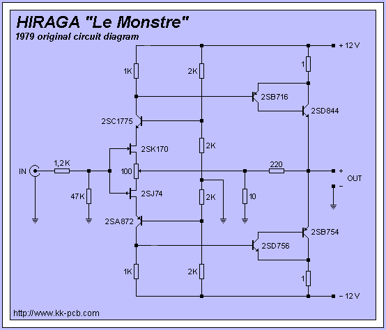

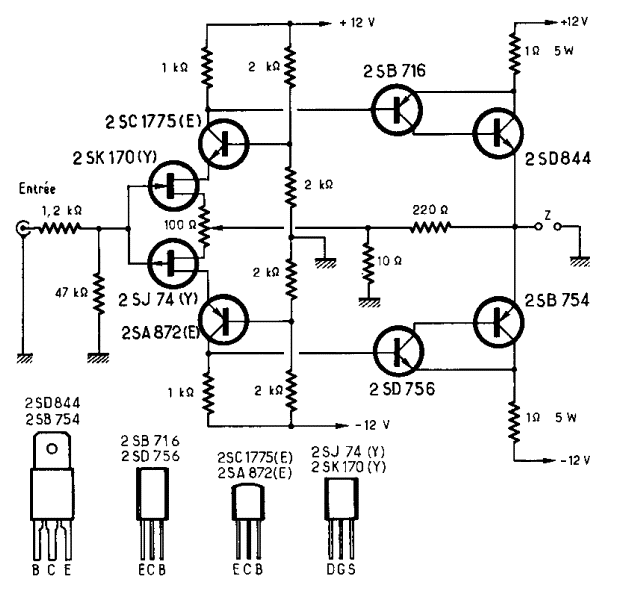

Hello
I say the same , when you have a transistor, fet or JFet please look up the complementary parts . You can't replace the 2SJ74BL with 2SJ103BL and leave the 2SK170BL . They will not work properly together...
At JFet you have to pay attention what grade BL ,GR ,V ,Y etc .
Even if they are complementary pairs and one is BL grade , the pair is GR not the best idea to use them !
You will end up with a big offset and that just a small problem.
These is the original Hiraga Le Monstre!
For example
2SJ74BL complementary pair 2SK170BL
2SA872E ------------------ 2SC177E
2SB716 -------------------2SD746
2SB754---------------------2SD844
If you change the NPN you have to find the complementary part PNP and change that to.
The transistors has different MHz (speed), pF(capacitance) , etc .Those are very important!
That is why you can not exchange them!
Other wise you end up with a mess.
I built these amp , I sold at least 80 kits with home made PC board no complain at all.
I wrote on the Ebay you can get matched (important that to) pair 2SJ74BL & 2SK170BL .
You have to buy them !In case if they aren't matched you end up one side sound different than another !
Seriously!
The black end white the original schematic! If you want the orig Le Monstre please use that!
Believe me better to get the right parts from the begening , atherwise you will spend much more .
I just want to help !
Greetings

Hello
The 2SA872A & 2SC1775A OK
2SB716 not equal with 2SB647
2SB716 pdf, 2SB716 description, 2SB716 data sheets, 2SB716 view ::: ALLDATASHEET :::
http://www.datasheetcatalog.org/datasheet/HitachiSemiconductor/mXyzuyvu.pdf
Please look at the Gain bandwidth fT the replacement has140MHz the orig has 150MHZ
that would be OK
Also the capacitance COB the replacement has 20pF the orig has 1.8pF
These a big difference
If you use 2SB647/A please use 2SD667/A with it
Those are complementary parts!
Please do not use the ECG catalog ,look up the parts on the Net
So 2SB647/A goes with 2SD667/A The JFet you can not replace with 2SJ103 , you must find 2SJ74BL if you have 2SK170BL!
There are lot of parts even matched parts on Ebay!
I know the extra cost but you must have to have .
Also if you have unmatched complementary parts the two side will sound differently!;)The easiest think you buy matched parts , or have to buy enough to matched hfE at transistors
IGS at JFets
I know life is not easy , but you must get the parts which work well together!
Greetings

Boy you guys like to confuse a beginner :)
Are you saying none of the transistors I have listed will work with the schematic I posted could you pleas just post the part numbers I require for
Q1
Q2
Q3
Q4
Q5
And suggest a good transistor for Q6/7 in place of the 2N types
And if you can do the same for the updated version that uses the BC550C/560C transistor
This will give me Better choices on which one to build I think this will be much easier than talking about comp pairs that are not used but I have taken note of all your posts which will help in understanding the different transistors Valves are must easer :D
Hello
I still don't know what you have at your hand.
From these schematic
2SJ74BL or (Y)/ 2SK170BL or(Y) I think must !
Y the original but hard to find it , BL popular , you have to adjust the 2PC 1K resisters to set up the right bias.
Second line you can use BC550C/560C how Lineup advised
I would rather use ZTX450/550 (I think better quality)
Here you must care about the different pin out of the transistors!
For driver stage I would use also ZTX653 / ZTX753 . Different pin out , take care about that!
For power transistor if you use TO3 can (metal can)
MJ15022/23 great transistors or MJ15024/25I would try these if I do not have the orig semis. We advise the original because those were properly put together . Someone invested time and energy to achive these result.
That not mean you can not achive the same result or even better .
But to have the orig that would give the right base.
You can upgrade it .
If I wouldn't have the orig I would try these list .
Greetings

Ok perhaps he tested it and got the different impedances
Just to say it may sound like I Am being ungratefully to some of your help please don’t think this as this is not indented:)
So to Start Again
We need
2SC1775/2SK170
2SA872/2SJ74
2SB716/2SD756
Right I Have now source the 1775 so let’s say I have the 2SC1775 for the moment so OK
We have
2SC1775/2SK170
2SA872
2SJ74 Replacement is a 2SJ103 No good
So let’s say
Q1 2SC1775
Q3 2SK170 ??? what grade (BL, GR,V) need 2SJ74 same grade
Q4 2SB647 I would not use these specially with 2SC2632 not complementary pairs
Q5 2SA 872Q7 2SJ103 NO!Output
Q6 2SC5200
Q8 2SA1943
Hello
I see your list
You wrote 2SC1775 you dont have so Q5 is out to
Q3 2SK170BL is OK but only with 2SJ74BL , so Q7 is out
Only the output is OK but who knows those are real Toshiba parts??
Toshiba last 13 years or so not produced not one of these!
Greetings
