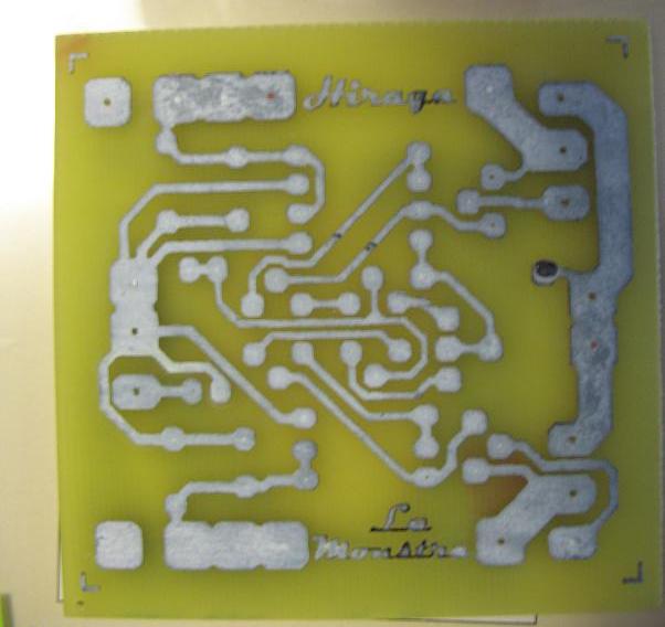

Hi Williams Audio
HK HIRAGA LE MONSTRE PCBs
On checking my Parts list and it seems I have the 5 Watt R12/13 missing from the list can you post the values of R12/13 all other resistors would be ok if over rated at 1 watt and the ohm Pre set pot rP1 ok at 0.5 watt or better

Hi All
It seems my Parts list is incomplete regarding the 5 Watt emitter resistors Values R11/12/13/14 Can anyone conform there Values for the HK PCBs I have contacted the seller but he doesn’t seem to understand what I am asking him so gave up
Ah right Seems the emitter Resistors R12/13 Are 1 ohm just a bit confusing for a beginner with so many variations of this Amp running at different voltages I guess adding a Speaker protection circuit would be a good idea as well any comments on this are welcome as I a bit quiet round there for some reason😱

Hi Colin,
Don't give up on the amp if you already have most of the parts. Let me ask a few questions, and make a couple of remarks.
1. There are many schematics floating around called "Hiraga Le Monstre", and at least two called "Hiraga Le Classe A". In post #530 you said you were undecided whether to make the +/-12 volt or the +/-22 volt version; is this decided now? Is the schematic you are planning on using the one in the link in post #526?
2. It may not matter much, but it is my understanding that the +/- 12v version is the "original" Hiraga version, with 8W output. The Class A Amplifier site has the original article, schematics and everything,
The Class-A Amplifier Site
and a version with modern equivalents can be found at
JEAN HIRAGA - Le Monstre Amplifier PCB
I have built the second one, but not the first, with original parts, but I believe danieljw (Hi Dan!) has built with everything original, and can tell you more. The one with modern equivalents is a fun project, and I enjoyed doing it and listening to it.
3. You aren't going to be able to do any of these circuits well without using a complementary pair of jfets. The originals are 2SK170/2SJ74, the "modern equivalents" circuit uses 2SK246/2SJ103, and I have also built that version with 2N5457/2N5460, although performance wasn't as good, maybe. If I understood correctly, your post #549 lists parts you already have. You are going to need to find either 2SJ74 to use with the 2SK170 you have, or 2SK246 to use with the 2SJ103 you have. You can get 2SJ103 from
Power Amp Kits by AmpsLab
If you are doing the +/- 22V version I would stick with 2SJ74, which you can probably also buy online if you look around. I'd also try to get the same grade as the 2SK170 you have (BL?).
Well, sorry I can't be more help, but don't give up on it.
Cheers
Nigel

Hi Nigel
Thanks for diving in to help
Yes I was thinking about doing the 8 Watter but went with the 20watt HK version I posted
I ordered parts from criclewood
Right I have got the following
2SA872Ax2
2SK170 BLx2
2SB647x2
2SC2632x2
I an told by cricklewood that I can use 2SB647 in place of 2SB716 and 2SC2632 in place of > 2SD756
2SB716x2 comp to 2SB647
> 2SD756x2 comp to 2SC2632
Right so Crackle wood are now suppose to be sending the 2SC1775 as I ordered but tried to send me the 2SC2240 in place of the 2sc1775 but some have said the amp impedance can change from 4 ohm to 20 ohms if non original parts are used
Hi Colin,
As a general rule I would stick to using complementary pairs in symmetrical positions. There are plenty of people here on the forum who can read a datasheet and see when a "non-complementary" part will work OK, or even better, but I'm not one of them.
The datasheets show 2SB647 is complementary to 2SD667, 2SC2632 is complementary to 2SA1124. I thought 2SC2240 was complementary to 2SA970, but the data sheet doesn't say so, so maybe my memory is faulty. (Anyone confirm/deny? Maybe they're just a commonly used pair?)
There are several places here on the forum where the question of parts for the Monstre is discussed. It's usually tricky, since some of the originals have been obsolete a long time.
Cheer
Nigel
Cheer
Nigel
