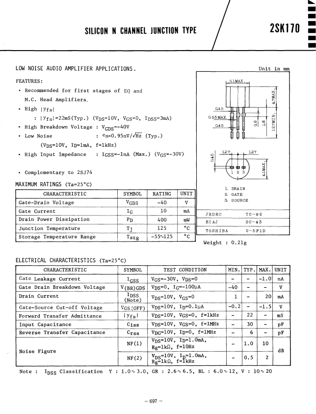

The attachment is from Toshiba Small Signal Transistor Data Book 1983.

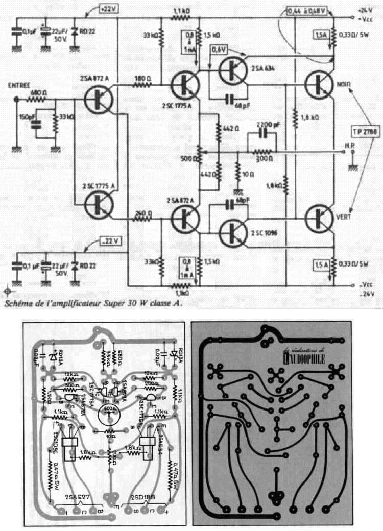

I have a Super 30w but with the PCBs and all the original parts (the audiophile's house), I can't help you with the Prasi boards.
on the other hand, I can tell you that it is an excellent amp, very sensitive to its power supply.
I had made a first assembly with a simple power supply before receiving my order of 6 x100000uF, the amp was very different afterwards.
It's been with a friend for 15 years and we even use it to have dance parties with Cabasse Sampans lourd.

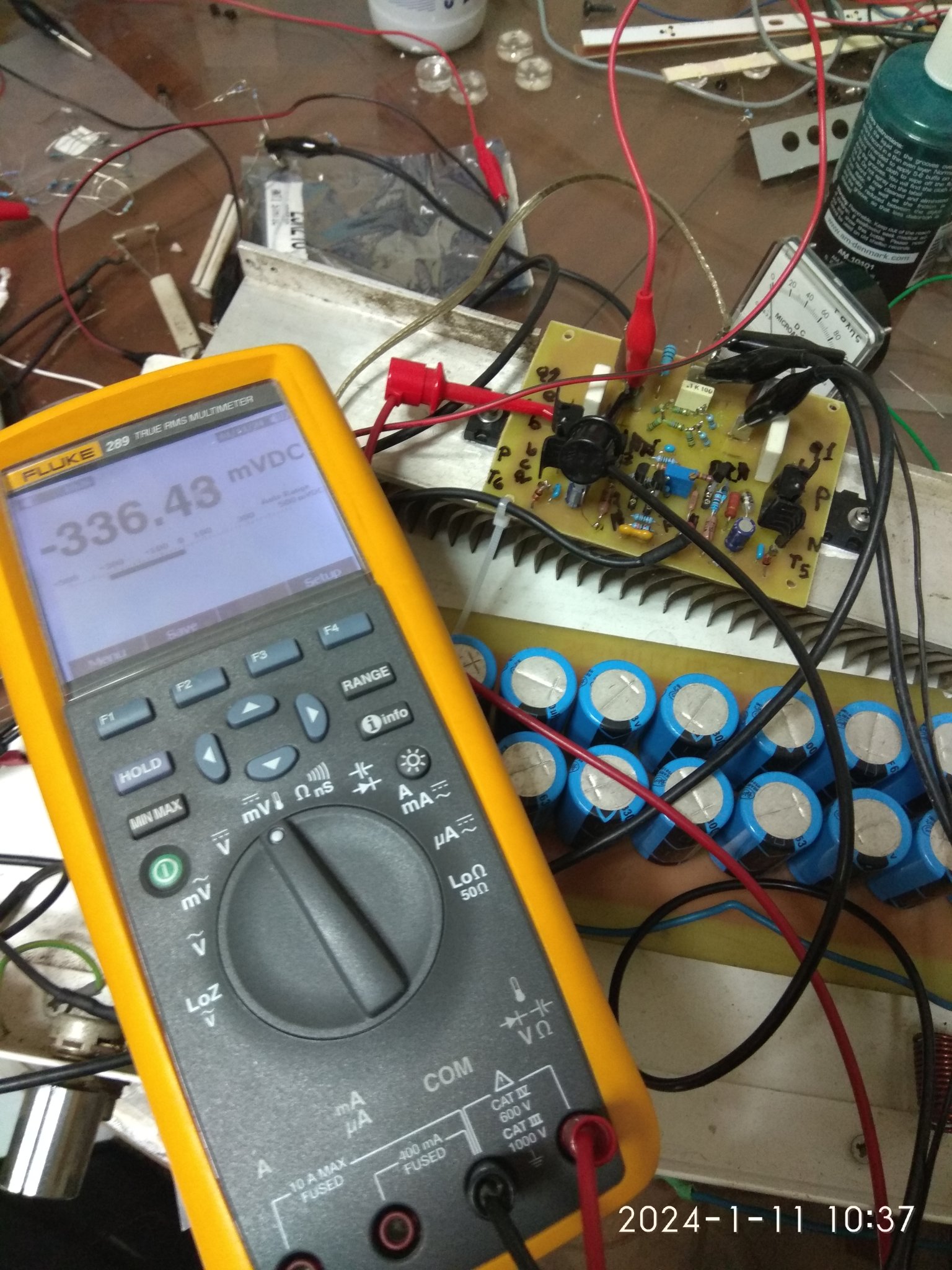

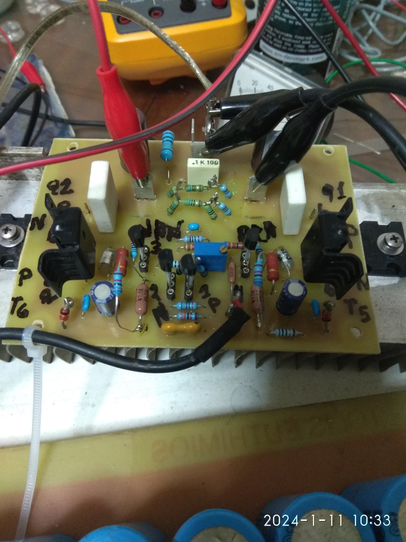

Now i know the way for bias setting 😉
I need to reduse 27K7(47K//68K) even farther for +/-24v .
Keep in mind that i have a test heatschink (small).
I will go for the second channel and then i will have a listening test.
From a first,mono test,not bad.☺️
