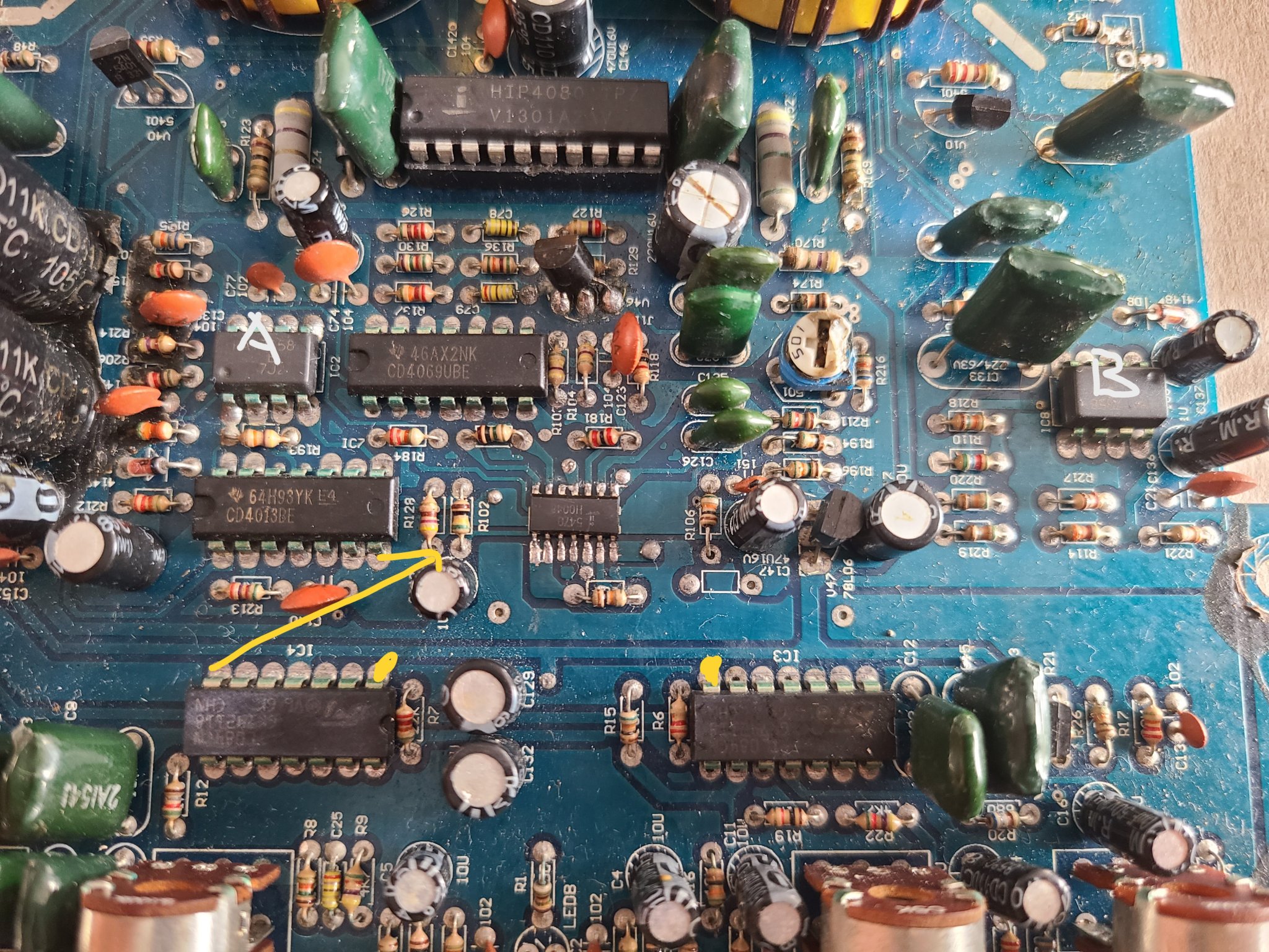

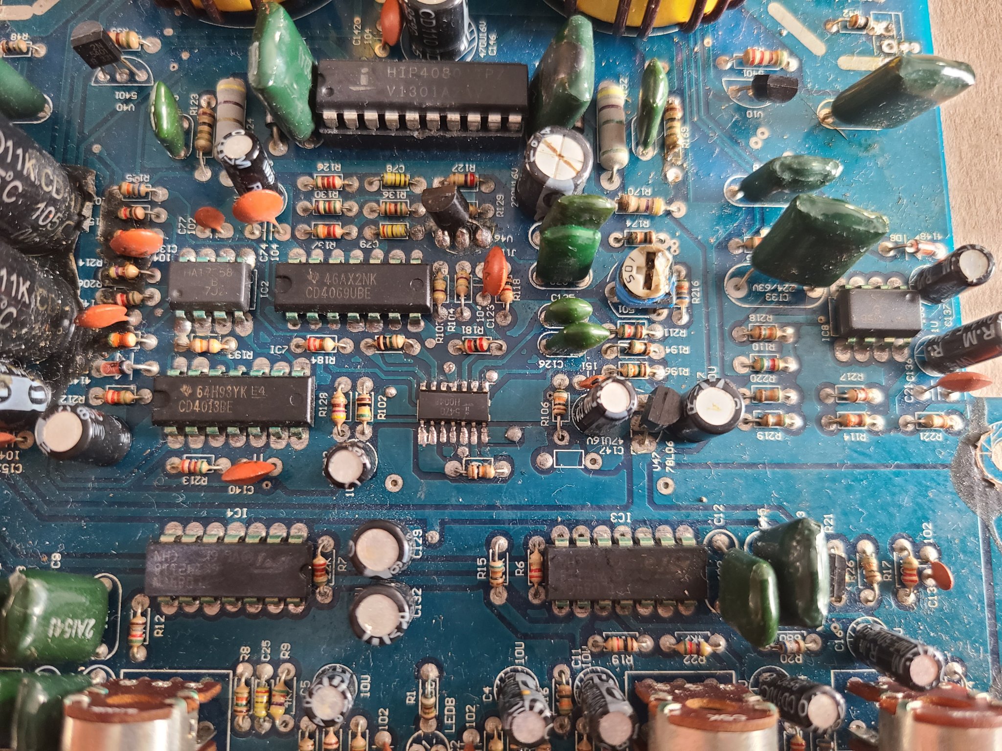

the 17358(A in attached pic) in question is CA3290 connected to the CD4013 on the diagram FP900. B is the only other 17358
my amp has 2x TL084cn as per below
audio is present on below yellow dots marked on the TL084s
the yellow arrow is where the trace connects into the circuit

I have managed to get output on pin7 (squarewave) of the hip4080, I lifted pin3 (hip4080) which was high. the JFET gate is high as well, should it be low?
no outputs in circuit.
Connect the lifted pin 3 to pin 4 to ensure that it's not floating.
I don't know about the jfet.
Pin 7 is a 'square' wave? What if you reduce the input signal level?

replaced CD4013 & HA17358 - but it still shuts the 4080 off (how do i check the what is causing the 4013 to turn off the 4080?)
Pin3 lifted and connected pin4 of the 4080

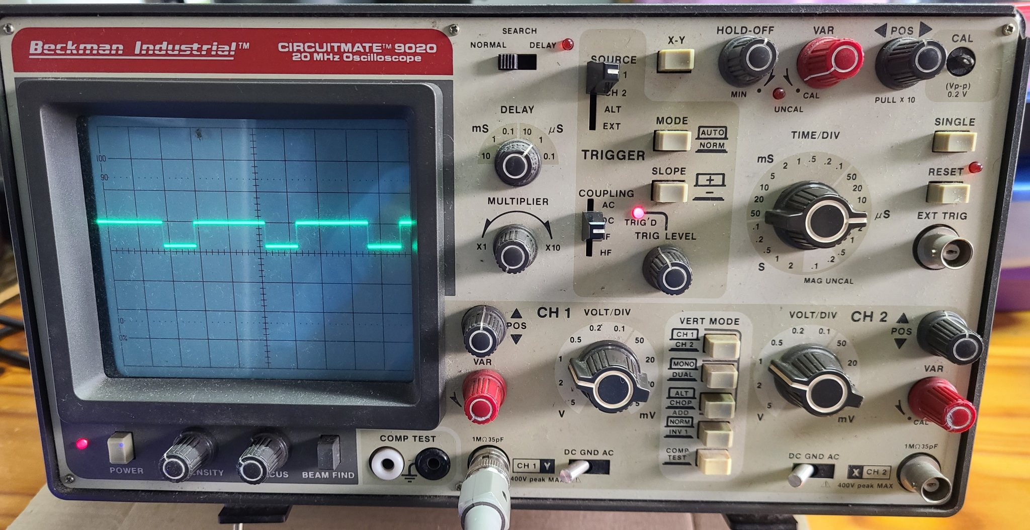

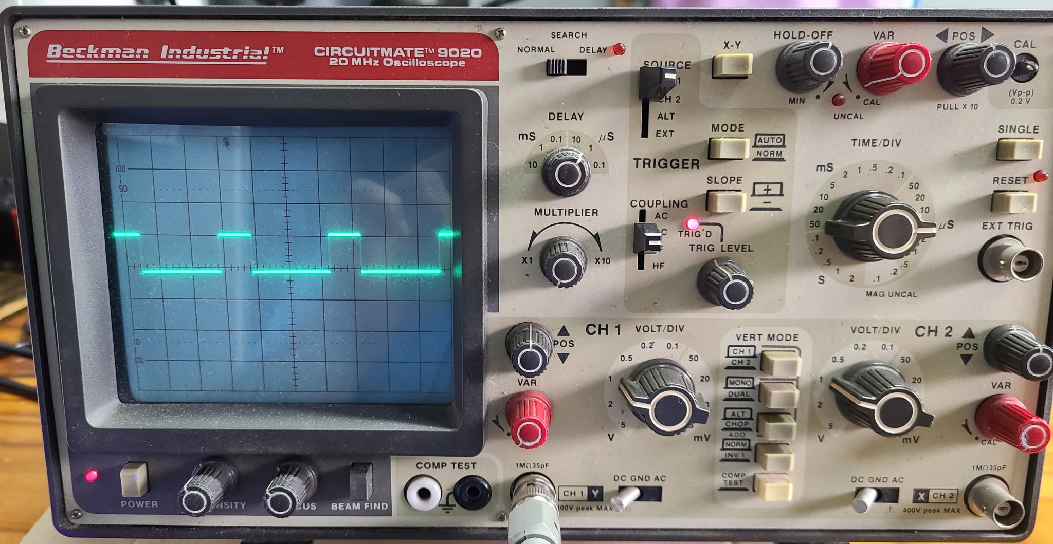

these were taken on the gate pads
output fets are not in circuit, over current protect is on as well. (was not able to source irf3710z)
yes, amp is shutting down
What pin of what IC is driving the clock terminal of the 4013?
Load the FET locations (gate to source) where you're measuring the signal with a 0.01uF film capacitor and post the gate signals. You may have to install a jumper from the drain to source of the low-side FET to get an accurate waveform.
You only posted for 2 banks. Post the signals for all 4 banks.

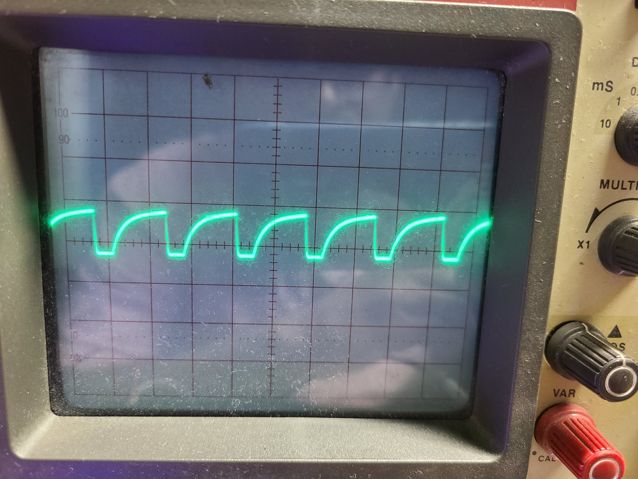

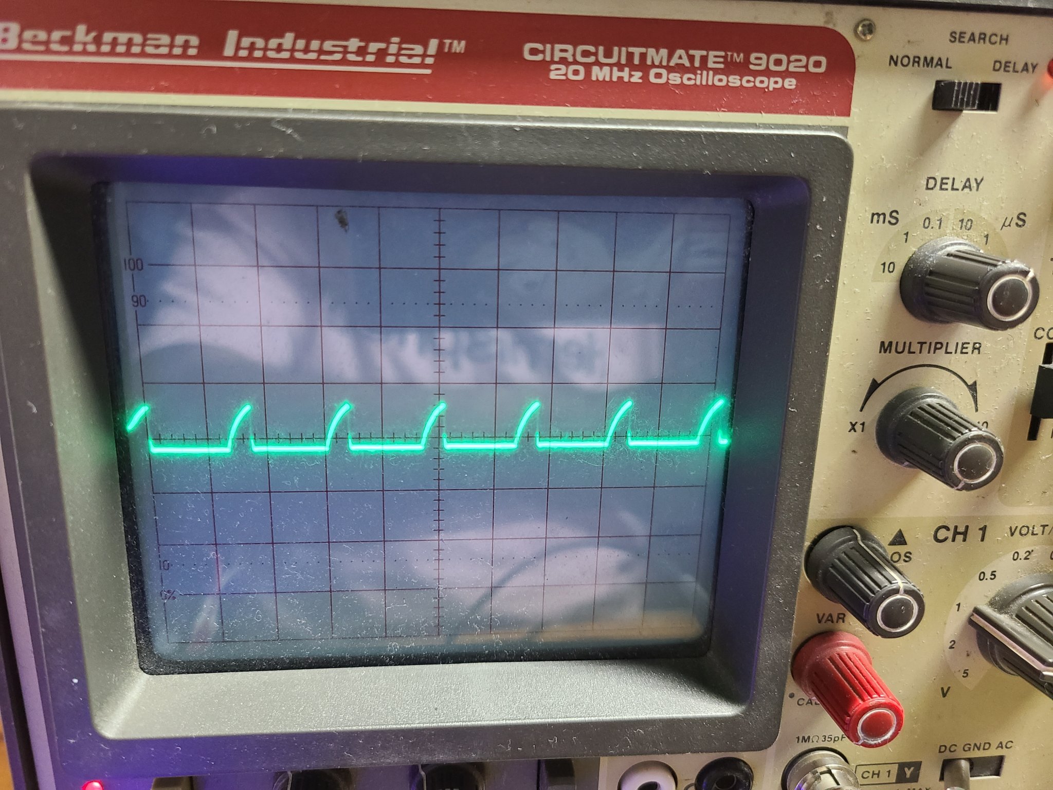

below is the drive of the high side when loaded with the 0.01uf cap (the gate resistor seems to have gone open here while loaded)
low side remains same with the source and drain bridged
If you bridge pins 1 and 2 of the 5470 (on the diagram), you'll get a better drive waveform.
