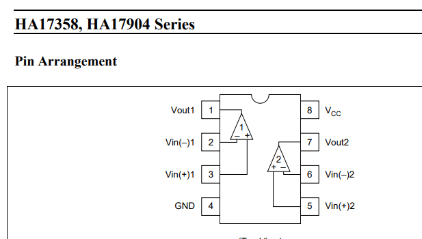

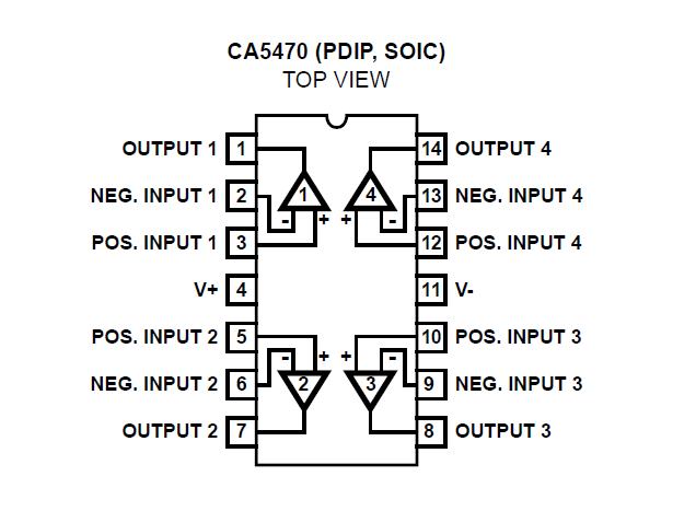

Used another multimeter.
pin 1,2,3 are all at 6v (bridged or not)
supply voltages at correct pin 11 (-11v) and pin 4 (+11)
using the fusion fp9001
and below for 5470
bridging pin 13&14 also triggers pin 7 of the hip4080
and below for 5470

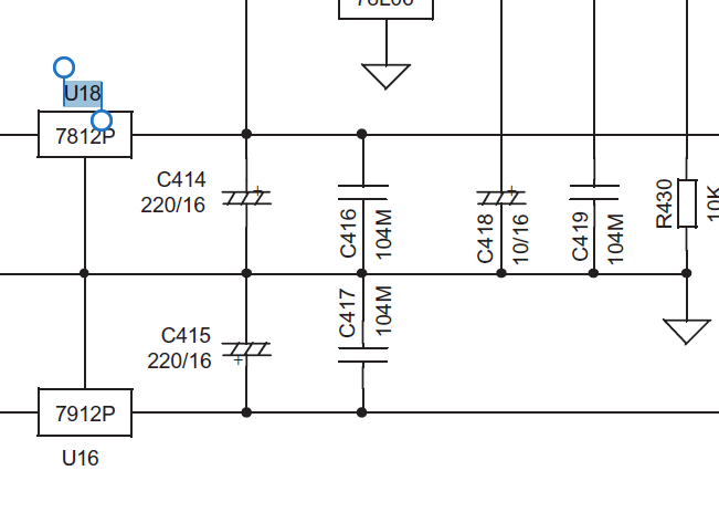

Pin 11 is ground on that diagram. Are you sure that it's negative 11v on your IC?
"bridging pin 13&14 also triggers pin 7 of the hip4080"
^^^ Explain ^^^
^^^ Explain ^^^
Apologies, you are correct it is ground.

I assume the HA17358 is the NE5532P U6b
there is no audio signals on HA17358
also noted there is no -12v on pin 4 as per the diagram.
audio signal is at the TL084cn
doesn't seem to be a break, there is connectivity to PIN4 at C415 & C417
i pulled those caps and they test ok
PIN4 of the HA17358 & CD4013 are grounded
Re-check the voltage on pin 4.
Voltage on pin 4 of the other 5532s?

I traced the signal from RCA to the TL084, then fail to trace where it integrates into the HA17358 circuit.

Hi Perry, found a short between PIN4 & PIN6 on the HA17358, ordered a replacement.
