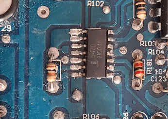

How different is the circuit for the jfet?
I don't see the pot SVR1. What else is different?
What's the DCV on pins 8, 9 and 10 on U9?
JFET circuit
D: connected to Pin14 5470
S: connected to pin3 of 5470 as per the diagram
G: driven by Pin7 of 5470
will post voltages later on, we have an electricity outage
pin8 & pin9 are bridged on U9

I hadn't heard of that in years. I didn't know it was till a problem.

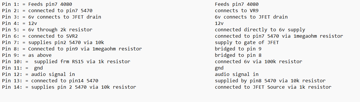

When you get power back:
U9 on 9001 diagram (left)
On your amp (right side)
Pin 1: =
Pin 2: =
Pin 3: =
Pin 4: =
Pin 5: =
Pin 6: =
Pin 7: =
Pin 8: =
Pin 9: =
Pin 10: =
Pin 11: =
Pin 12: =
Pin 13: =
Pin 14: =

Pin 1: = 6v
Pin 2: = 6.5v
Pin 3: = 6.5v
Pin 4: = 11.7v
Pin 5: = 11.7v
Pin 6: = 0.02v
Pin 7: = 10.9v
Pin 8: = 5.9v
Pin 9: = 5.9v
Pin 10: = 5.4v (amp draws current limited to 4A)
Pin 11: = 0v
Pin 12: = 6v
Pin 13: = 5.9
Pin 14: = 5.4v

Are you sure that you have pins 8, 9 and 12 correct for your amp?
I'd expect the audio in to be on the same op-amp section as the bridged pins.
