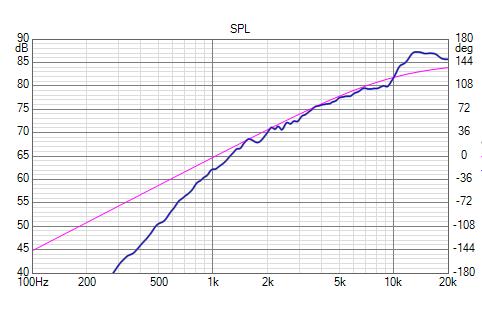

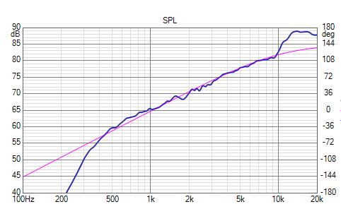

great thanks! Makes sense, I wondered about the levels from 3000 and up since I knew I was getting some help from the tweeter blended in with the mid-woofer in this critical mid-band. That is why I like the sound combination; the piano does sound better with this latest tweeter configuration. I used the online calculator for -6 dB at around 16 Khz based on the impedance curve at that point. I was assuming -7 dB at about 15 K and then -13 at about 7500 Hz but the math didn't support what I was hearing. I need to come into this century like the rest of you guys with sims and measurements. Your "pink" curve supports my listening tests almost exactly what I was hoping for and thought I was achieving! So, 4 to 5 dB per octave drop off it looks like from about 8000 and down instead of text book 6 dB. One reason I chose this tweeter was the rise above 10K, where my hearing needs the "boost" You younger guys would need a much flatter tweeter. This top octave rise does not sound like a nasty break-up however; for my old ears, it provides just enough "sparkle" and "zing" as long as I use higher quality capacitors. This tweeter now sounds like a $100 unit instead of a $30 unit. Same thing with the SB13's; I'm really looking forward to the better inductors. Maybe by the time I get the final box ready; I'll have my measurement mic back. Thanks again Celef!
Can anyone explain why the drop off is only about 4 to 5 dB per octave? Is it because of the tweeter impedance being more "complex" than we might expect? I realize text book formulas and theories don't always hold 100% true in the real world; I'm just curious what makes this less than -6 dB per octave as we were all taught back in the beginning when learning about slopes, roll-offs, etc. I know that these things are different in 2nd order as in L-R vs BW vs BE vs Ch'y, etc. What the sims show is that my 1st order does not have a Q of 0.707 (typical BW) but acts more like L-R on a per octave basis...interesting!
Well, thanks, exactly what I thought. I do remember learning about imaginary and real parts of the complex number including impedances but that was way over 40 years ago! I know about them still but couldn't do the math without a very long and tedious study session or two! It's good to know the sims are sophisticated enough to take all of these complex variables into consideration.

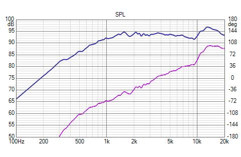

I just now received the 0.13 mH 14 AWG flat foil inductors. I am experimenting with tweeter attenuation and also different resistors across the coil. The RL parallel combination is to adjust the roll off of the low pass. The circuit looks just like that used for BSC but this is NOT that; I am tweaking the high frequencies; I don't care about baffle step here at all. Once I get these into the final box; I'll worry about tweaking the bass; right now; I'm more after the best blend of mids to tweeter: X/O F0, slope, attenuation, etc. More later...
Best quick listen so far: 8.0 Ohms in parallel with the 0.13 mH. Series resistor before the tweeter cap is now 2.2 Ohms instead of 3.5 Ohms. This gives me - 3.5 dB instead of - 5.0 dB. Tweeter caps remain as before; 1.165 uF combined. Mostly just very high quality jazz CD and SACD listening tests so far. Female singing voice; full range of piano; bowed acoustic bass, etc. all have a very good balance; nothing missing; nothing exaggerated; nothing too bright; nothing too dull...Goldilocks zone...just right!...stay tuned...yeah, pun intended!
