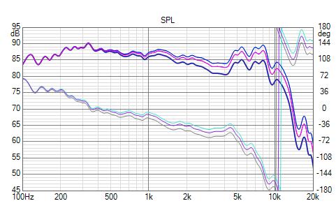

The break up seems well behaved even at 7 KHz +/- ; the peak is lower in the round frame (13PFCR).
https://meniscusaudio.com/wp-content/uploads/2020/03/SB-Acoustics-SB13PFCR25-8-Data-Sheet.pdf
round frame above
original 13PFC below
https://meniscus.lightningbasehosted.com/wp-content/uploads/2015/11/SB13PFC25-08-Data-Sheet-1.pdf
round frame above

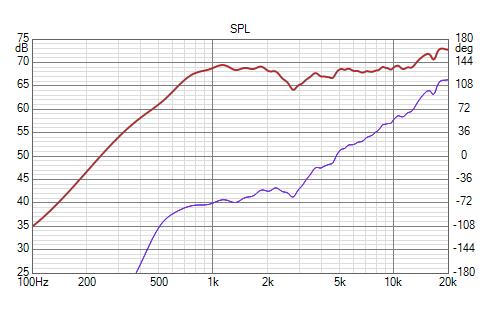

this is simulations based on measured responses for the s-s d2604/833000 which i guess is similar to your tymphany, graph shows freq responses for no crossover and then 3.6ohm - 1.2uf in series
measurement done to tweeter mounted on a 20x100cm baffle
