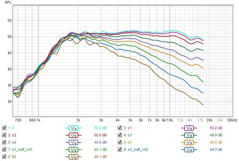

Did you get a chance to measure the dispersion/directivity of this tweeter on a stick?
Lots of eq to get there. More here.
My polar is not exact either. Just moved the mic and measured with a laser in steps.

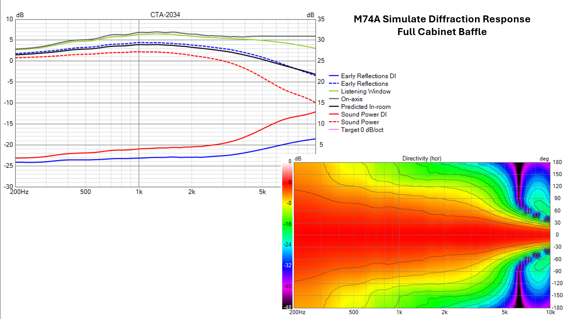

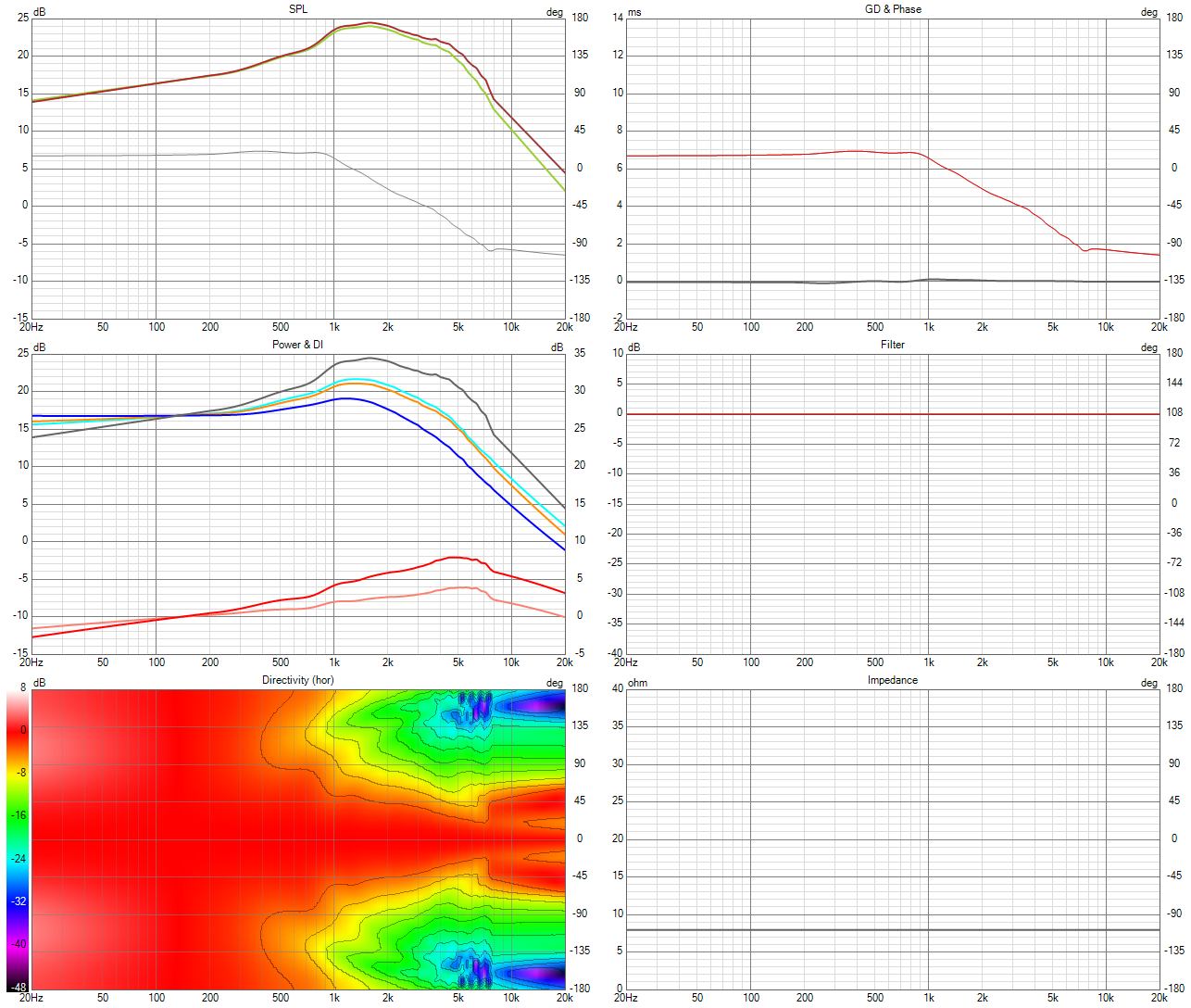

This is an M74 simuated in a minimal enclosure 180 mm wide and 200 deep with a 38mm roundover ot thereabouts (from memory it is the A profile).
You can somewhat ignore the frequency response other than the fact it shows the gain of the baffle and slight waveguide infront of the driver, but the directivity will be pretty close to real.
You can see that the DI is smooth but rising due to the diffraction loss. This same driver in a baffle sixed for an 8" woofer has a much more constant directivity of 5dB or so over most of it's range. I have seen that in practice from a speaker @jcga made, using a T25B, M74B and 2 x Purifi 8" drivers. I "designed" a very small 5mm deep waveguide for the T25B to match the M74B for him, there was some edge diffraction from the baffle being the size of a 8" woofer and having too much flat area around the tweeter as the cabinet was already built but it was still decent.

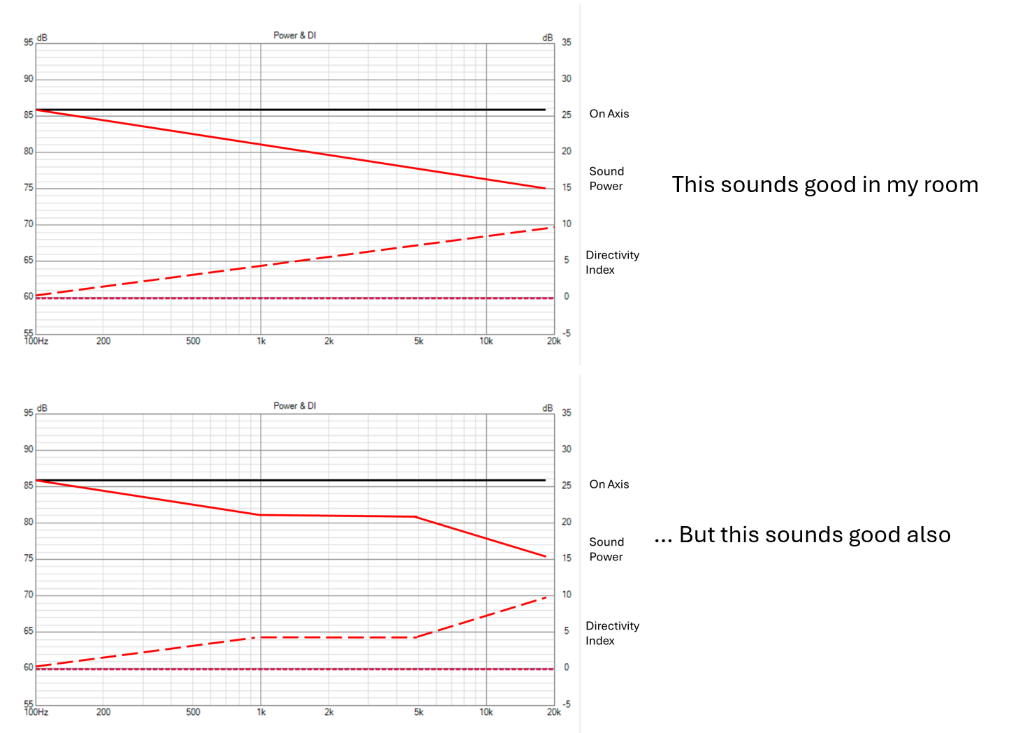

The DI curve slope is a interesting topic. Since most systems start with DI=0 (subwoofer) and ends up with DI>=10 (tweeter) , what is the best way to connect the DI end points. An omni and slim towers with low DI can provide a relatively constant slope DI to connect the dots. Horns and cardiods can often cause slope changes, producing a knee in the DI curve. Is a good DI curve defined by relatively constant slope or just no local discontinuties? I aim for a relatively constant slope.
[edit] I have never found an answer to "how fast can the DI slope change, and still be acceptable" ? Maybe its a preference.

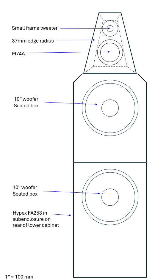

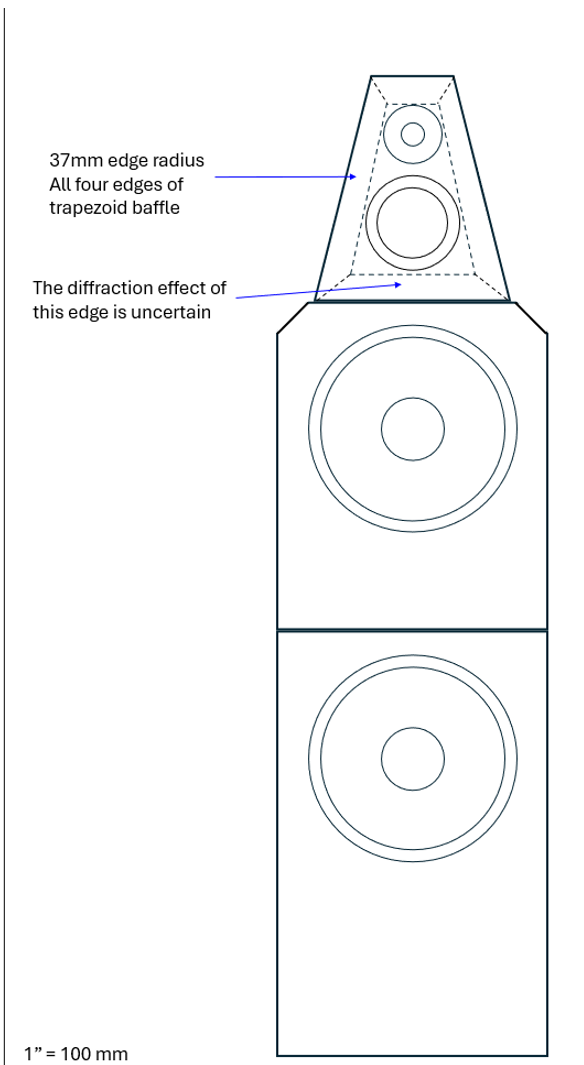

This is the current baseline configuration. The trapezoidal baffle is sized just large enough for the M74A and a small 70 mm frame tweeter, plus a 37 mm edge radius on all four edges.
My current plan is that the trapezoid baffle will be positioned in front of the woofer cabinets (closer to the listener) by at least 37 mm. This will provide the most reflection-free environment for the mid and tweeter. Unfortunately, it complicates the diffraction simulation a bit. The transition from the trapezoid to the upper woofer baffle is a more complicated geometry that is beyond the simple diffraction model in VituixCad. The question is should the trapezoid be modelled in isolation? Or should it be modelled as part of the full cabinet baffle including the woofer baffles?

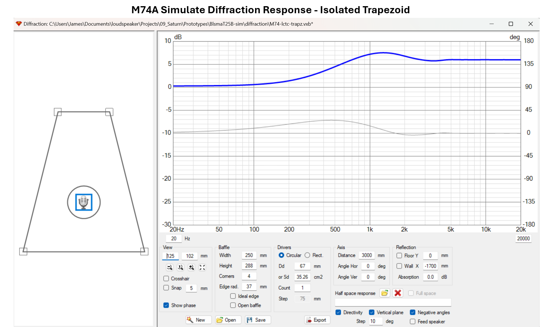

For the tweeter, there is no significant difference in simulating it either way. But for the M74 mid, there is a difference.

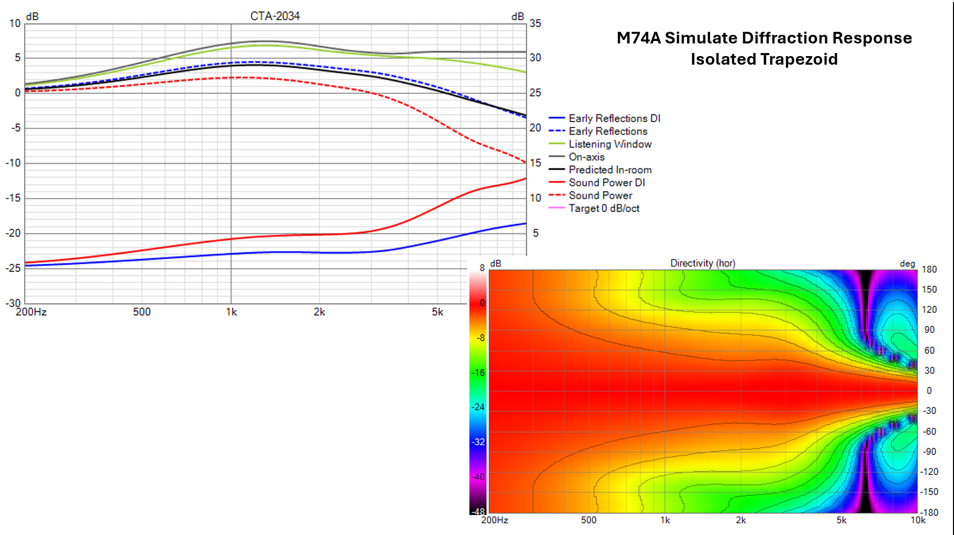

Here is the simulated M74A diffraction response for the case of the isolated trapezoid

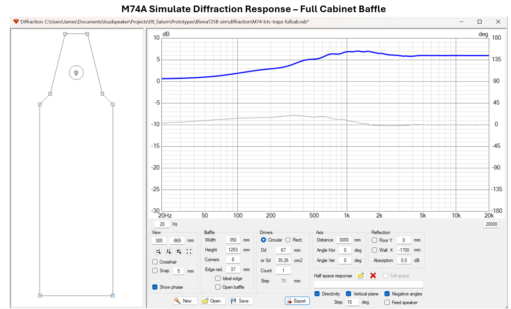

And now here is the simulated M74A diffraction response for the full cabinet baffle
In the next post I will show how these two diffraction assumptions impact the overall system level simulation

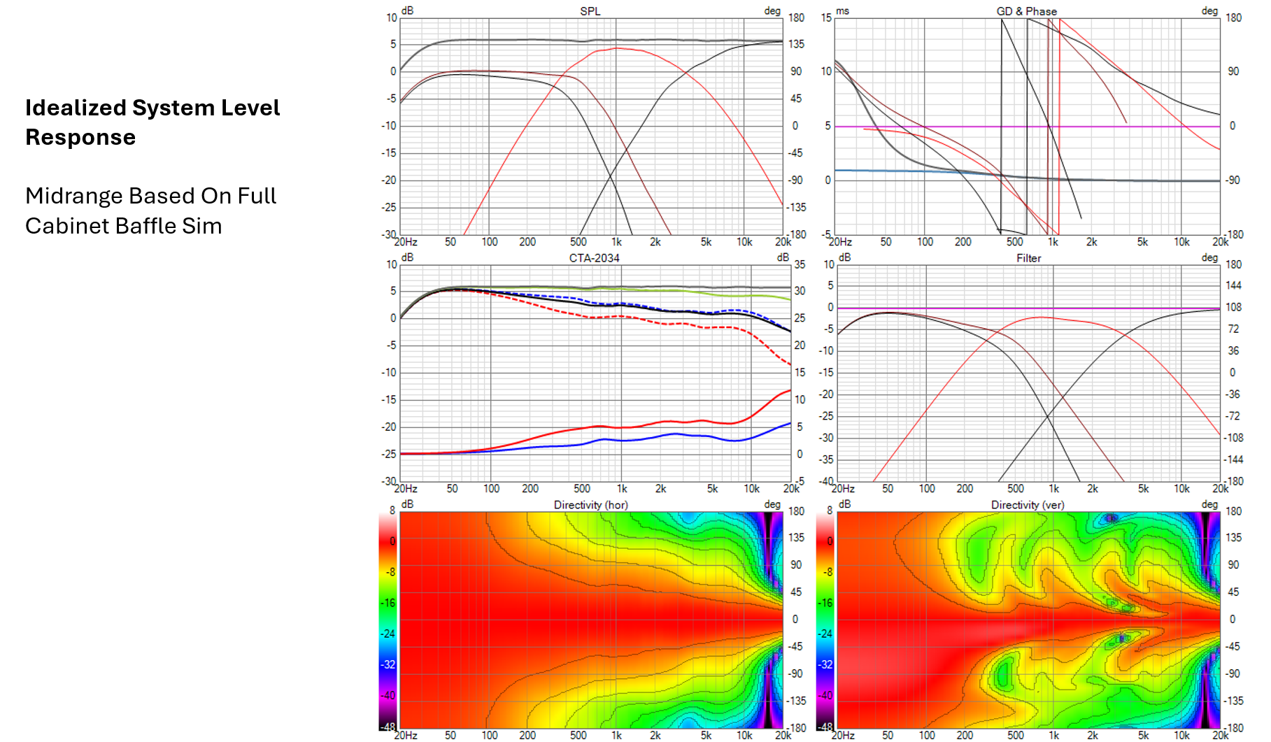

Here is the system level response assuming the midrange trapezoidal baffle is isolated.
And finally, here is the system level response assuming the midrange trapezoidal baffle is joined to the woofer cabinet baffles
The crossover filters are slightly different for the two cases. In terms of directivity and sound power, there is not a big difference, in fact it is rather subtle. But that does not mean it is not an important difference.
I wanted to post all of this detail so that we are all on the page and we can have a good discussion about this.
I think preference has something to do with it, and also the room and the distance from listener to speaker. For me, in my listening space, I seem to be rather tolerant of variations in DI. I have a pair of speakers with a very linear slope to the DI curve, and I have others which rise smoothly from 0 dB to 5 dB at 1k, then remain constant at 5 dB up to about 6k, then rise smoothly above that. I cannot say that I have a preference.

1. The dispersion is going to change when you model just the MT, vs the full cabinet with the twin woofers. That part is clear.
When you go to measure, will you measuring the separately, or together? The horizontal you can measure the cabinets together with a little extra work. The vertical, it will be LOT of extra work. You'd have to solve that, perhaps bolt on the trapezoidal cabinet. But at that point, you might wonder- why didn't I just build it as one piece?
For the speaker in post 52 I made the decision to model the full cabinet before any wood was cut. But the practical decision to measure separately,
So the sim is not perfect representation of reality. But I'm OK with that. Because I know that the CTA2034A/anechoic measurement by a NFS is also not a representation of reality of the speaker in my room.
2. What reason are there for choosing woofer bin width of 35cm?
3. Do you plan on moving the MT cabinet forward of the woofer bin 37mm?
The larger area of the woofer baffle below will have an impact as the simulation suggests and will offset the tendency of the DI to rise from that larger vertical surface.
I would suggest that avoiding joins and knuckles wherever possible and having the separate baffles flow into each other as much as possible will produce a measurably smoother result, and will also look nicer. You can see in the full baffle sim the smaller edges on the woofer top introduce some ripple. It is a small amount and not a major concern but it can be avoided if you want to.
I would not round the bottom edge of the mid cab or place it forward, I would make the top trapezoid a bit bigger if you go with 10" woofers. It won't add any real negative diffraction effect but it will allow the top and upper woofer cab to join together better than they do in your drawings.

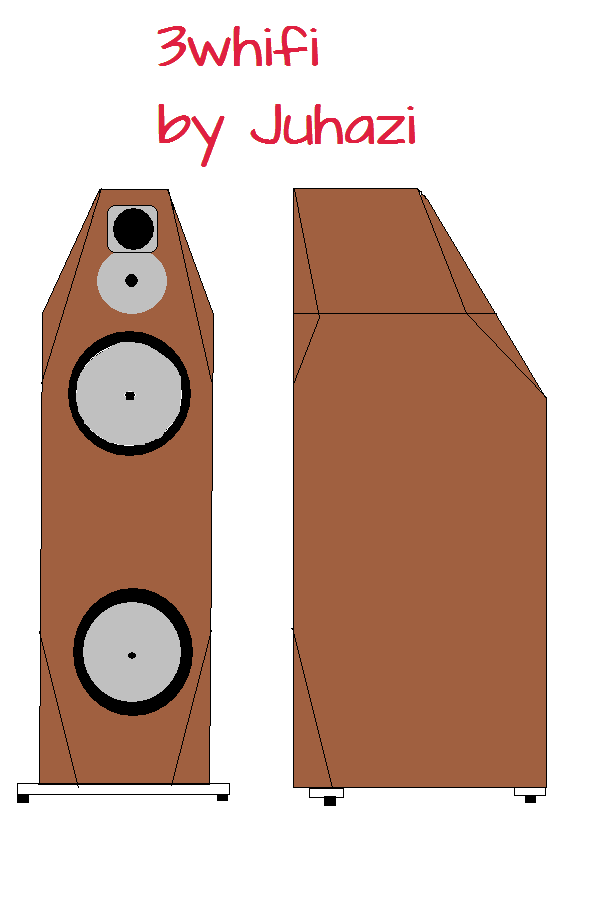

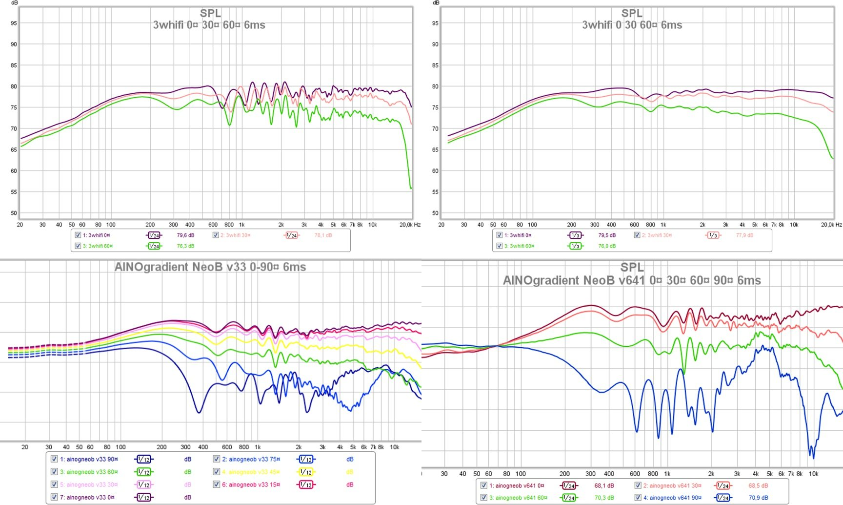

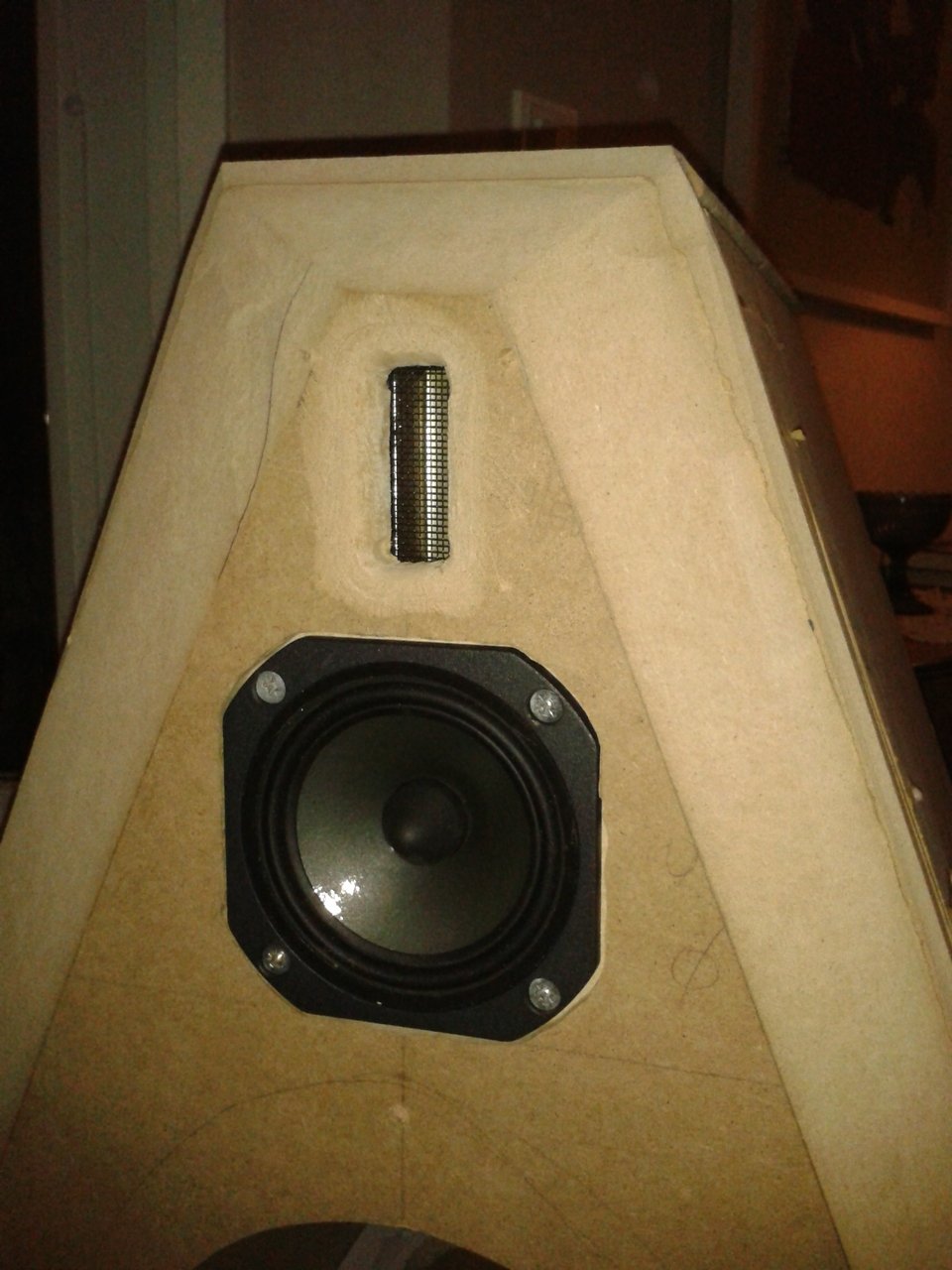

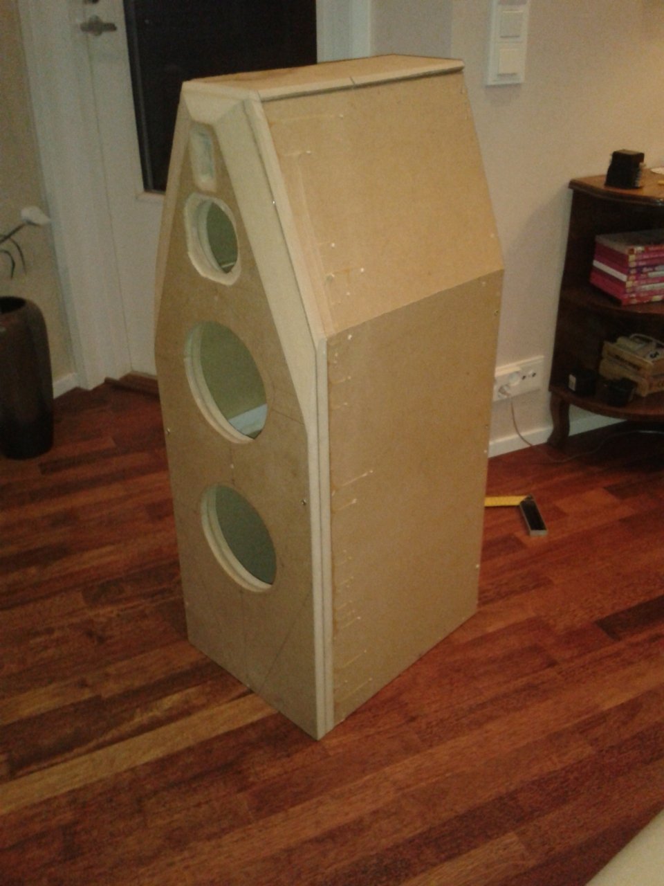

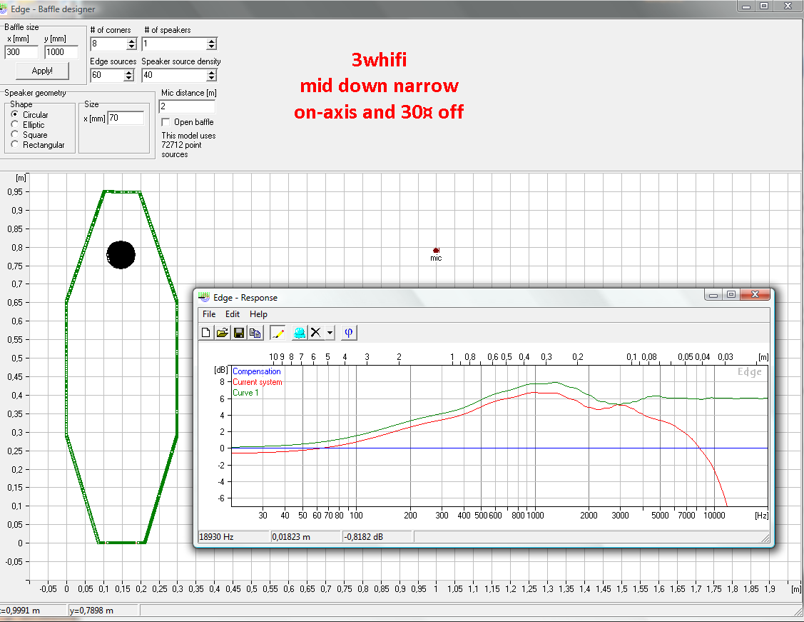

A test proto I made ten years ago, mid 4" Audax cone, tweeter Fountek ribbon in shallow carved wg. Final woofers were supposed to be 10" and box like Avalon Time. I took many measurements with different edge shapes. But then I realized how big they are and that I don't need them... And some years after that I found a faulty pair of stone-cabinet WWMTM that I modified to dsp-active WWMT, they serve as bedroom speakers now
3whifi sketch.pngEdge mid onoffaxis.png3whifi proto cabin mt drivers.jpg3whifi proto cabin.jpgaudax fountek 0-90¤ collash.png3whifi 0 30 60¤ 6ms vs ainob v3 v6.jpg

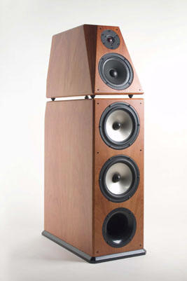

Both yours and hifijim´s creations look very alike Albert Von Schweikerts VR-4 speakerdesigns from1995-96.
I had a original pair from 1998 that Albert upgraded in 2001.
This $3 K pair of speaker has been my referencespeaker sinse 2001, so sold my $25.000 usd pair Revel Ultima Salons first gen.
So this consept have huge possebilitys to play real hi end sound!
