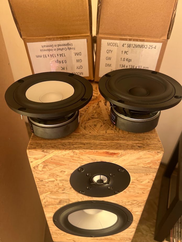

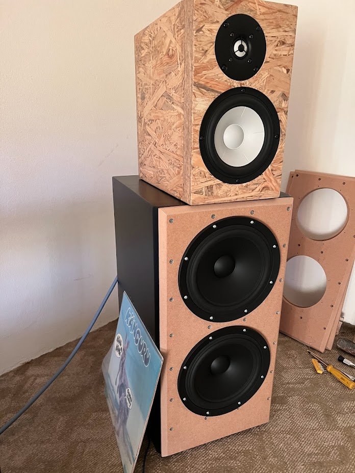

Check the look... 🙂 My version of "pyramid head" with added bass bins....I'm thinking about this for a longer time and for this black friday I bought two little buggers SB12CAC and SB12MNRX to try to complement already existing 3 way protoype....

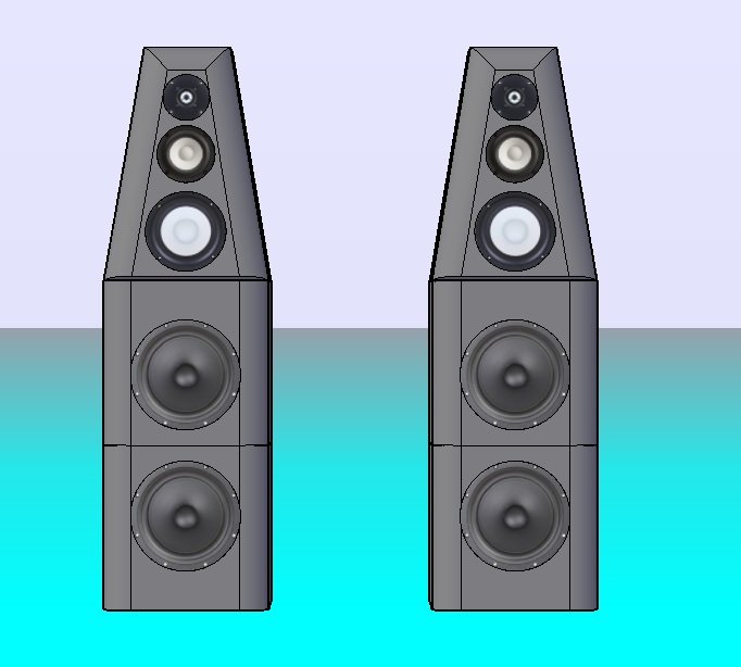

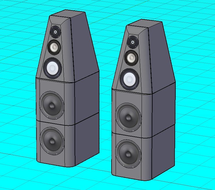

This is CAD model of rather large 4 way with two SB23NRX in 30+30 litres bass bins, and SB17CAC, SB12CAC and SB26CDC in 40 litres pyramid...
With very thick walls speaker dimensions would be 35 x 45 x 120 cm...or 70 cm height for bass department and 50 cm for upper drivers....
hifijim, you will have smaller pyramid with big bass units and you should somehow harmonize dimensions to have soft transition between middome and bass bins to keep diffraction low...

Now it's starting to look uneasy on the eyes. Something about the proportions. I'm no architect or interior designer, that part is clear. But I think it's something about the proportions.

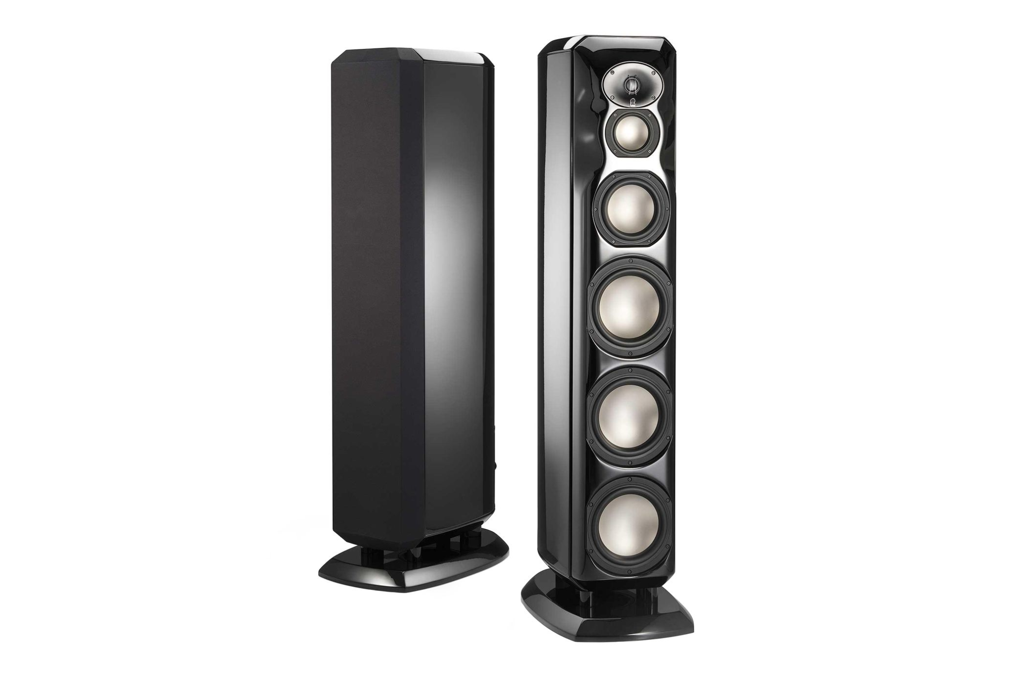

Now we're starting to look like Revel Ultima Salon 2 baffle... which I think would be easier to 3D print or alu CNC, at least for the upper 3 drivers:
They really the ball out of the park with this design:
30 years ago. Quad amped. EQ'ed.

as they radiate into 3D space, are set in stone (veneered MDF?) once the cabinet is made...
I am about to make tests with a baffle covered with melamine foam and alternatively with wood/mdf. Final baffle will be covered with fabric for pleasing visual design.
Exchanging all baffle or parts with melamine/wood/other open cell foam material (several sheets?) will allow adapting of baffle influence, at least that's my idea ...

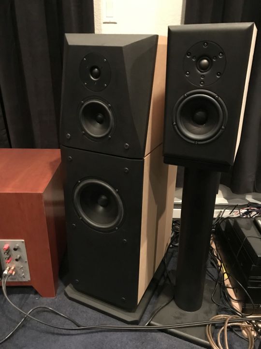

I'm only on the 2nd page of this thread. However, I wanted to throw out my example of a split cabinet and trapezoidal baffle. The midrange/tweeter cabinet sits on the 2 cu ft woofer cabinet. I use 1/4" Sorbothane pads between the two cabinets. No other fasteners.

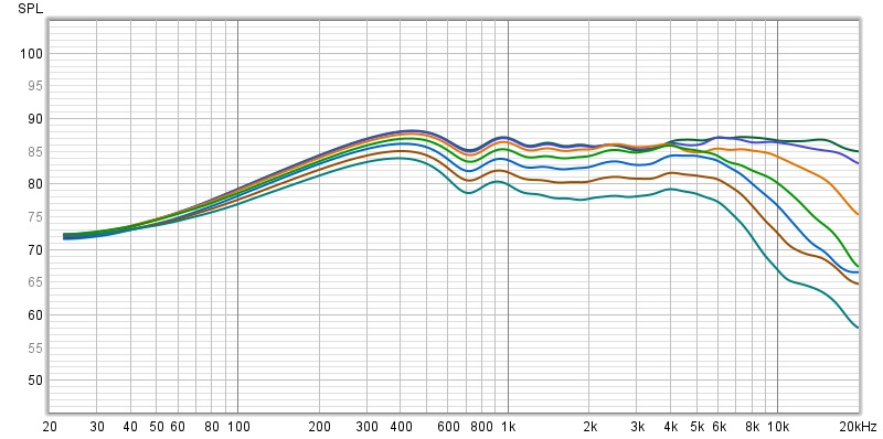

I'm running everything active with a miniDSP 4x10HD. Crossovers are at 400Hz and 3000 Hz. Here is the latest directivity measurement I made.
The drivers I used were a Vifa set I picked up in the mid-aughts (P21, P13 and D27TG). I work really slow. I recently purchased four SB29NRX75-8 10 woofers to upgrade, two for each bass box. They will be sealed and I'm shooting for about 50 Hz without any EQ since subwoofers will be part of the system.
