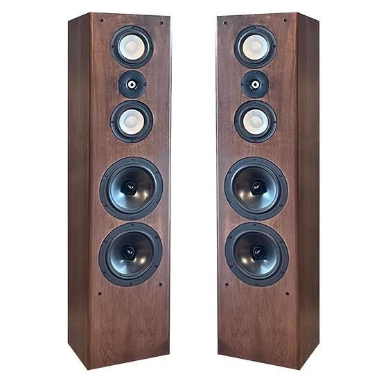

I agree that twin 8" ported can be a very satisfying.
Used repeatedly by Curt Campbell and @jholtz in designs such as the Statements, Statements II
and Anthology , Anthology II:

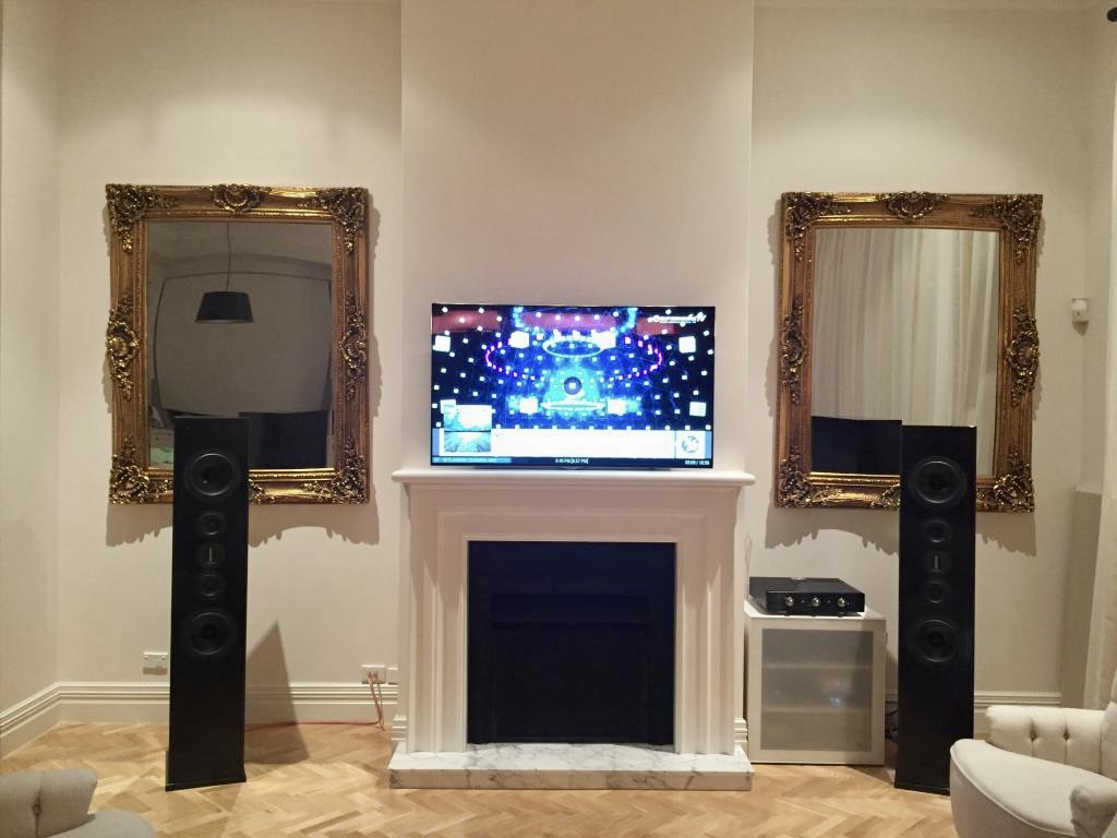

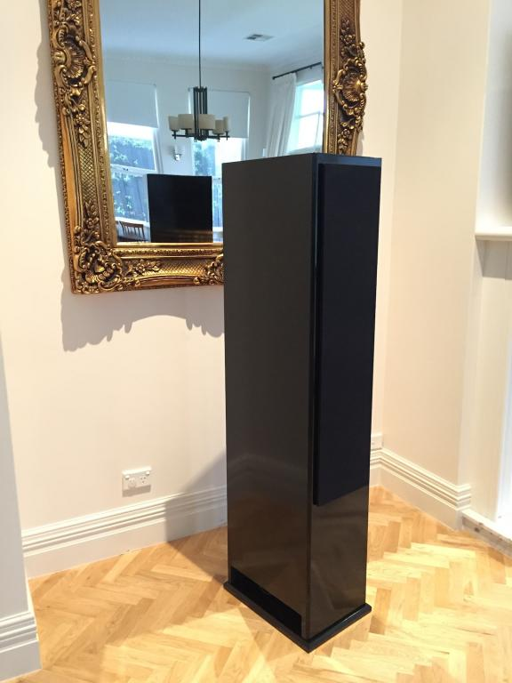

You can build them with down firing ports, as I did. Works well in a 6x9x3.2m room:

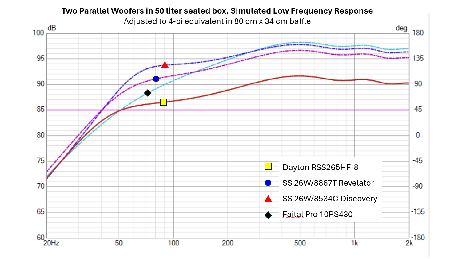

All of the four woofer options will require a similar level of boost at 30 Hz, but I was interested in what the gain and EQ would be like over the whole range.

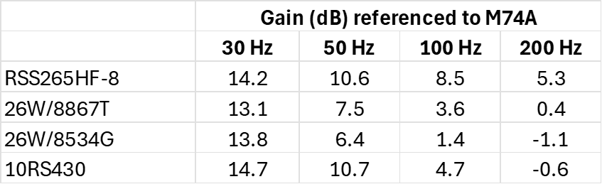

Here is the response of each of the four woofers, adjusted to 4-pi anechoic. All four woofer options are modelled in a 800 mm x 340 mm baffle, which is approximately what this project will use. In all four cases, two woofers are wired in parallel, in a 50 liter closed box.

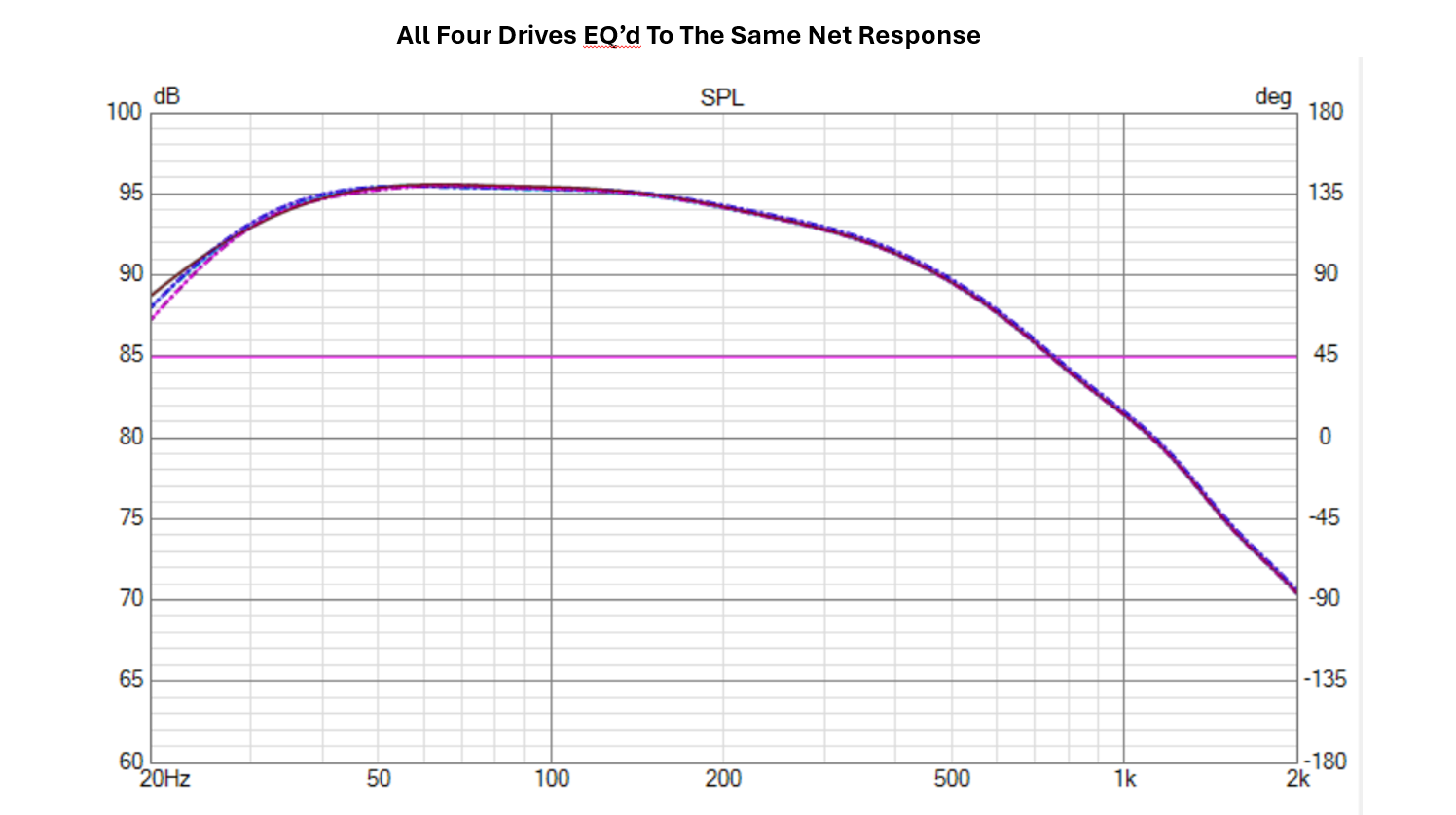

Next I show an example of applying baffle step compensation, LT bass Eq, and low pass 2nd order filtering at 500 Hz. I also adjusted the gain to match the 95 dB sensitivity of the Bliesma M-74A driver. All of this EQ is notional and approximate, the actual EQ will be based on measured driver performance of course. But the point here is that this process was repeated for all four woofers.
Comparing the net results of all four fully EQ'd drivers, they are all the same.

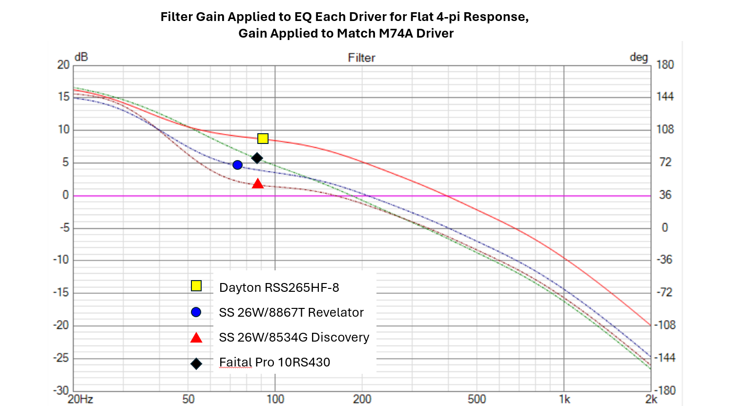

And now we get to the interesting part of this analysis. Here we have the filter gain which must be applied to each woofer to achieve the desired response.
At 30 Hz, there is not much difference in gain. The lowest is the 26W/8867T revelator, and the highest gain is the 10RS430, and the difference from highest to lowest is 1.6 dB in gain.
The RSS265 and 10RS430 have very similar gain requirements up to 50 Hz, and the two Scan Speak woofers are also similar to each other with the Discovery needing about 1 dB less gain.
By 100 Hz, there are differences. The RSS265 requires the most gain, while the Scan Speak 26W/8534G Discovery requires the least gain. The Revelator and the Faital Pro are similar to each other. By 200 Hz, all the drivers are similar at near zero gain, except the Dayton RSS265, which requires about 5 dB.
I am still thinking about what this all means. The RSS265 is definitely a voltage and current hog, and it needs some power. However, the pair of RSS265s in this analysis are actually very close my current SB34NRX75-6 12" woofer in terms of sensitivity and efficiency. The SB34 has about a 1 dB sensitivity advantage over the pair of RSS265's. So although the Dayton RSS265's seem like the oddball when compared to the other three 10" woofers, I do not foresee any real problem with using it in this application.

Looking at the gain chart I think the difference between a sub-woofer, a pro mid-woofer and a woofer is vey clear. Above 100Hz the sub-woofer needs more power to move the heavy cone and at 200hz it struggles even more. That is why I had asked if the sub-woofer would be the best option for crossing to a 3 inch dome at 500hz. By the way, I use pair RSS265HF-4 drivers in 25 liter sealed boxes for subs, they are nice subs but I cross at 80hz.
Nice analysis! As you need the 30Hz part, and the boost differences there are marginal, I think discriminating on this isn't necessary. Another point to consider: are you going to run both 10" woofers up to 500Hz or are you going to cut the lower one?
Reactions: hifijim
Yes, it needs more power, but the power required is relative. And power is readily available.
Let's say I used a single 10PR430 and a subwoofer. The single 10PR130 would need about 6 dB of gain to match up with the midrange driver, and the subwoofer would likely need another 6 dB of gain to match up with the 10PR130.
When a high output compression driver with a large horn is matched up to a woofer, the woofer is going to need a lot of gain... Typical CD sensitivity is 104 - 110 dB, while large PA cone drivers are 95 - 100 dB... and considering the woofer/midrange cone will need some kind of low frequency EQ, well, it is not that much different than the situation I am contemplating.
Am I missing something ?
j.
Reactions: JukkaM and mayhem13

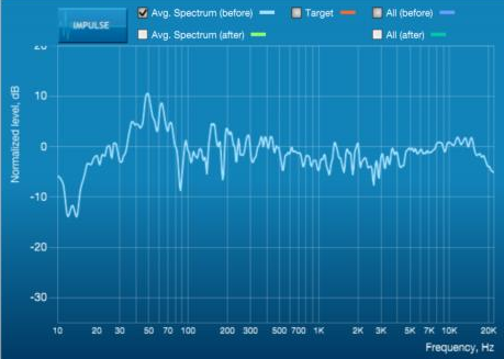

The room.

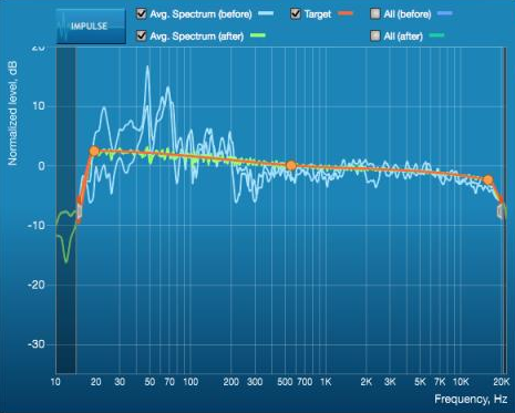

Here is the 1m measurement of my Statement II, in my room (2015), miniDSP Umik-1 mic with supplied calibration file, Dirac Live 1.0 software for PC.
Rear of speakers 2 ft from wall.
Here is the measurement of both speakers at the LP (~10ft IIRC).
That response below ~400Hz (Schroeder) is just wild! Swings and peaks everywhere.
But clearly gets down to 20Hz in-room.
And, the top octave rolls off a little. All it in, it sounds REALLY good. I only sold it because of a house move.
4pi anechoic is not a good estimate in this case. 2pi is probably closer.
I know one designer who doesn't model for bass in 4pi, perhaps now I can see his point...

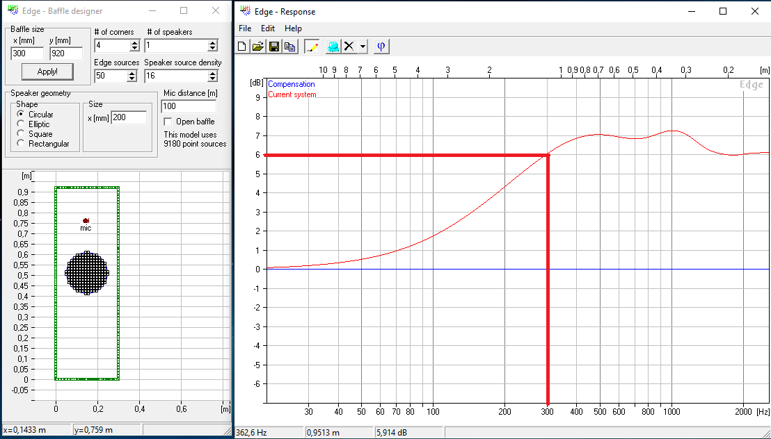

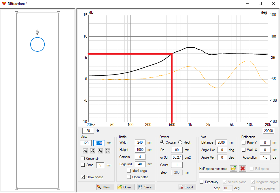

With the amount of bafflestep correction, there is tonality/neutrality tradeoff between direct and indirect sound. For small 2-way speakers, I do almost full correction (leaving a dB or so), because of the small baffle the step starts in the midrange. No correction would lead to very thin direct sound coloration. (Nearly) full correction then appears more neutral in direct sound, but overall "darker/fuller" then from the indirect sound; but more right in sum for my taste.
My eye on larger floorstander baffle sizing is to keep the 2pi -> 4pi transition in a range a) below typical room Schroeder Frequency, e.g 300Hz b) below xover frequency to midrange, e.g. 300Hz:
So all sound above schroder frequency from the lower mids on has less tonality difference between indirect and direct sound. Below schoeder frequency, I can voice to the room and speaker placing by focusing on the woofer channel (or even woofer placing on the baffel vs. room placing). Further, midrange works just in 2pi and must give less duty. I also would keep the "small" separate baffle for the mid wide enough to avoid large difference in bafflestep within the mid's operating range. Wide radius/facets yes, too narrow no...
I personnally would size the smaller baffle for the mid and tweeter 24cm wide with large radius and the mid placed 18cm from the upper edge:
The midrange will operate then completely in 2pi, so it has less burden and jump in the directivity to the woofer section (has wider baffle) gets avoided.
Overall baffle directivity influence above follows then the "inverted Zwicker Curve" (dotted yellow line) as a compromise to tradeoff between direct and indirect sound perception. I once summarized it here (klick + scroll down):
