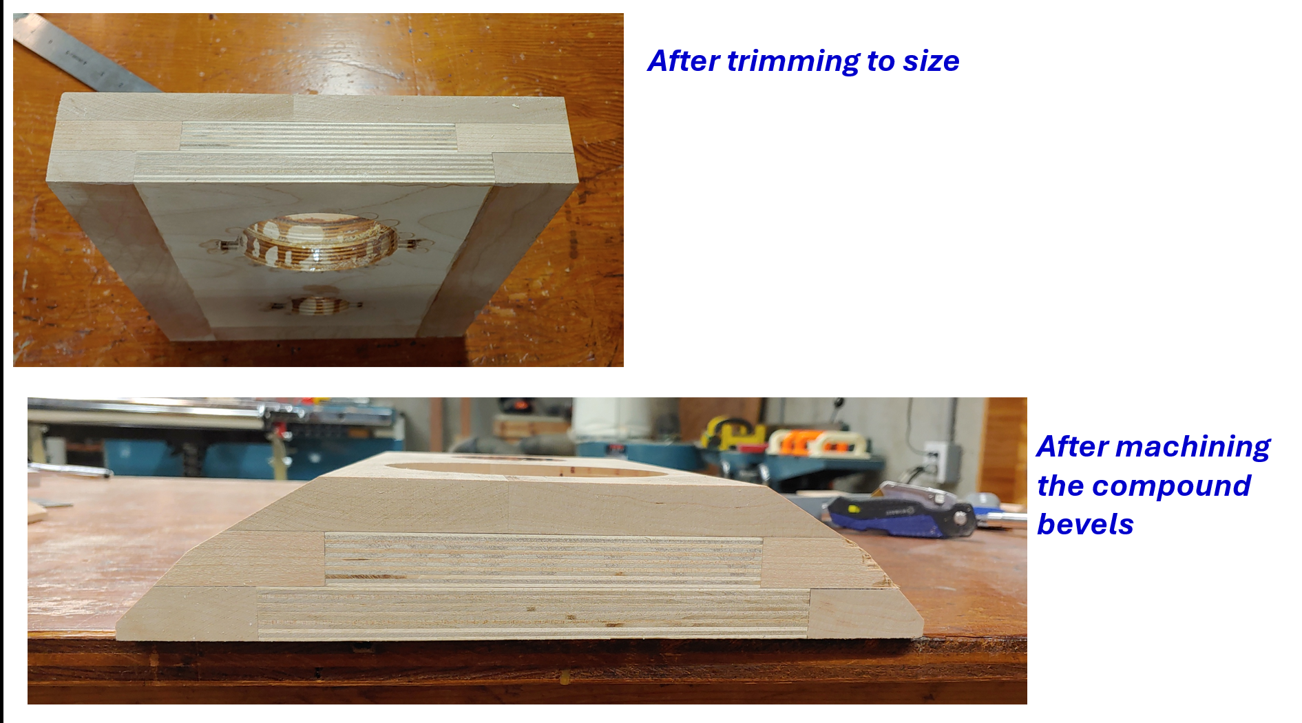

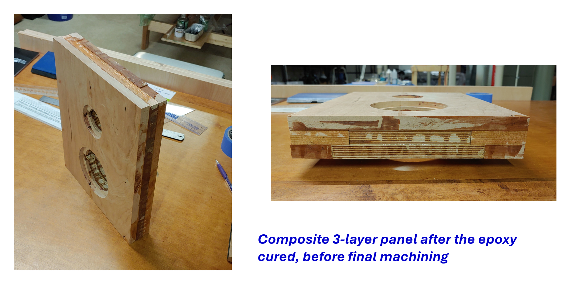

The MT baffle is 55 mm thick. My Baltic birch plywood was 18.3 mm, so I ran the cherry boards through the thickness planer to 18.3 mm to match.

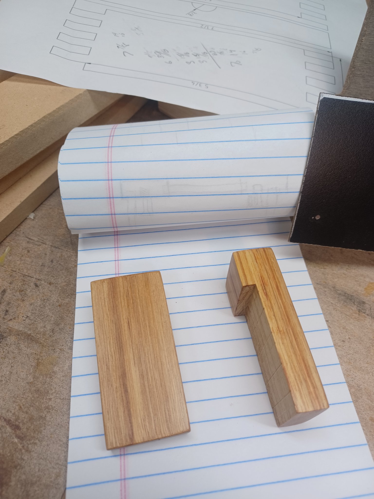

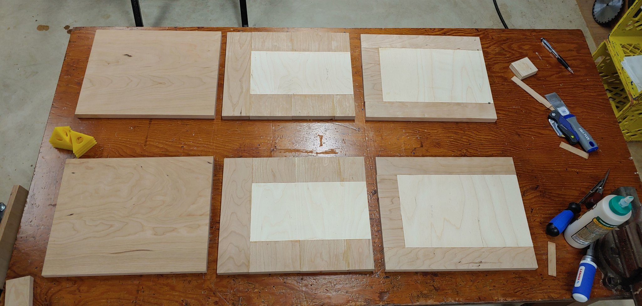

Here are the layers of the MT baffle before glue up. The outer most layer is solid cherry. The inner layers have solid wood on the outer edges, with birch ply at the core. The solid wood was arranged so that the grain direction alternated with each layer.

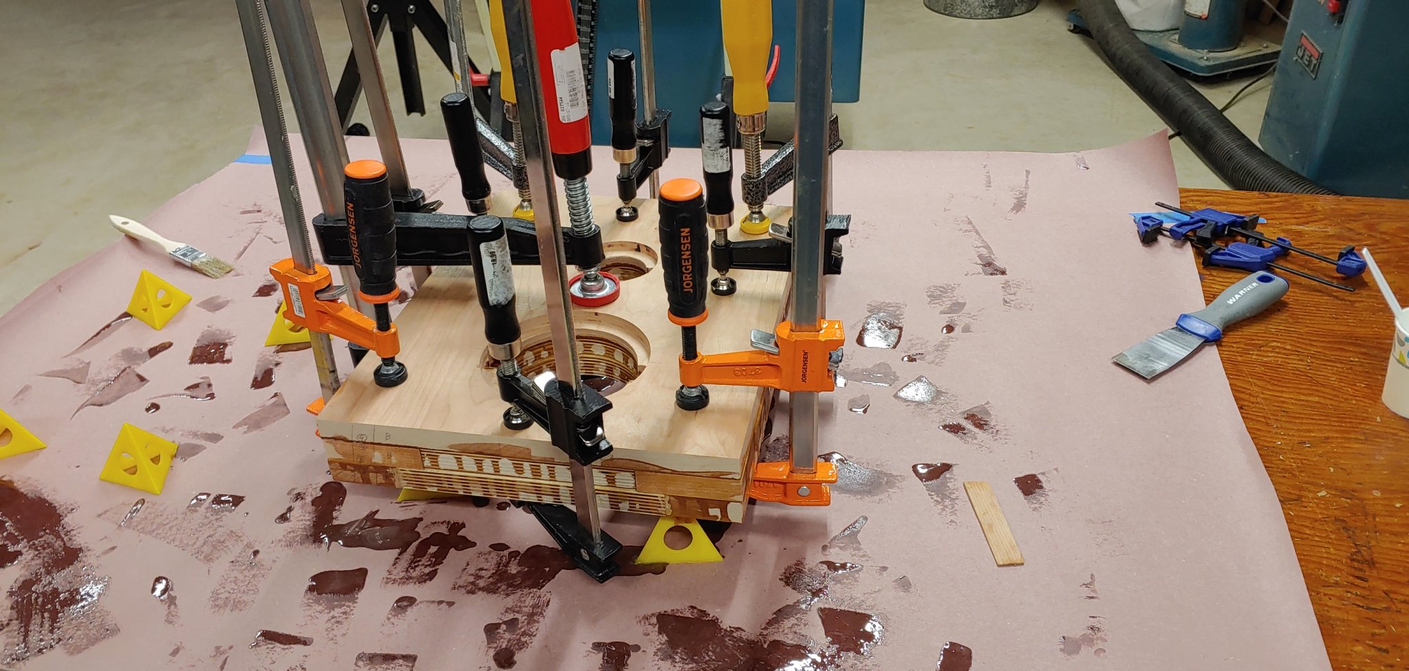

Here is the three layers during the glue up process. I used West Systems epoxy for this step. I knew that I would not be able to maintain perfect alignment, so I oversized each panel and machined to final size later on using a table saw.
It takes 72 hours for the epoxy to fully cure. In the past I have made the mistake of cutting/sanding epoxy layups after just 24 hours, and although the epoxy feels hard to the touch, it softens under the heat of power tools. It gums up sandpaper and saw blades and does not machine well.
After the panel was trimmed to final size, I cut the compound bevels. I talked about this earlier in the thread
j.

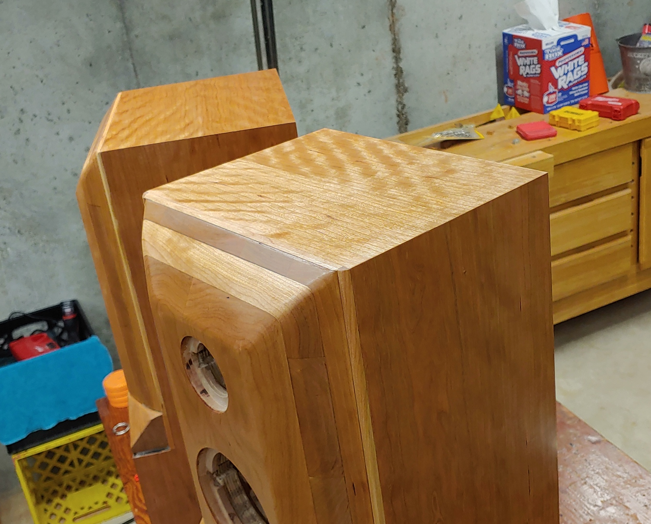

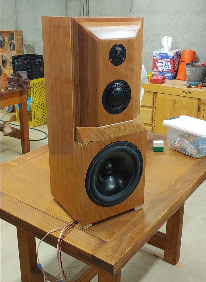

I finished the edge trim except for one troublesome spot. I have 2 coats of polyurethane satin applied.
I am pleased with the veneer that veneersuplies.com sent me. It has nice figure, and it matches the solid wood portions in color and character. I have been using this veneer vendor for many years, and I recommend them.

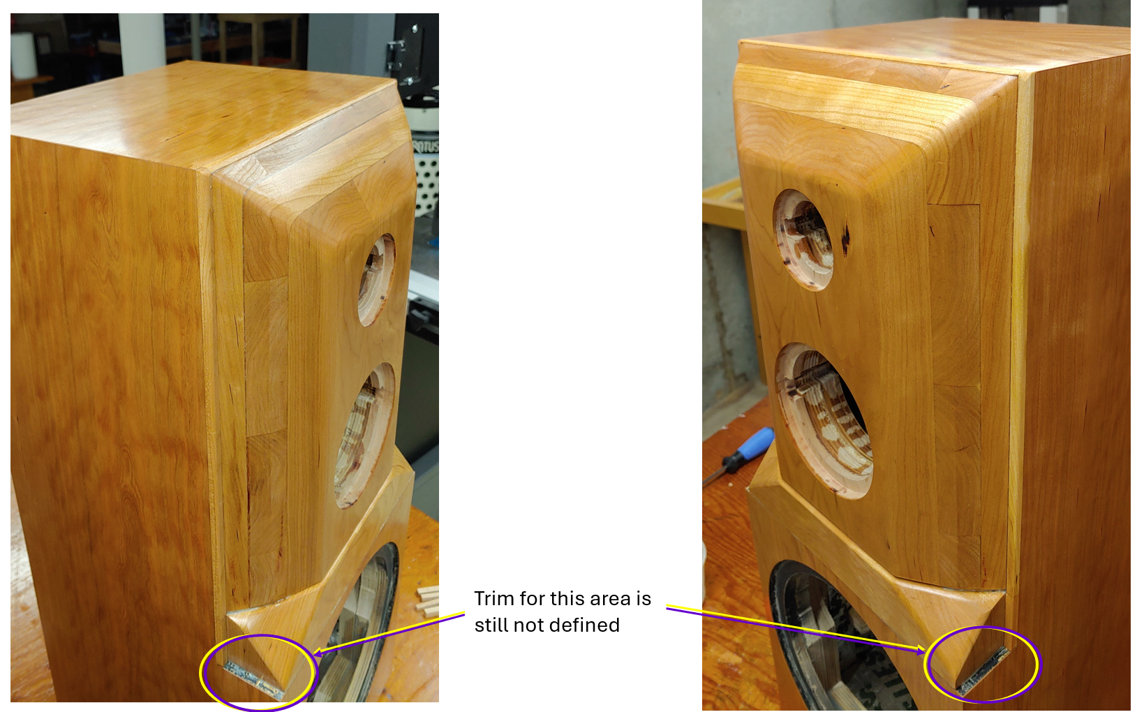

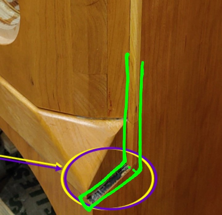

There is a troublesome spot adjacent to the transition block. I applied some wood trim there, but it did not look right, so I removed it.
I am still contemplating what to do. I might apply a thin strip of veneer or black laminate, or even paint it black. Fortunately, I only need to be concerned with aesthetics, there are no structural or diffraction considerations... so that makes it a bit easier to deal with.
In hindsight, I should have made the transition block the full width of the cabinet, instead of matching the width of the Mid-Tweeter baffle. I drew it both ways, and in the drawings, it looked better as matching the width of the MT baffle. But covering that 2 inch section of exposed plywood edge in a tasteful way is challenging.
I will do a final sanding with 320 grit, then one more coat. Then I will install the wool stuffing, the wiring, and the drivers. Measurements can then begin... Looking forward to that.

That is what I originally tried, but it looked surprisingly bulky and kludgy. I am experimenting with a much thinner strip, but it is not easy to machine such a thin strip with my equipment. I am also going to try some quarter-round to see how it looks. When I cover it with plack paper, it looks surprisingly good. So I am still thinking... Thanks for the suggestion.

The issues you're having with the epoxy are due to not having a bulk filling agent in it. The material ends up curing into a soft plastic type of consistency, which smears and loads up tools when working it. I prefer to use sawdust mixed into it

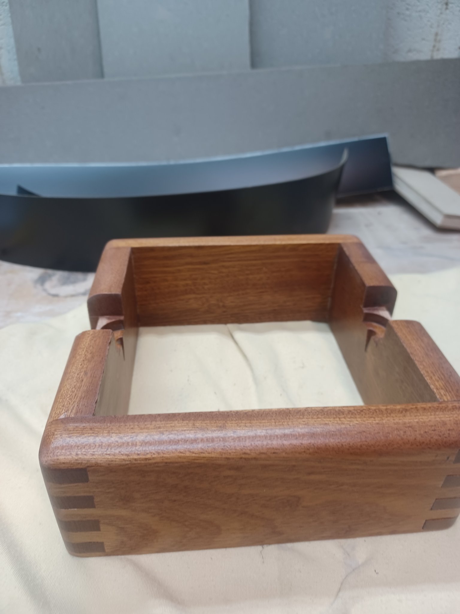

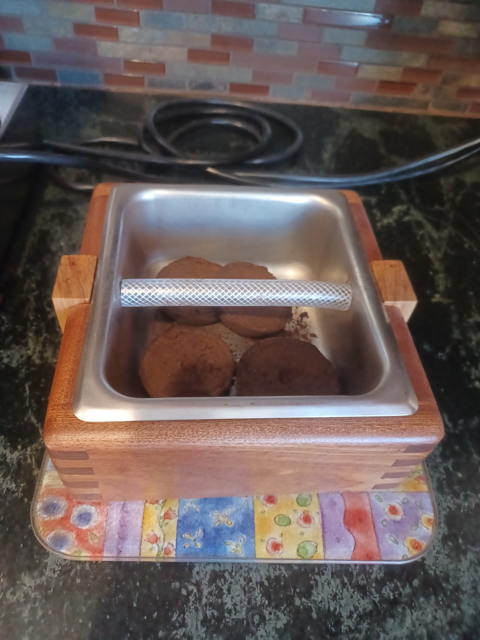

When I mistakes like this Rather than try and hide, make it a feature by using a contrasting piece or maybe a piece of brass. The idea would cut out the area of the mistake and make it larger and possibly route other areas and add the contrasting pieces. Here is a espresso knock box that I did this on by adding the canary wood to the sides, it actually improved the look giving it an art deco look.

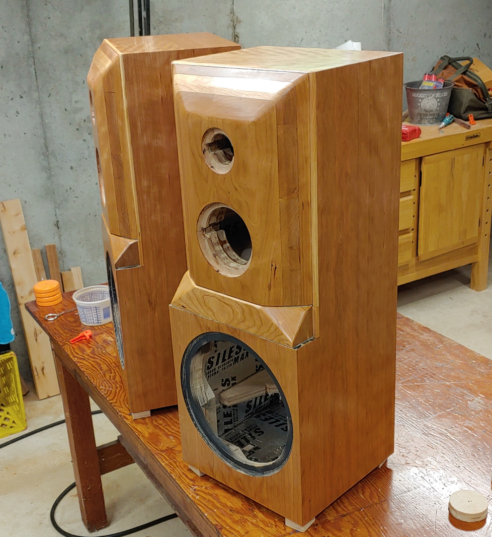

A couple of days ago I applied the final coat of polyurethane varnish. I am very pleased with the results. Normally I do a final polish with 0000 steel wool and wax, but I don't think I am going to do that this time. The 320 grit sanding before the final coat really smoothed the surface so the final coat went on like glass... I am fearful that any further polishing would only decrease the finish quality.
I ran wire for all three drivers. When I make active speakers, I wire all drivers with positive polarity, and if any of them need to be reversed, I handle that with the DSP filtering before the amps. I find this reduces potential confusion.
There are two holes in the bottom of the speaker. The wiring exits the speaker through a hole which is offset to one side and is sealed with silicone. The second hole is in the exact center, and this one has a 5/16" T-nut fixed internally. The speaker will be attached to the stand with a 5/16" bolt.
The cabinets were stuffed with natural sheep's wool. I normally stuff at a density of 16 g / liter, and with 32 liter enclosed volume, that is 512 g. However, after filling with 350 g, the box was completely filled so I stopped. If I find an acoustic resonance in future testing, I can always add more wool.
My source of wool is Mountain Meadow Wool. I pay about $45 for a 5 lb box, and this is enough to stuff 150 to 200 liters of speaker cabinets. My first 5 lb box was enough for 8 speaker projects. This is a short fiber wool, and I tease it / fluff it to a loose state before I put it in the cabinet.
I fitted the drivers into one of the cabinets, and testing has begun. I know someone will point out the screws I used on the tweeter so I will talk about it up front. The Bliesma screw recess on the T25 tweeter is a tight fit, and a standard pan-head #6 black-oxide screw will not fit into the recess. I had some #6 stainless steel screws, and those head just fit (barely). So that is why the tweeter has silvery screw heads visible.

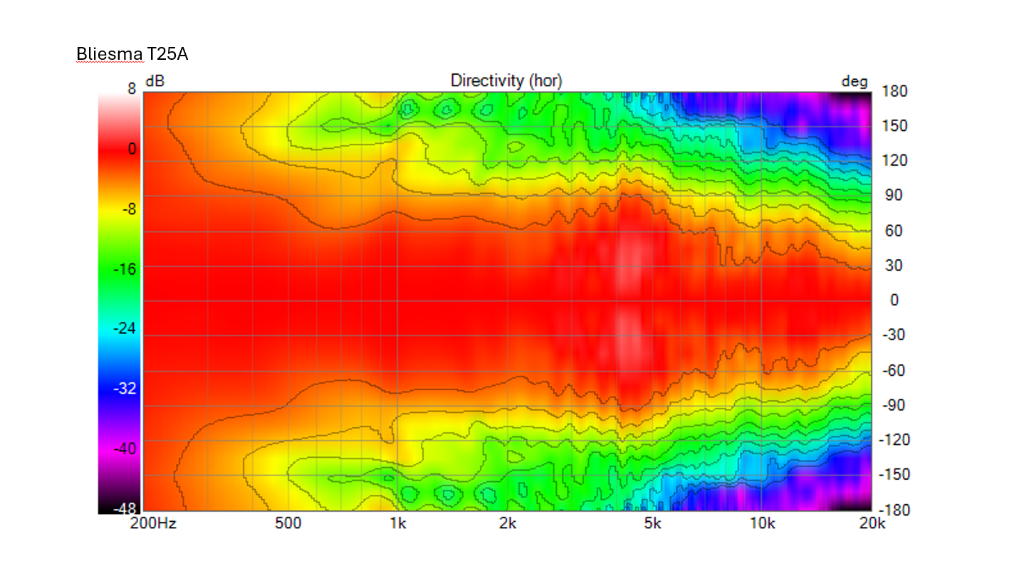

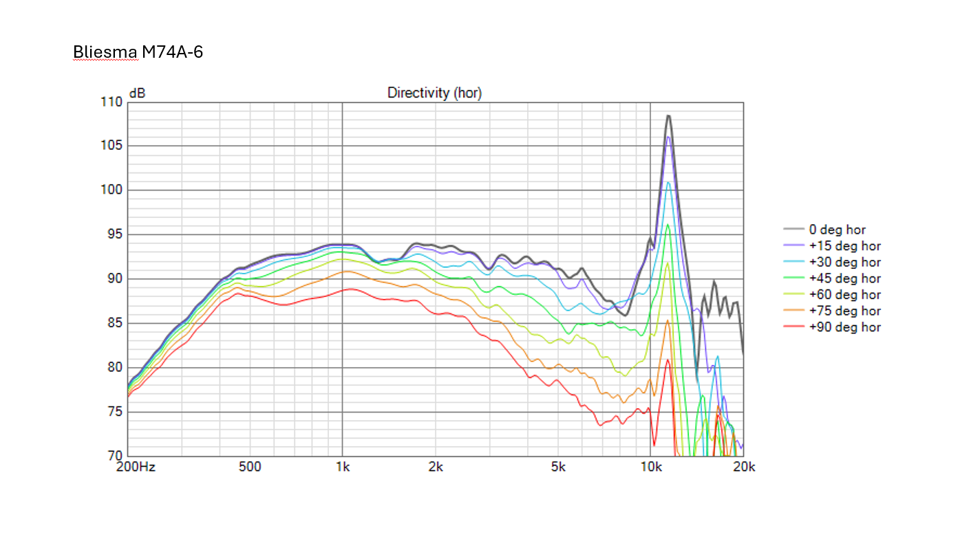

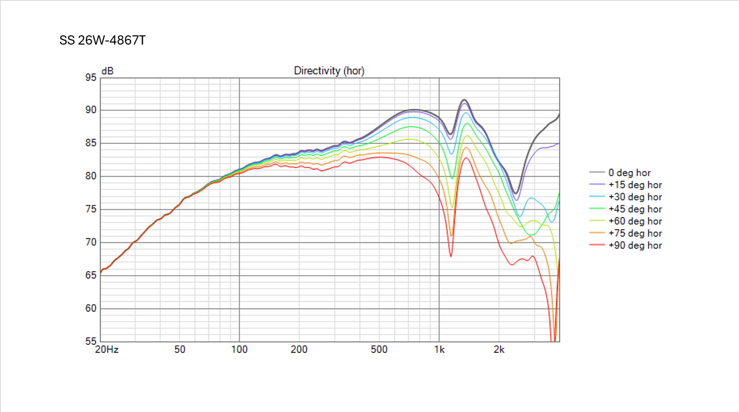

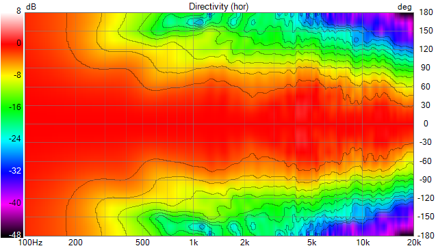

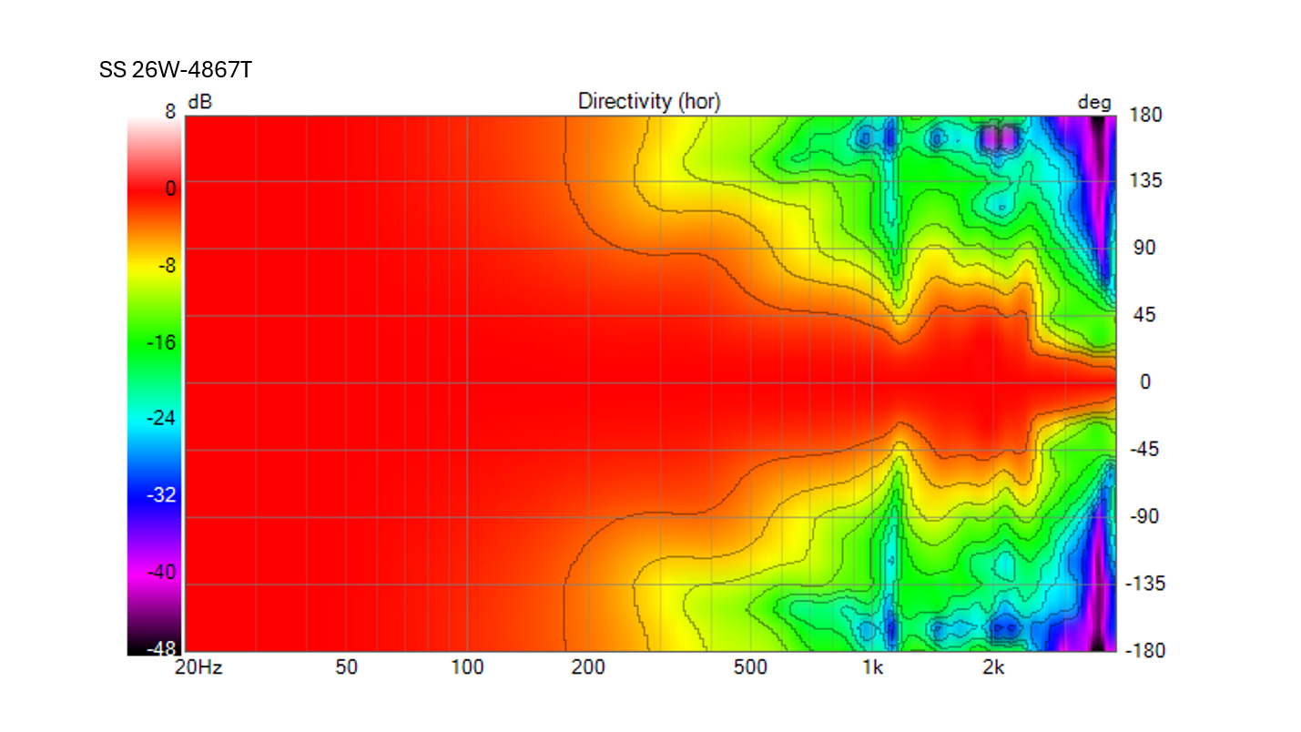

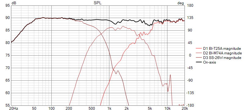

I made polar response scans of each driver, from 0 to +/- 180 in 15 degree increments. The drivers and mic were elevated 56” (143 cm) which allowed a very long gate time of 5.8 ms. I set the voltage level such that the woofer produced 88 dB SPL (A-wt) with pink noise. The SPL levels shown in the graphs are probably about 3 dB higher than what was actually measured and are not representative of 2.83 V @ 1 m.
I merged the gated far field scans with the near field scan, using the standard VituixCad procedure. I used the diffraction tool to model the diffraction response of each driver.
When looking at the graphs, be aware that the frequency range plotted for the woofer is 20 – 4k, and the mid and tweeter is 200 – 20k.

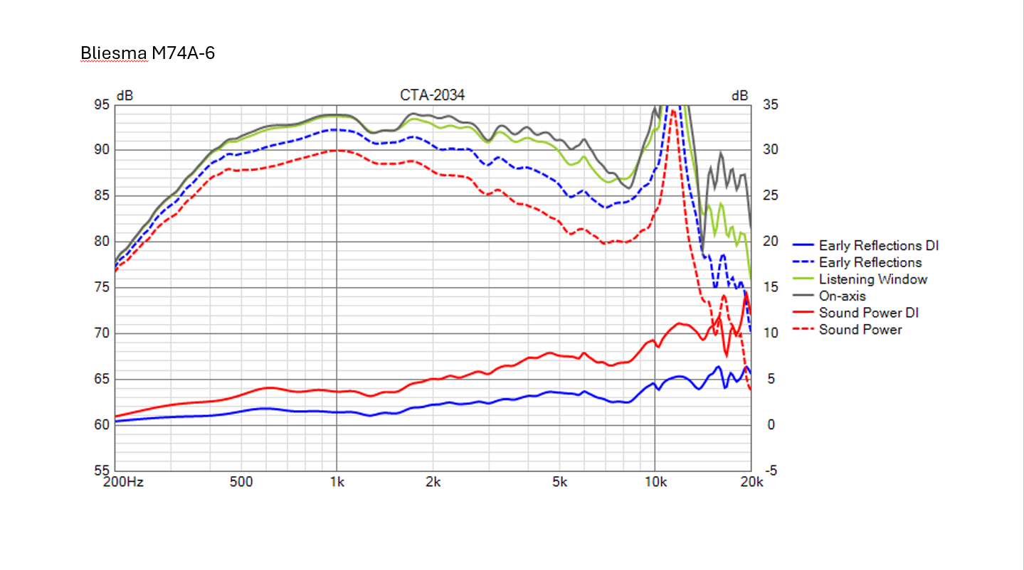

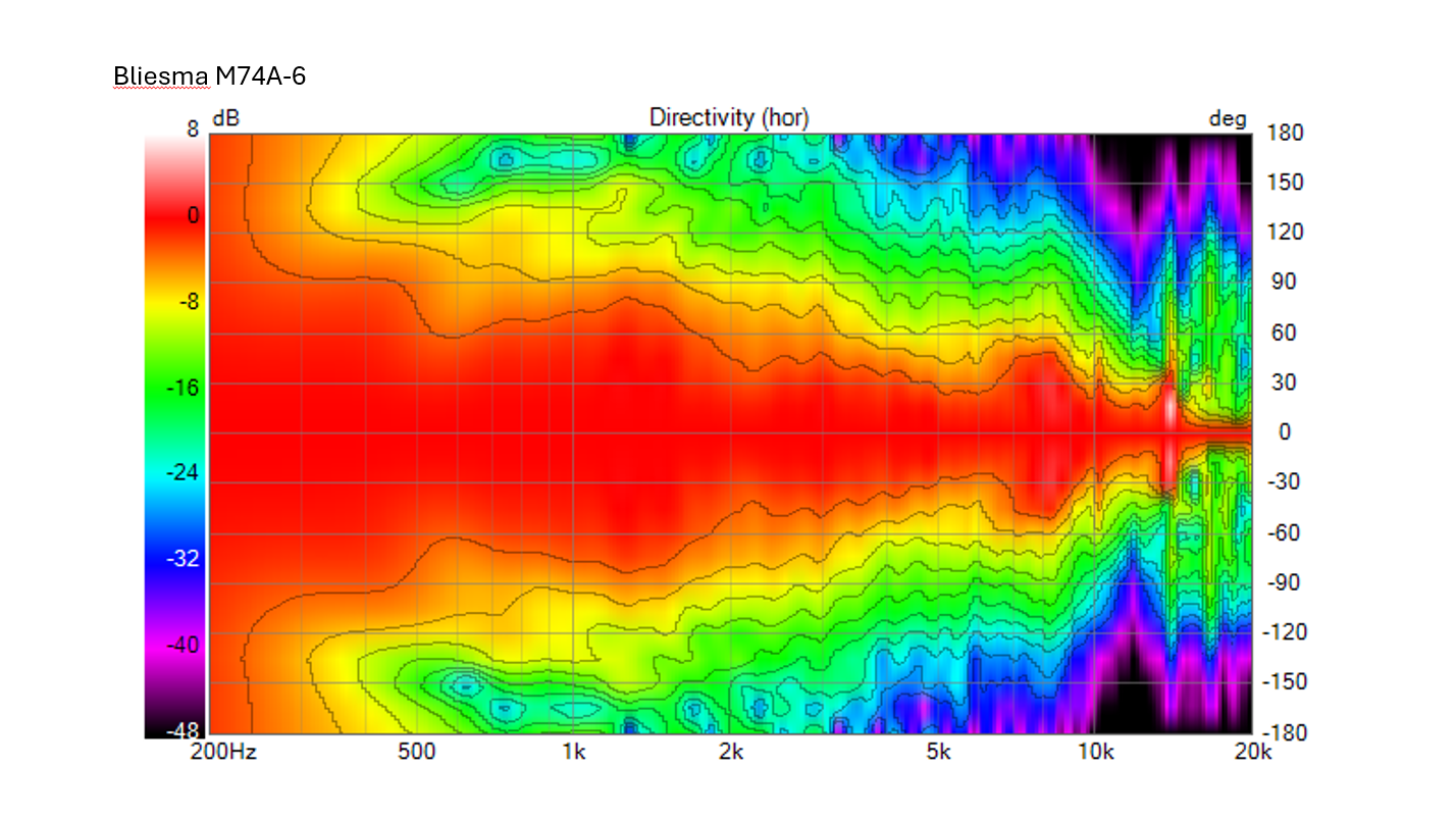

Overall, it is about what I expected. The midrange driver response is very similar to the prototype data I presented in post 257 and post 264 . One difference is the unevenness in the 1100 – 1700 Hz region, this was not present in the prototype. The main physical difference between the actual cabinet and the prototype is the presence of the woofer and tweeter. I have seen this sort of thing before where a tweeter response is affected by the cavity created by a woofer cone. This is the first time where I have noticed it in a midrange driver.

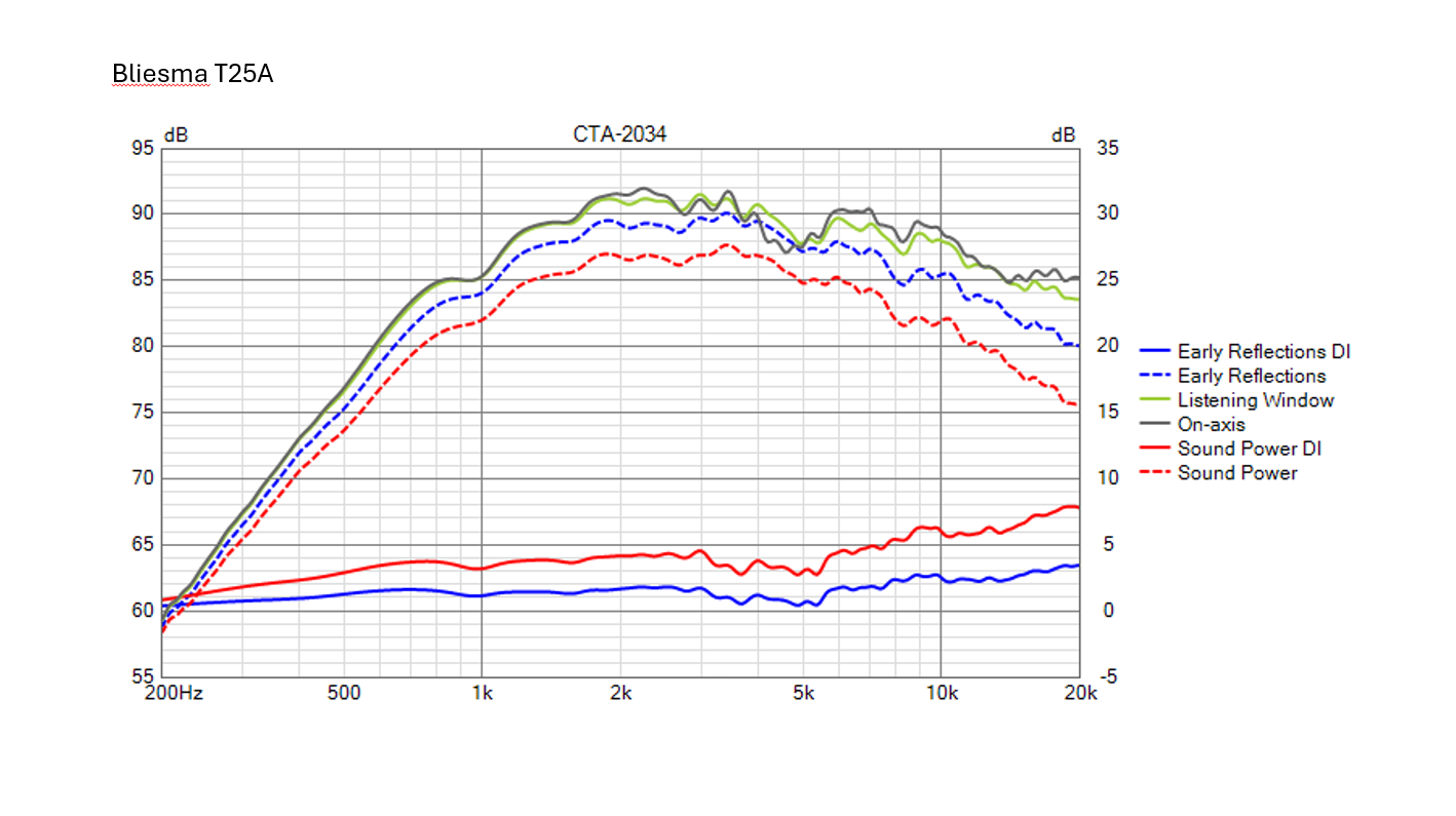

The tweeter response was a bit unexpected. The drop in level from 2k to 16k is about -7 dB, whereas the published data sheet shows about a -4 dB drop. Hificompass shows a -5 dB drop. I believe this is simply due to my baffle shape having a diffraction hump at 2k.
There is also the dip at 4.5k. Again, this is a diffraction effect that is only present in the +/- 30 degree range. At 45 degrees and beyond it is not present. Is it caused by the midrange driver? Possible, but I suspect it is the baffle edge.
Nonetheless, I am pleased with the driver responses. When I run these responses through the crossover simulation, I get an on-axis curve, a sound power curve, and directivity index curve which are within my target goals… I will show this in the next post.

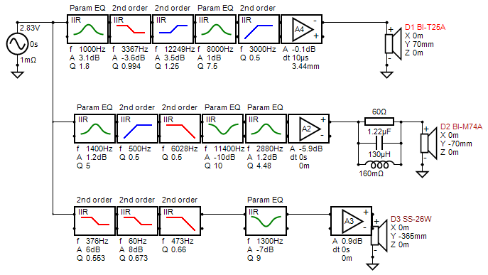

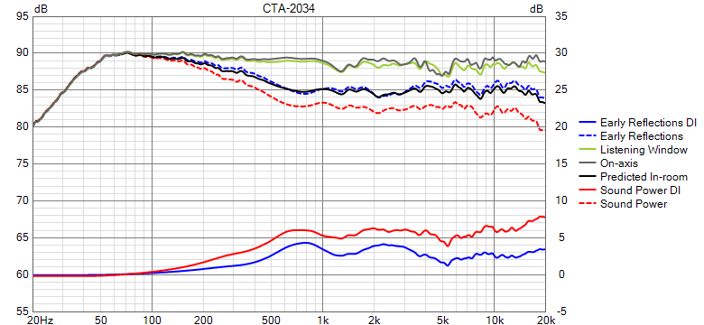

Here is one possible filter network. It still needs some refinement, and the subjective voicing process will change it a bit, but this is close.
I am currently modeling the system as a 3-way with no subwoofer. I plan to set up the Hypex FA-253 this way, and do the subjective voicing as a 3-way. Later, I will add the subs.
The most informative part of the simulation is it shows what the directivity will look like. There is very little I can do at this point to change the directivity index curve, so what we see here is pretty much what we are going to get. I am quite pleased with this, and it is very similar to the initial simulations I showed earlier in this thread.
