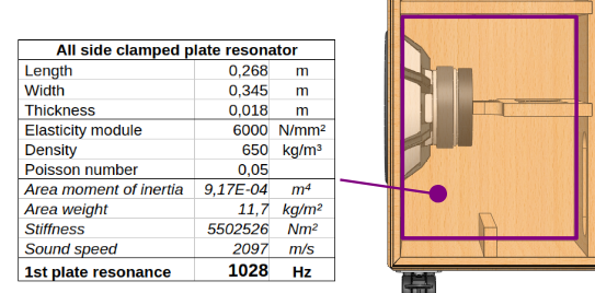

I made good experience to support woofers and mids with a bracket at the magnet to the back panel (with some butyl smeared into the tight gap to couple, helps also to damp). Significant less vibration of the front panel, at least "measured" with my fingers at higher volume. Back panel vibrates more, but overall sound gets cleaner.
I also care that the brackets divide the panel area so that the remaing "Plates" between the panels have a plate resonance that is significan higher and out of the passband of the driver. As you said, increasing the mass by e.g. butyl sheets or similar that the resonance is lowered so that it reaches the driver's passband again would be contraproductive.
Some rough example of a typical free area part of panel shows that these resonances occur mostly in the midrange. So the mid woud be my preferred canidate to decouple from the enclosure, if such measurements come in consideration. Or give the mid a separate enclosure to decouple the structural resonances from the large bass cabinet that has much more wall area, and has so small panels that their resonances are much higher than the passband of the mid.

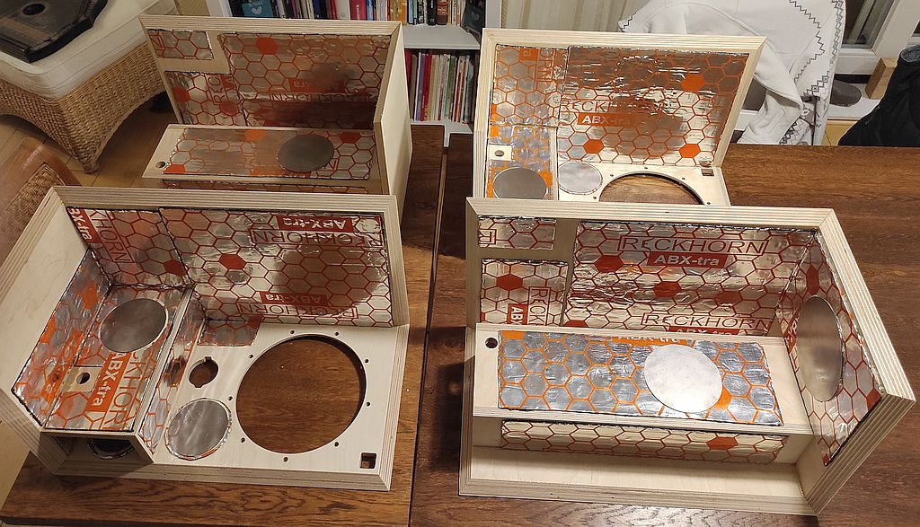

You might better have placed the butyl between the enclosure panels and the braces, as KEF with their FEM analysis have shown.
Yes this is also a good idea. I had put his thing here in a speaker tensed between the side walls and glued on the Aluminum-Butyl sheets after assembly. Cabinet got very quiet.
Not by hand but I will do a quick search. From a force equilibrium pov it makes sense anyway, the forces are a magnitude bigger than those of the enclosed air on the panels.Do you have some source?
Two things: if you have such high amplitude resonances, you’re doing something wrong in the internal damping that probably will emerge through the cone or port, rather than the enclosure wall. And it’s not that likely that such resonances excite panel resonances at exact that spot and frequency range. So in essence mass law transmission loss applies for perpendicular incidence (very simply put) and any reasonably heavy panel will dampen enough.I had guessed most critical is modes of the sound in the enclosure, where the pressure knots sit on the cabinet walls and excite them.

The butyl-alu sheets you use appear to be rhe same i used. But no longer, as over time the butyl softens to a thick paste.Yes this is also a good idea. I had put his thing here in a speaker tensed between the side walls and glued on the Aluminum-Butyl sheets after assembly. Cabinet got very quiet.

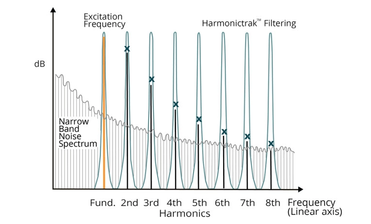

Much of frequency dependent vibration shows up in the Harmonic Distortion Plots as second or third HD. Personally I do not believe that it is always audible. It can often be measured.
Back when the 6-1/2 inch Purifi drivers were new I fabricated a closed test enclosure and made some test measurements and found some peaks in the FR and HD curves at aprox 450Hz, 900Hz and 1350Hz. Scratched my head and sinched down on the screws into the T-nuts pulling the driver tighter to the enclosure front. The distortion peaks got worse. I loosened the screws and the distortion peaks improved. I completely removed the driver and added a 4 mm closed cell neoprene gasket and pulled down the screws "just right" and the "distortion peaks" all but disappeared into the measurement floor.
I also ran some Rub and Buzz plots of the above test setup, there were spikes in the plot that were also removed with the thicker closed cell neoprene gasket.

The vibration will show up as "harmonic distortion" in a distortion plot. It will show up as spikes in a Rub and Buzz plot. It may also show up in the impedance plot as resonance peaks. Turn off all the processing, curve fitting and smoothing in the impedance measurement software.

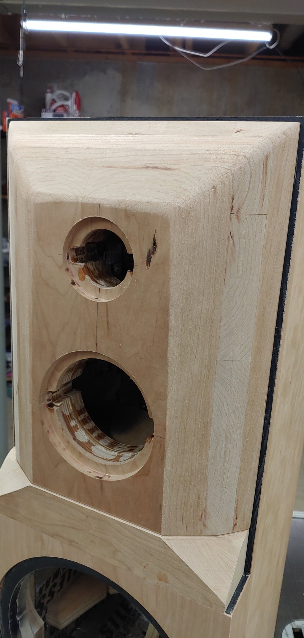

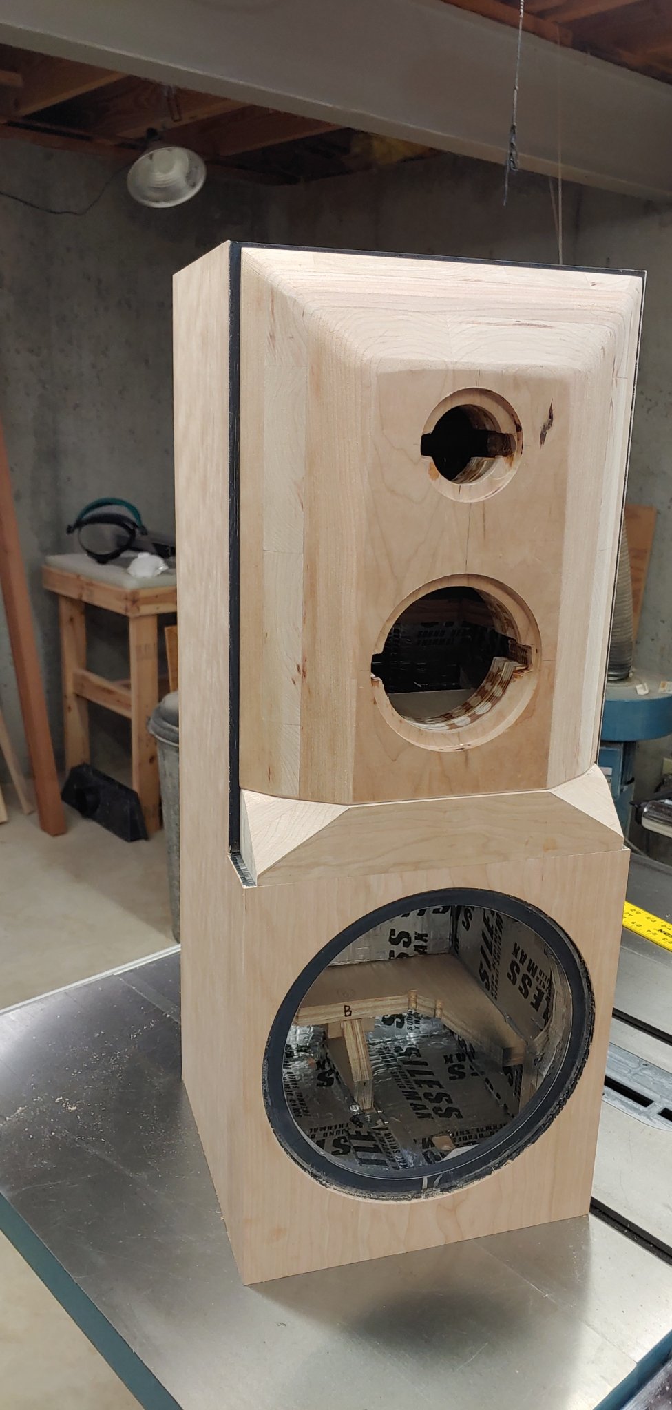

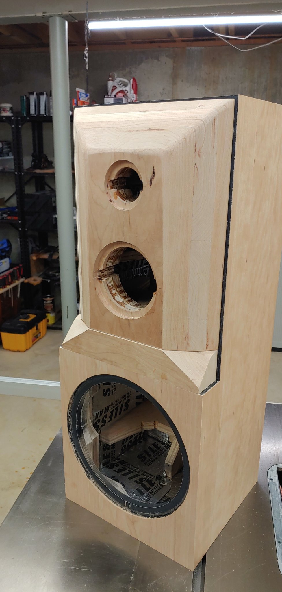

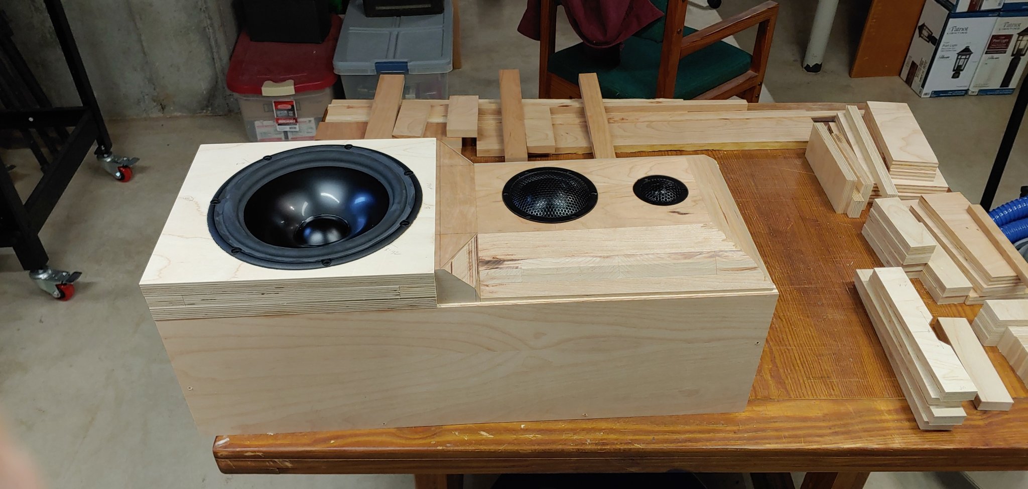

More construction photos:
Below is the inner carcass fully glued up. The first layer of the woofer baffle is attached.
Below is a trial fit of the baffles with all three drivers - nothing glued or attached at this point. There are three sections to the baffle, the mid-tweeter section, the transition block, and the woofer baffle. The mid tweeter baffle and the transition block were completed some time ago. The parts for the woofer baffle were just machined. In the photo it appears that the woofer is positioned ahead of the midrange, but this is an illusion. All three drivers are in the same plane.
Next steps are to glue up the woofer baffle and sand it flush with the main carcass. Then I need to do finish sanding of the mid-tweeter baffle and the transition block. Next I veneer the main carcass and woofer baffle, then I attach the mid tweeter baffle. Finally, I apply some trim around the perimeter of the mid tweeter baffle.

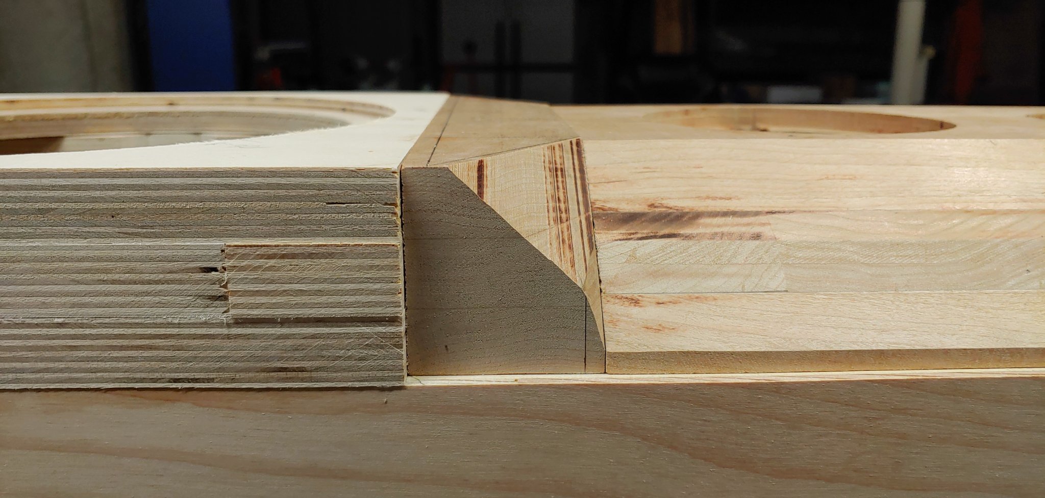

Here is a close up side view of the transition block, with the woofer hole on the left side. The M-T baffle is recessed by about 1 mm, but that will be taken care of during trim and finishing. Other than that, all three drivers are in the same plane.
It is not just photos that create the illusion. Seeing it in real life there is a definite impression that the woofer baffle juts forward of the mid and tweeter.
It is the darker colour of the transition piece and the MT part that create this illusion.
Here is the same kind of illusion: I just superimposed semitransparent white or grey triangles on the pic in a photo editor on a completely flat baffle and the illusion of a bevel is very strong.

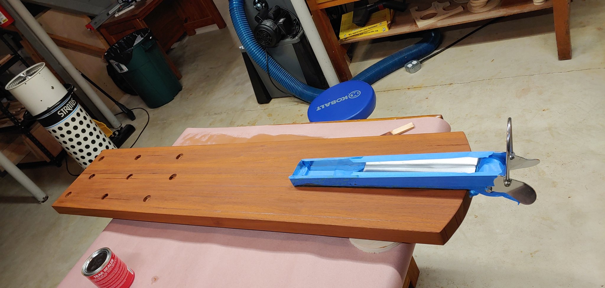

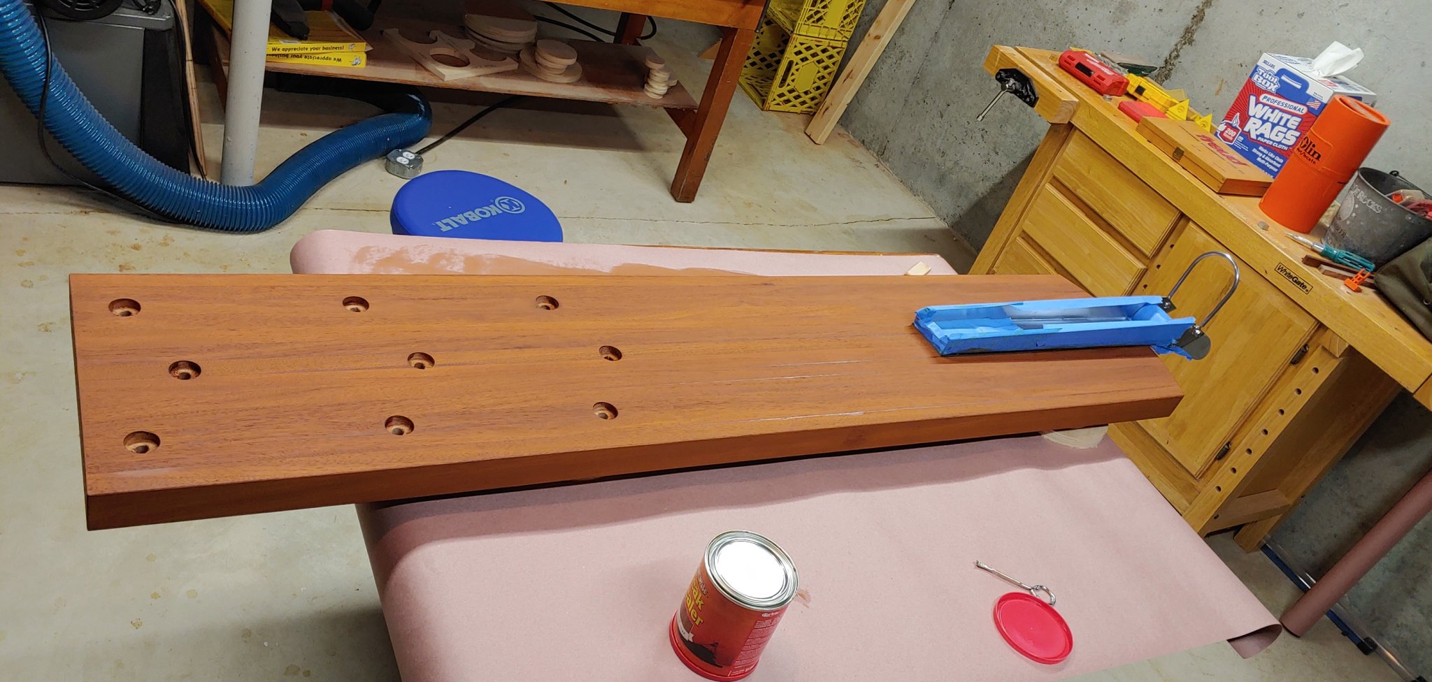

My progress has been slowed a bit by another project. It is not an audio project, but it may have some crossover interest to some people on the forum, considering the fabrication and woodworking aspects.
I am making an anchor pulpit for my boat. It is made from 13 mahogany boards (or strips), 2" x 1" x 72". Each strip was fully encapsulated in epoxy, and then the strips were epoxied together. The resulting beam is 70" long, 2" thick, and 13.5" wide. I cut the circular radius on the end by hand with several different hand saws, then sanded it to the finished arc.
The electric windlass (winch) can pull the anchor chain with up to 1300 lb of force, so this cantilevered beam needs to be rather stout.
