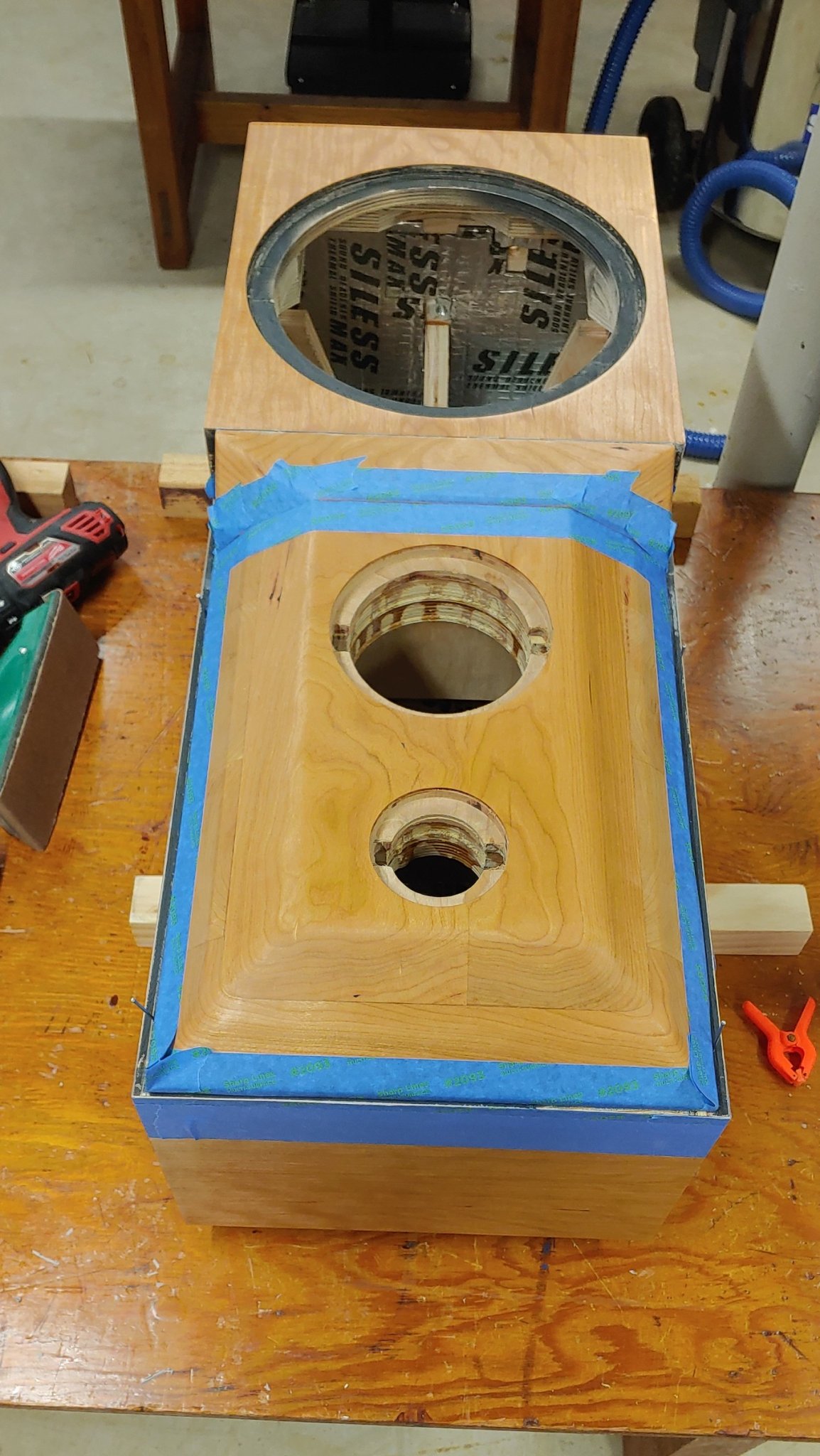

I intentionally cut the M-T baffle 5 mm short on the sides and top. I intend to fill this in with a trim piece later on. It would not be possible for me to machine the M-T baffle to exactly fit the assembled cabinet. I can hand plane the thin strip of wood trim for an exact fit.
I decided to paint the exposed edges black, to see if I would like the look. This had to be done before the veneering. Now that I see it, I don't like it, so I will stick with the original plan of a trim piece.

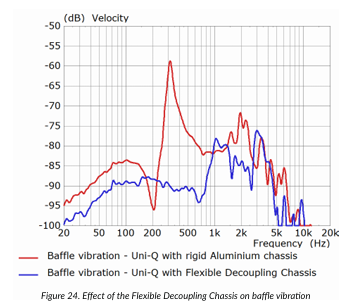

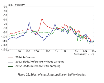

The main conclusion I'd draw from chassis born vibration mitigation and enclosure construction is basically trying to do one of two things - reinforce the enclosure walls to the point of moving the vibrational modes higher up out of the chassis FR, or use thinner panels to lower the modes and apply viscoelastic dampening media to them. Using both thicker panels with extensive reinforcement/bracing and applying surface dampening treatment is the fool proof, expensive way.
Largely, the frustration I have is with the manufacturer data not being consistent with self measured data. The impedance curves are often embellished or smoothed by pretty much all of the driver brands. My findings are that in the critical lower midrange some of the most important driver behavior is being covered up. The spider and surround both contribute to chassis born vibration, but the spider alone is responsible for the majority of vibrational transmission in the critical 250 hz - 1k lower midrange. The spider has the most stored energy issues in this range and much of that bounces back and forth between the cone and chassis to mounting flange.
The other significant cause of vibration from the whole chassis is the counteracting forces from the accelerating and decelerating moving mass. This one isn't so hard to deal with if the chassis is designed properly in regards to stiffness, but a decoupled chassis counteracts this if the driver bandwidth exceeds the reactive decoupling frequency. The enclosure mass will effectively cancel most of the forces if its significant enough and the enclosure itself is well coupled to the ground using spikes or other means of increasing the coupling pressure through a very small surface area exerting concentrated force to the surface it rests on.
The spider is the most influential part of the chassis to deal with. Unless you have some sort of idea where the main resonant chassis modes(s) are based on accurate impedance curves, there isnt much you can do to minimize the spider's stored energy, keeping it out of the enclosure walls.

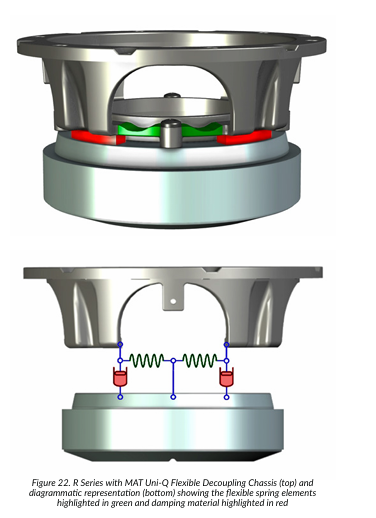

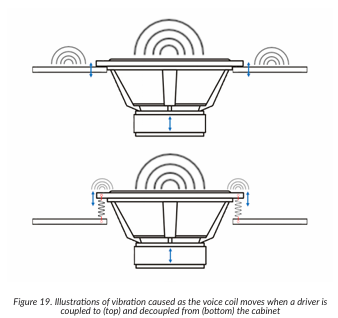

I think one should not underestimate the reaction forces of the driver motor. These are a magnitude bigger than the reaction forces the spider transmits to the chassis. While spider resonances of course are unwanted, the mayhem of baffle vibrations is caused by the magnet trying to move.
This is an interesting approach from KEF minimizing vibrations caused by the magnet force
I had similar experience, the first time I ever tried to measure the impedance of a woofer, years ago - I clamped the driver to a portable workbench and when I measured the impedance, there was a weird double peak at the fundamental resonance. I tightened up the clamps, and suddenly got a nice clean single peak. An early lesson in the interactions between the mechanical and electrical behaviour of drivers. The experience made me wary of compliant mountings - the effect might not always be desirable.I found that when I measured the TSPs of a driver in free air, there were some odd looking peaks in the impedance curve.
Yes, it's just Newton's third law. A woofer motor is incredibly strong, and the full force that is exerted on the voice coil is also exerted directly on the magnet, trying to move it in the opposite direction.I think one should not underestimate the reaction forces of the driver motor

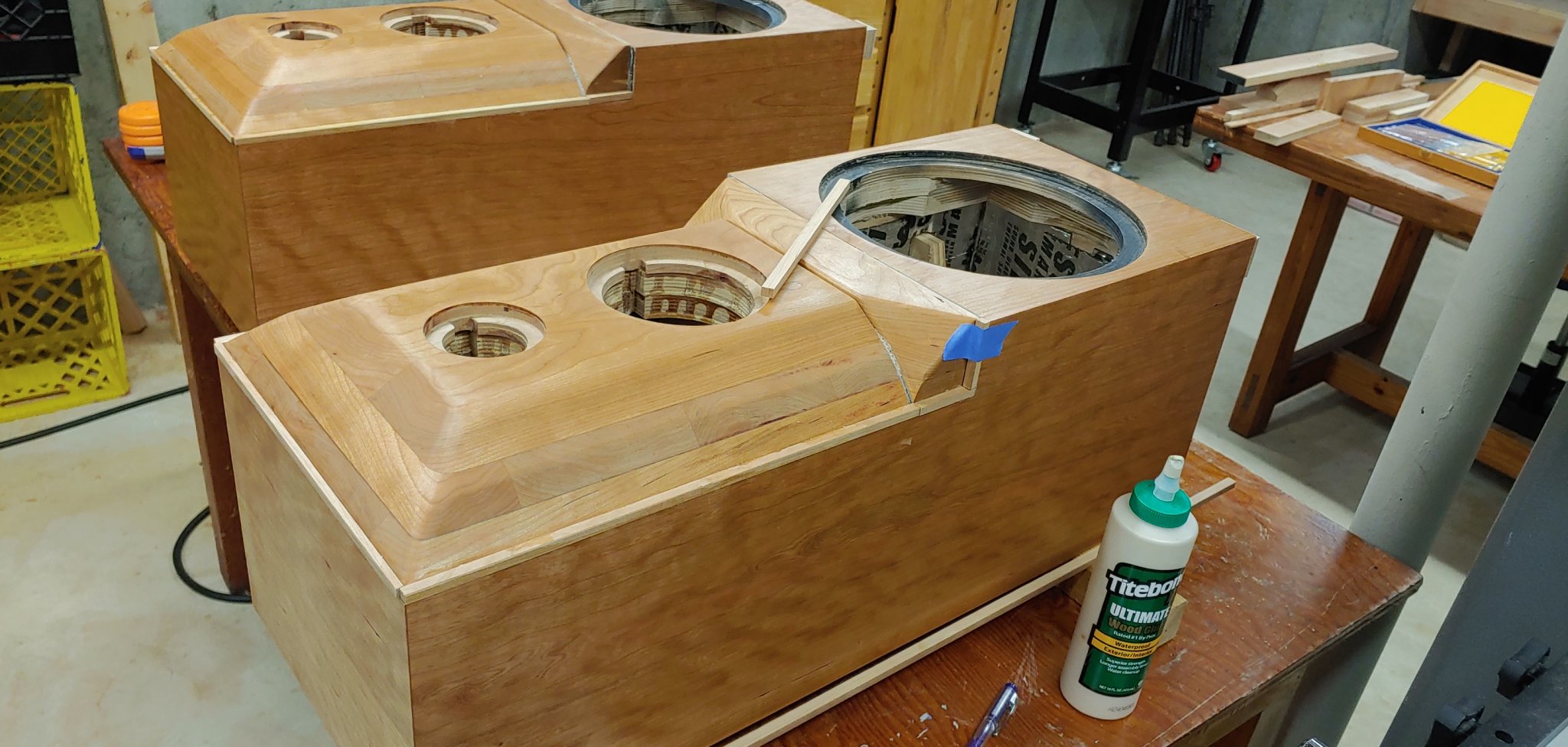

I have made some progress over the last several weeks. I finished all the veneer work and finished profiling and smoothing the Mid-Tweeter baffle and the transition block. I then applied 2 coats of polyurethane varnish to everything. I expected that the next assembly steps would produce a lot of adhesive squeeze-out, and the varnish would protect the raw wood surface from glue stains.
I bonded the transition block first, and after the adhesive cured, I attached the M-T baffle. In this photo, the transition block has been attached, and the M-T baffle is fully taped and ready for adhesive.

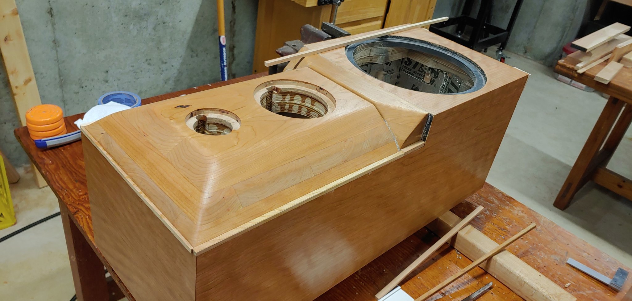

I am now in the process of applying trim pieces to cover the stepped joint where the M-T baffle meets the main cabinet. After all trim is sanded smooth, I will re-sand the entire box, and apply the final finish.
As much as I enjoy the woodworking aspect, I am looking forward to getting the drivers mounted so I can start with the measurements phase...
