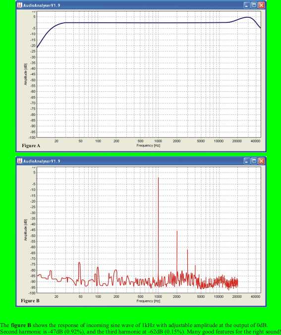

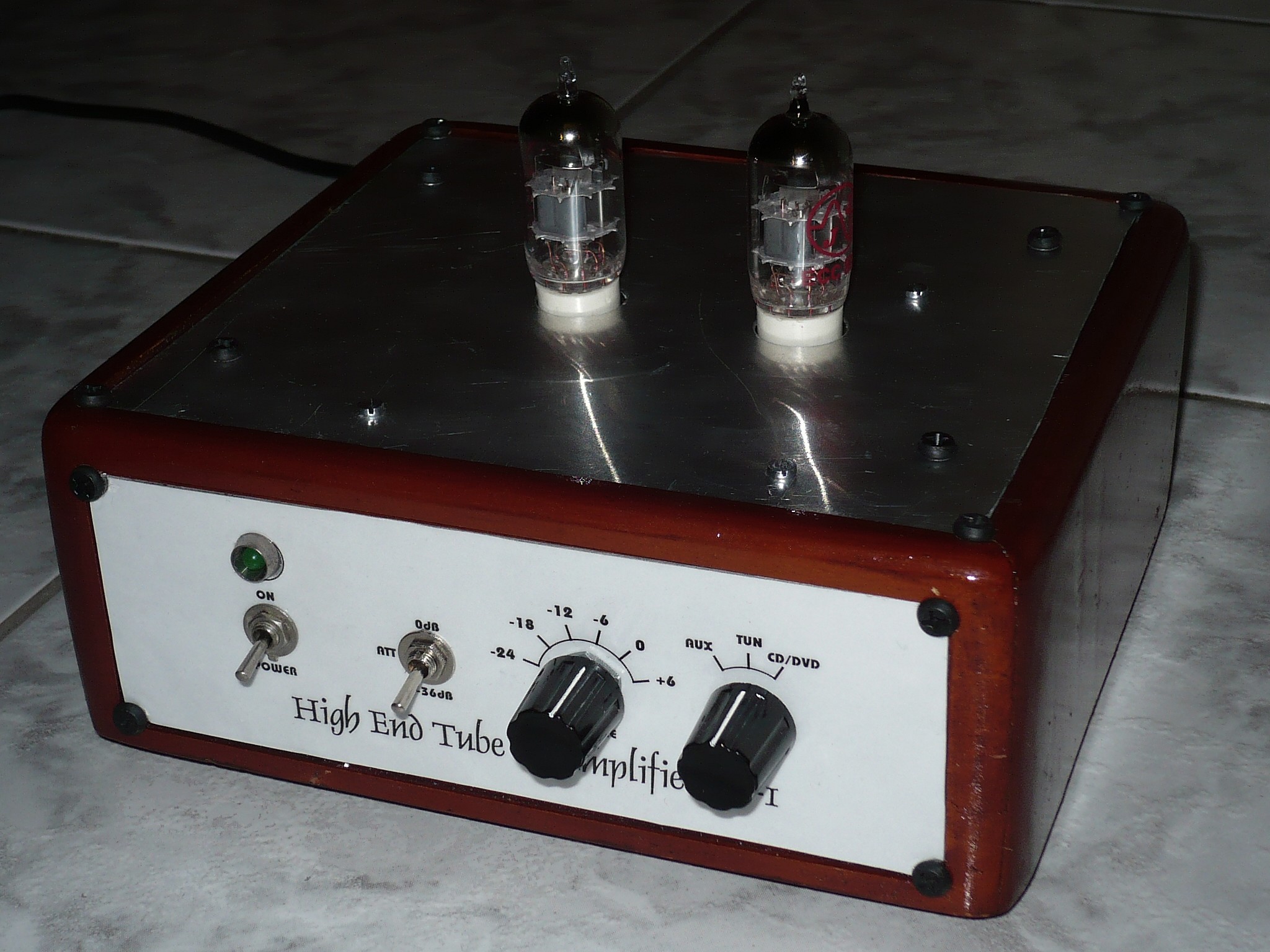

Hello all!
Here is the schedule of preamplifier with Tube-12AX7 (ECC83), here and preamplifier-image, and here's a chart of the measured feature!
The idea was to produce "High-End" preamplifier with Tube/Valve ECC83 which will give the "Valve" sound, which will be enhanced second harmonic (this can be seen from the measured fotograhije-harmonics).
The right to tell you sounds great, and you defined medium and volume, great picture and sound with depth!!!

The figure B (see photos) shows the response of incoming sine wave of 1kHz with adjustable amplitude at the output of 0dB.
Second harmonic is -47dB (0.78%), and the third harmonic at -62dB (0.15%). Very good features for the right tube sound!

Hi Radio,
Any chance of some component values? All we have is it's a 12AX7 with 250V HT!
Thanks!

What do you define as 0dB??
Cheers
ian
Cheers
ian
Set the amplitude at the output of 0dB !!!
Cheers !
Cheers !
Yes, but distortion measurements are only meaningful if we know what the output voltage was.
Cheers
Ian

I thought 3rd 5th and 7th harmonics are good for some realistic bite in the sound? I suspect this will sound way too syrupy with 2nd harmonics dominating.
Any auditioning reports?
