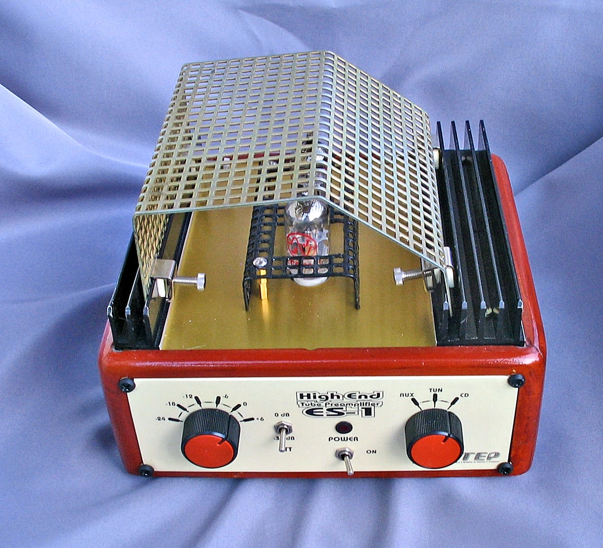

I have just finished my ECC82 preamp. Have been testing it, changing tubes, listening. I am very satisfied with the sound.I used "cheap" plastic capacitors on the output, so during this weekend I am going to change them with some more exotic one. The pre is more like a prototype, and I will use it as an "testbench", while I will build me a new one?

Stenak, nice that you've made this preamplifier with ECC82 (12UX7)!I have just finished my ECC82 preamp. Have been testing it, changing tubes, listening. I am very satisfied with the sound.I used "cheap" plastic capacitors on the output, so during this weekend I am going to change them with some more exotic one. The pre is more like a prototype, and I will use it as an "testbench", while I will build me a new one?

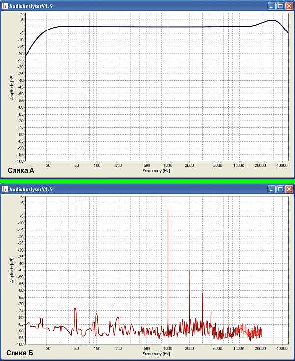

Here's the picture here shows the High-End preamplifier with ECC83, which I did.
Measurements are given below. Second harmonic is -47dB (0.76%), and the third is only -62dB ( 0.15%).
Here is the data and characteristics frekvensiska preamp, ... is it true High-End preamplifier with ECC83.

With this filter Frequency response characteristics is obtained as shown in Figure A (6dB at 30kHz! with filter R12, C3).

You can achieve the same thing using an equaliser. I think that an high-end preamp wouldnt need such a filter.
As a high-frequency attenuation in cables and the knobs for volume (for output). If you want to get the flat frequency response remuve the capacitor C3 and almost !?
