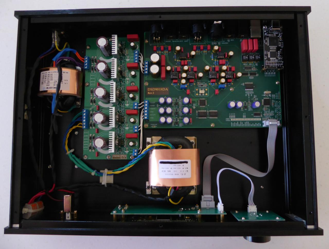

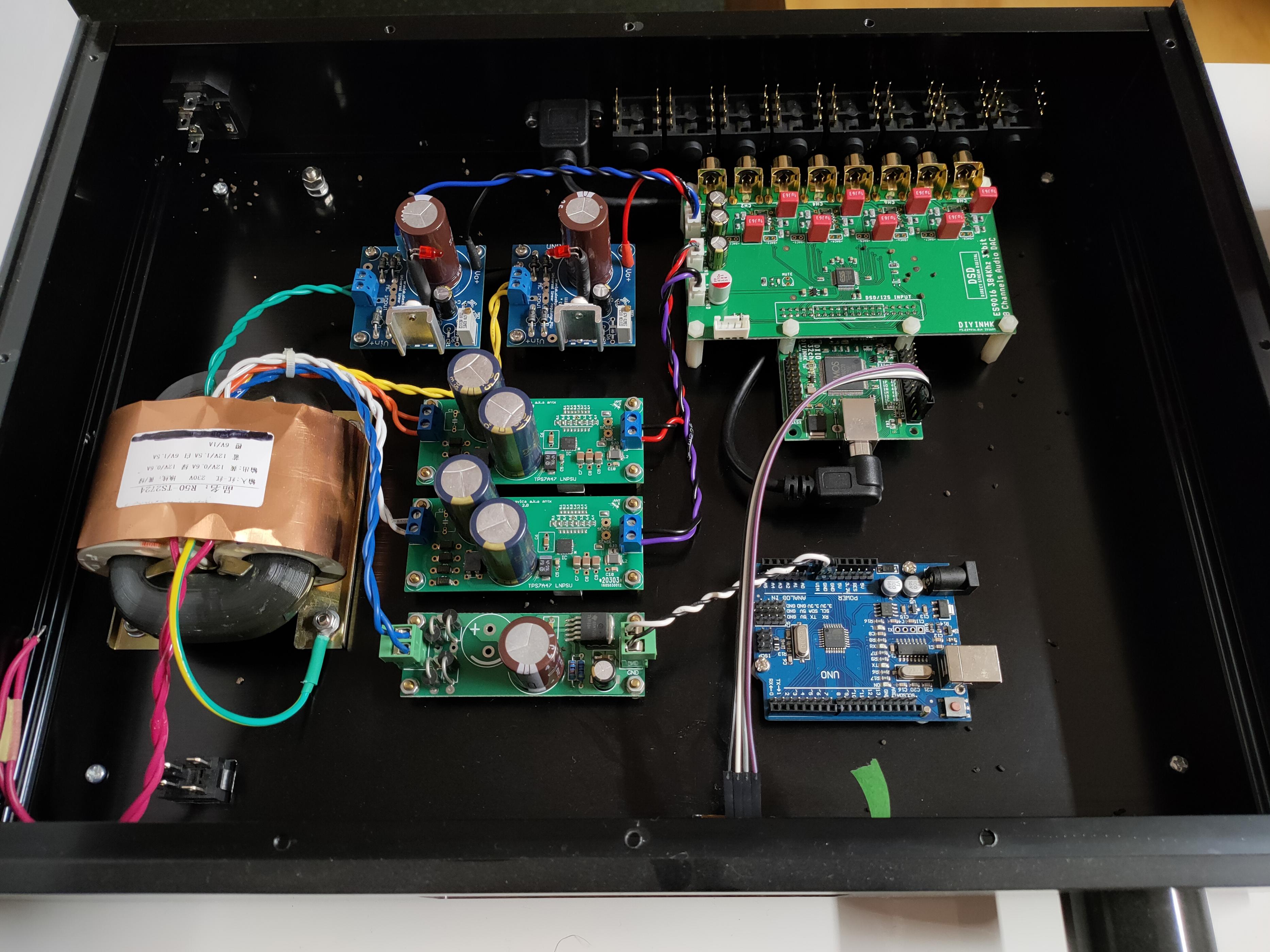

As an alternative as this is diyaudio and not buy it from a shop audio I have got a diyinhk ES9016 8 channel DAC that I have nearly finished but got mothballed. This has the tweakiest power supply collection I have ever made and I swapped the opamps for SMD Analog Devices ones, the DAC itself sounds pretty good and dissapointingly similar to my ES9018 that I tricked out with a fancy Crystek clock and other stuff. But of all the DAC's I own or have built I listen to the Topping D50 as I like it the most 🙄
