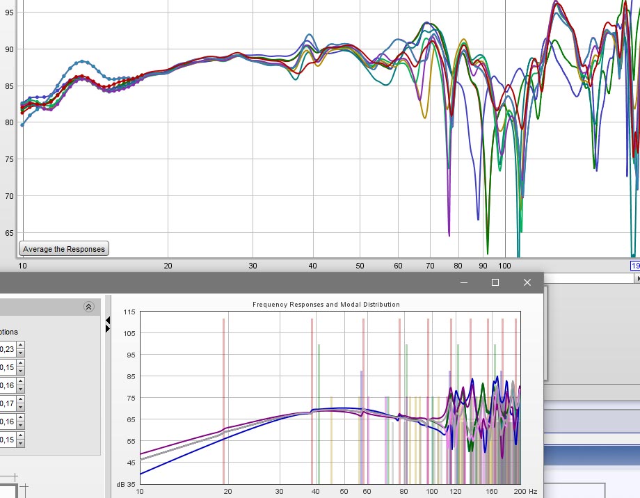

*Double Bass or SBA (with absorber) will give the most even bass if your room is suitable, I'm a big fan of thinking of the room and speakers as a total system and trying to use room boundaries.
I'm a big fan of listening 😀 of the room and speakers as a total system and using room boundaries.
Phobic's room seems *BA compatible in general, but *BA performance may be affected by room irregularities, primarily in upper range of *BA. Accordingly, the speakers must have a suitable low frequency capabilities.
For example, my current 9*4.2*3 m room, with a lot 😀 of doors and windows everywhere, DBA 2+2 real (no cross, no smoothing, NO EQ) and theoretical:
Not sure if there's any latitude with DBA to mount the subs nearer to the sideways than the ideal?
If so - second width mode will start to appear. In 3.3 m room you can get good results up to ~80 Hz.
REW RoomSim is very simple tool to see it.

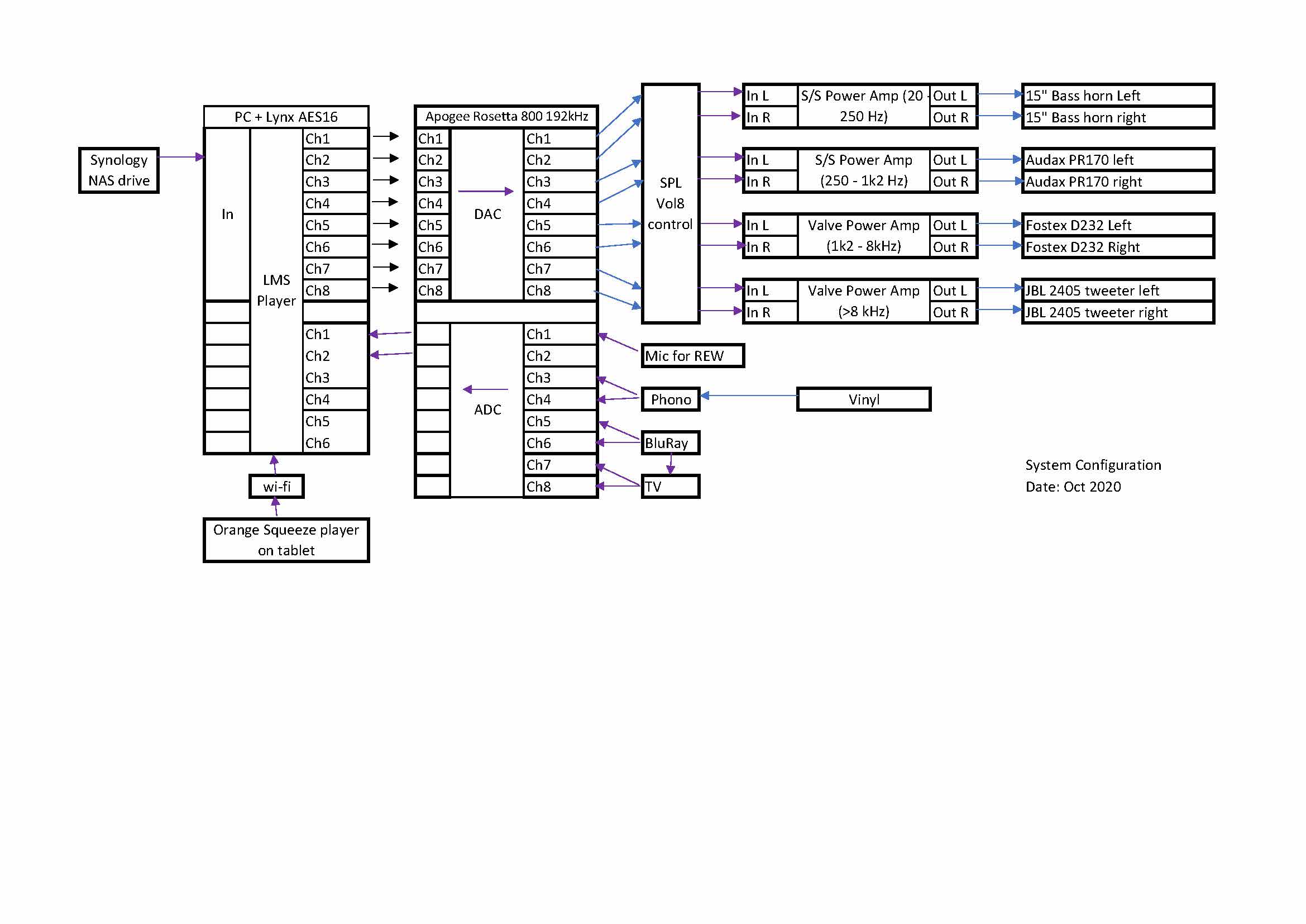

I started down a similar path several years ago, and yes, it is taking me years and have been learning a ton and having fun along the way.
Not sure why you are considering a computer as a low quality source. A dedicated, "audiophile" optimized computer can be pretty amazing and reliable. It's just another box on the rack, no screen, using the Roon phone app to manage playback. Using a computer and a "soundcard", as was mentioned before, in my book is a really powerful, high performance and cost effective solution. Mind you, soundcard does not necessarily mean a card you insert into your computer. Professional multichannel DAC/ADC units are commonly referred to as soundcards, but they are stand alone boxes and some are quite refined from an audio standpoint. Since you have a nice budget, check out Merging Technologies Hapi with ADA8P card, as an example.
The central concept is a multichannel ADC/DAC connected to a computer that runs a software to derive convolution filters, and amps connected to the analog outputs from the DAC. I use Acourate software, which is sophisticated and super flexible, at the cost of steep learning curve. You can do as simple as 2-channel digital room correction, all the way to active 5-way with digital crossovers, time aligned, room corrected filters. And of course you need a measurement mic, which is why you need the ADC capability. Modern software volume controls are pretty good - a non-issue these days.
FWIW, my learning journey: started with 3-way towers (B&W 804S) plus two subs with analog xo (also tried the 3-ways full range and overlapping with subs). To test the water, I purchased a Lynx Hilo DAC/ADC and implemented active xo between subs and mains, learned to measure and create filters, play music with them, etc. Then purchased a couple Hypex amps, removed the woofer passive xo and replaced with active (now an active 3-way, where the mids-to-treble was still passive), and so forth. Used the manufacturers xo points and slopes initially to reduce the number of variables. Then went into DIY speakers...a rollercoaster! Currently running active 4-ways, experimenting with dipoles.
The computer never failed. The nice CD player and Lamm pre were sold, never looked back. While my speaker is not final, my current expectation is that I will in fact achieve much better sound than I started with, at a lower system cost. As I'm ignorant on passive crossover design, it saved me a huge learning curve there, and fully active systems allow for use of a wider range of amps for mids and treble if you so desire.
I hope you explore it and decide if it's good for your needs/preferences. I don't think it's a matter of audio quality, but rather the pros and cons of each approach. You can get a used multichannel ADC/DAC and try out for little to no loss if you decide it's not for you and sell it.

FWIW, my chain is similar: a general purpose PC runs Roon Core where I upsample to 176 or 192 and convolve the filters derived on Acourate. Roon outputs 8-channels (stereo) thru ethernet to an "audiophile" PC running Roon Bridge on WS2019 with Audiophile Optimizer that outputs 8 channels thru USB into an UpTone ISO Regen and into the Lynx Hilo.
Before Roon could do convolution I used to output Roon thru ethernet into HQPlayer in the audiophile PC where convolution took place and multichannel was sent thru USB to the Hilo.
FWIW, my audiophile PC is not so powerful by today's stds: 7 years old Xeon 1256v3 processor on an Intel 1200 server motherboard, 8GB RAM, headless. All very reliable. Of course linear power supplies, no fans, no HDD, no motors of any type, etc. Acourate is installed in this machine for measurement and filter creation. Running 192kHz/24bit material in 8 channel the CPU load is under 10%. Cruising. DSD is more demanding, of course.
Roon has been very reliable on convolution and streaming to the audioPC, so I simplified and took HQPlayer out since my DAC can't take advantage of it. If/when I move to Hapi with native DSD capability...that might change. BTW, Hapi is a ethernet attached device, so you don't need an audiophile PC to feed it through USB, which ends up streamlining the system and potentially lowering overall investment.
