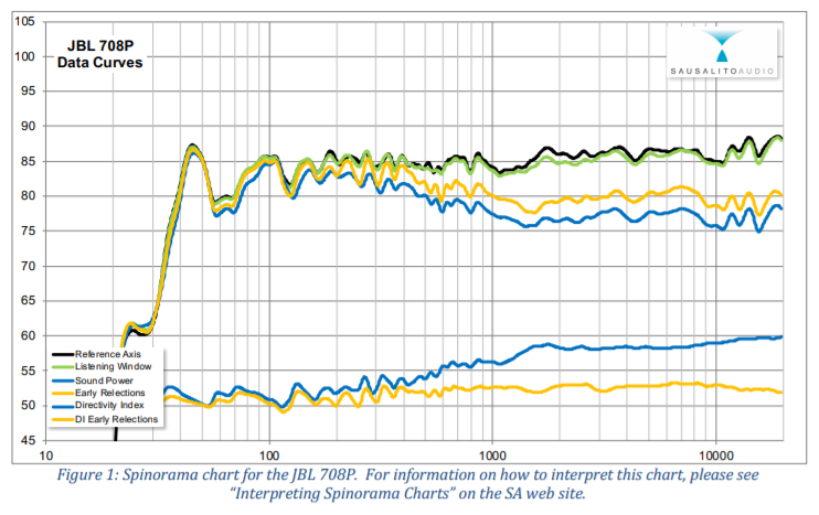

Here is the spin of the 708P, it is good but not the best that can be done. It is very reminiscent of the entire LSR line. Rising on axis and listening window, which combined with a fairly flat DI means it will sound bright. This will not sound neutral out of the box. Beyond that a lot more information needs to be considered and 'better' is too vague a term to decide what to prioritize.
The directivity and frequency response are designed to work with the onboard processing. It's a feature not a bug.
That is the glass half full way of looking at it.
As it comes out of the box it does not meet Harman's version of neutral, but it has onboard EQ that can fix it, so it can be made to be neutral. Why they didn't use the processing to fix the response when they already have comprehensive anechoic data is a mystery.
The little LSR is the same, all boom and tizz as set from factory, flick a couple of switches and it sounds much better. Perhaps boom and tizz sells speakers in a showroom.
Anyway anyone can make their own mind up from looking at the spin.
