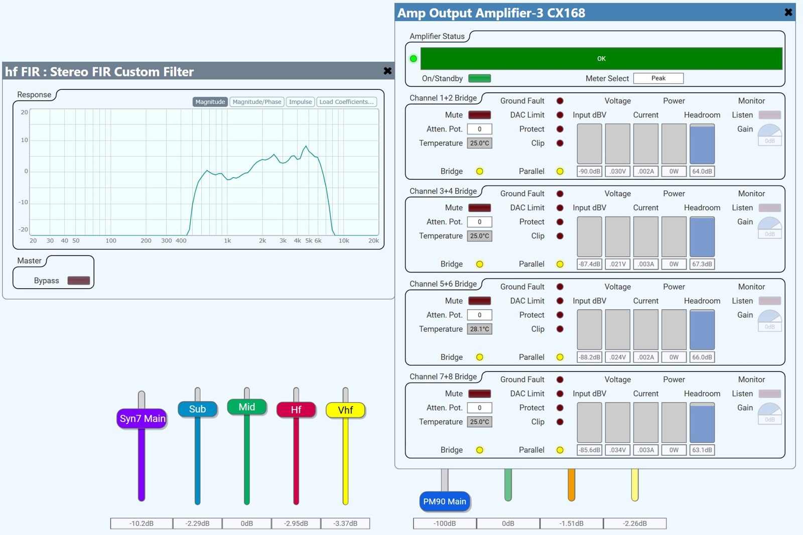

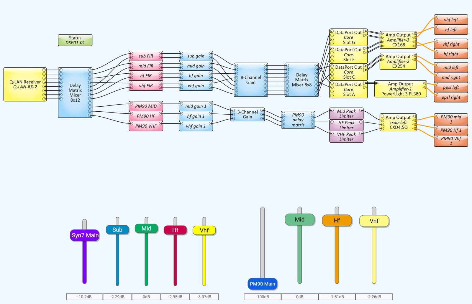

If you enjoy endless tweaking and experimenting, by far the easiest, most flexible, and most powerful high quality DSP solution I've found is the Q-Sys Core 110f.
It's an open architecture DSP, so you build what you need like in the diagram below I'm currently running for some 4-ways.
Every block in the schematic opens up for realtime adjustment or observation, like in second snip showing a FIR filter block and an amplifier block.
It allows instantaneous changes between even completely different processing designs...say for instance, comparing the exact same filter sets of EQ's and xovers, implemented IIR versus FIR.
Best way to see if interested is take the online Q-Sys Designer tutorials.
If so, Core110f's go used on ebay for around $1250. There's always some priced way higher, but they're just there to pick off a sucker. Used are very robust, I'd have no worries from a reputable seller.
the Q-sys looks amazing, very powerful, just what I had in mind.
